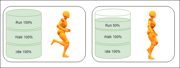

Blending of the animation mixer works as follows: It is like the last animation is on top of the stack and always blends over all others. So if you have an idle, walk and run animation, the highest weighting has the run animation. As long as it has an amount of 100%, no other slice is shown. If it has any other value it will be blended with exactly that weighting and all slices beneath it will have to share the remaining percentage. This procedure goes on until the first animation mixer is blended onto the base slice of the Animation Rig Node.
The visual shows the weighting of 3 animations. On the left the Run Animation overrides 100% of all other animations in the stack. On the right the Run Animation blends 50% over the Walk Animation while the Idle Animation is overridden 100% by the Walk Animation. The Animation Mixer looks like the following:
