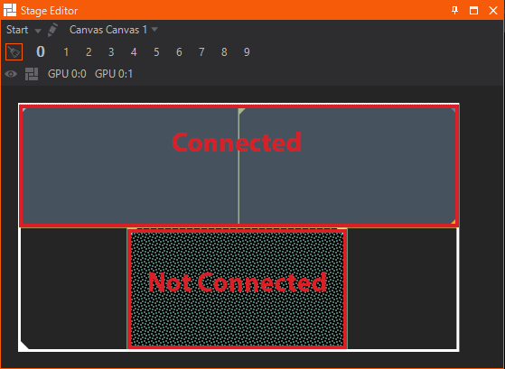

To use multiple Composition Layers, a Render Setup is needed so they will be correctly mapped on the physical outputs. You also have to make sure the Render Setup is activated, you can also check this by opening the Stage Editor. In the Stage Editor, the active configuration is shown. Compositions that are not connected correctly are indicated by the noise pattern on it.

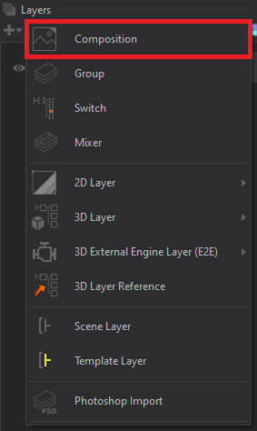

To insert a new Composition Layer use the Add New button inside of the Layer tab, and select "Composition":

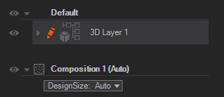

After inserting a Composition Layer you will see the Default Composition and the newly inserted Composition.
Again the noise pattern is indicating a not connected Composition.  click on the small square to select the Composition needed.

Setting Description
AutoUses the given size from the Render Setup or Previs Canvas Node
ManualChanges to the given resolution and places the Composition onto the Canvas on the 0,0 position
Default Composition Layer
When starting a new Scene, there is already a "Default Composition" that is hidden in the Layer Editor. When creating a second Composition, you will see your new Composition in the list as well as the Default Composition.
The Default one is automatically linked, or connected, inside of the Render Setup to automatically enable a basic Render Setup. You cannot delete or rename the Default Composition Layer Editor. It can be safely ignored should you only use custom Compositions.
