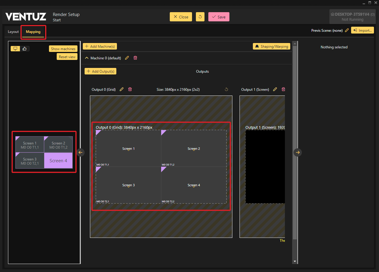

In the Mapping window of the Render Setup Editor, Outputs can be created and modified. An output is what is used to address as Video Output in the Device Config. Inside of the Mapping section, multiple screens and machines can exist on which to apply these Screens.
Screens can be applied to the Outputs in different modes.
  • The basic mapping is a Single mapping of a whole Screen to an output.
  • But with Grid and
  • Manual mapping very complex output mappings are possible.
In general, the pipeline to render to a physical display from Ventuz is: Composition -> Screen -> Output.

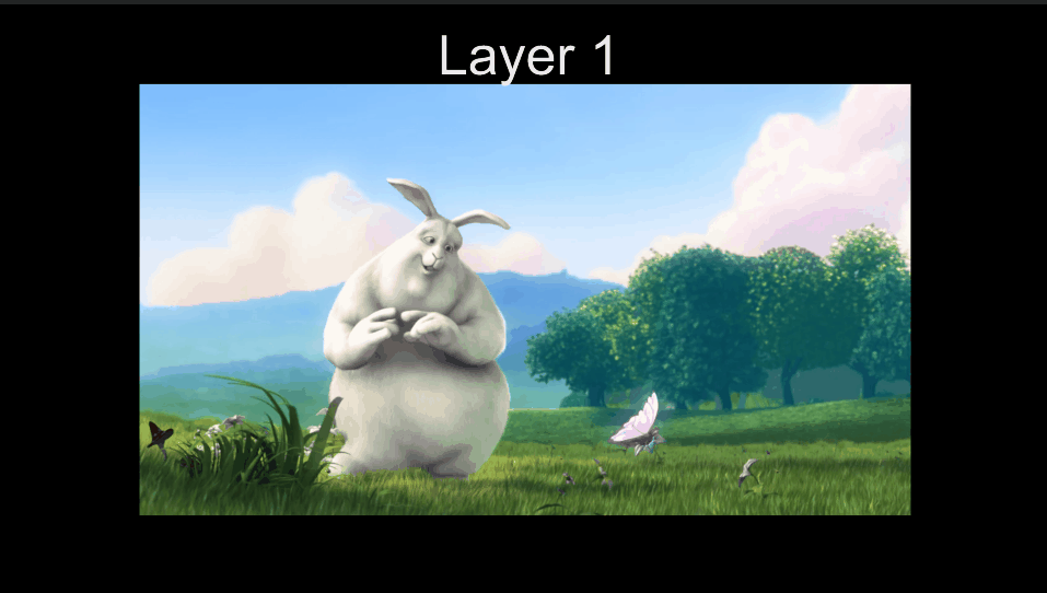

When starting a Project and creating a Scene, Ventuz Designer automatically makes a Default Composition with a 3D Layer inside of it. This is the most common type of setup for starting a project.
Modifications can be made to various assets such as 3D objects, text, particles, as with any other scene in Ventuz. These assets can be positioned and animated in the workspace that is the Composition.

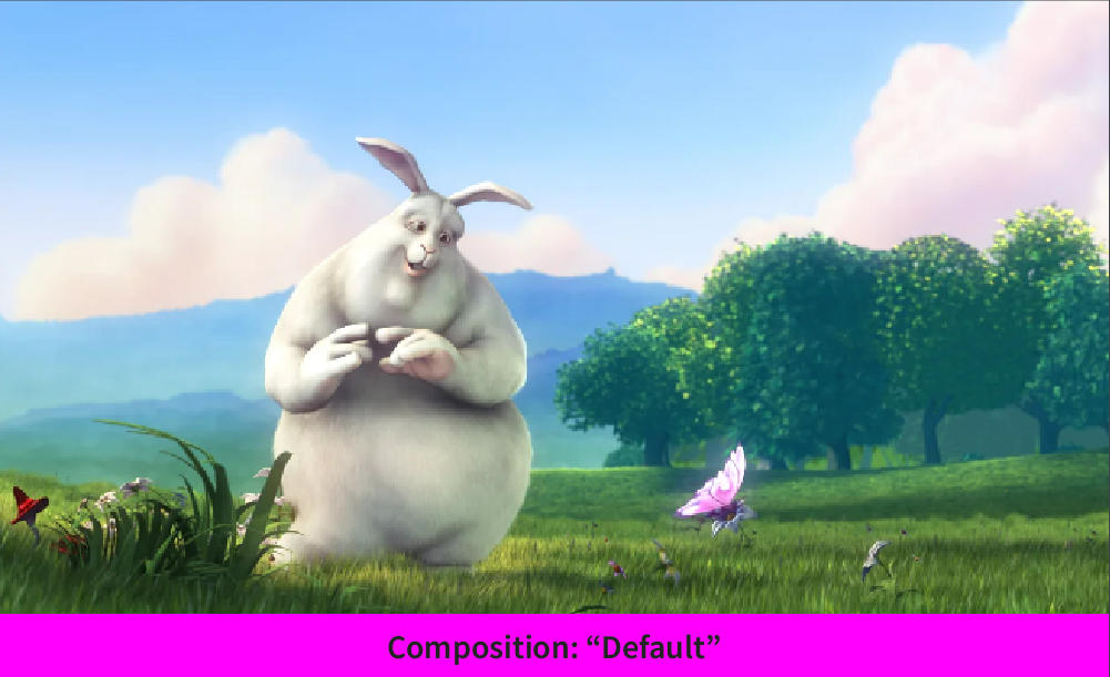

Once the Scene has been created in a way that is ready to present a Render Setup can be made. Inside of the Render Setup it is then possible to render an entire Composition to an Output or display, to scale that Composition, to take cuts or sections of that Composition, or to send one Composition to multiple Outputs. To accomplish this, the use of Screens and unique Output mapping is used.

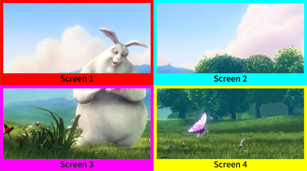

In this example:
  • One Layer is applied to a Composition.
  • One Screen (Screen 1) is used to 'capture' the whole Composition.
  • Screen 1 is applied to an Output that is connected to a physical display.

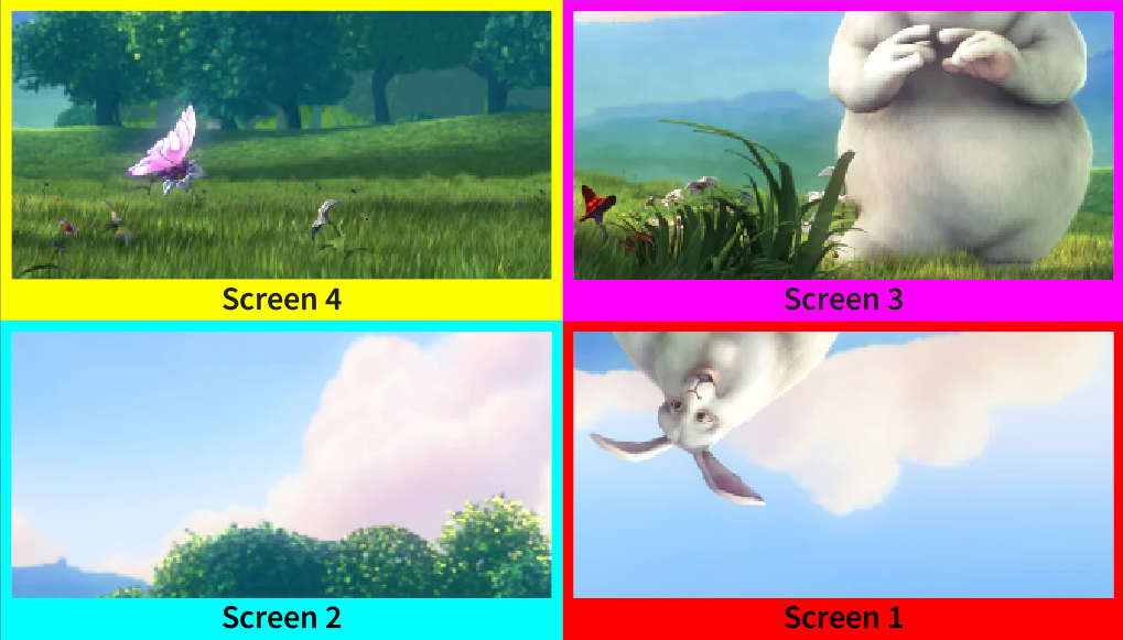

  • Screen 1 is resized and moved to 'capture' a smaller section of the Composition.
  • Three additional Screens are added and are positioned to 'capture' a 2x2 Grid.
  • The four Screens have all been applied to four Outputs.

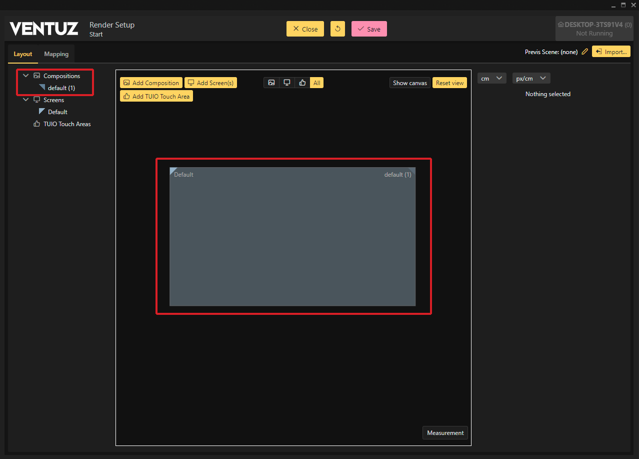

Compositions
A Composition, inside of Ventuz, is where all of the magic happens. A composition is where the Layer assets are rendered; it defines the area to pass to the graphics card(s) or to Previsualization Screen(s).
Each composition in Ventuz can be a unique area that can 'hold' one or more Layers. One or more Compositions can be used in each scene. A Composition can be virtually any size, regardless of what the output sizes are, or are expected to be. Compositions allow Ventuz Scenes to be dynamic and allow them to be used for many different setups using the same Project File. By resizing a Composition, different Layers are able to utilize more or less pixel space without losing resolution.
Because Ventuz elements are rasterized and rendered inside of Ventuz in real-time, the size of the Composition does not matter, with the exception of videos or images that are created outside of Ventuz and imported into the Project.

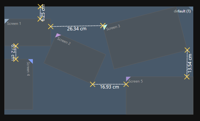

Measured Screen Sizing Tools
Screens can be added and their measured physical size, pixel density or resolution can be used easily and automatically to size them. This assists in setting up different types and sizes of screen to create one large canvas to create one beautiful image.
For more detailed information about the Measurement feature take a look here.

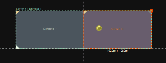

In most scenarios, working with a Render Setup, the handling of Canvases is automatic. Canvases are a technically necessary tool for the Ventuz rendering path and the engine, since they act as middle step in the transformation chain between the layout of Compositions to Screens. To be able to layout multiple Compositions to one Screen, or even more complex setups, Ventuz has the intermediate step of Canvases. While working with the Render Setup, the creation and editing of Canvasses is done automatically. With creating Compositions and Screens the Canvasses are always edited correctly in the background. With multiple Compositions being connected, by overlapping or touching, one continuous Canvas is created, like you can see in the animation.
In this animation, when one Composition and Screen are moved away from the other, the Single Canvas will become two. It will automatically merge back into one when it is appropriate.

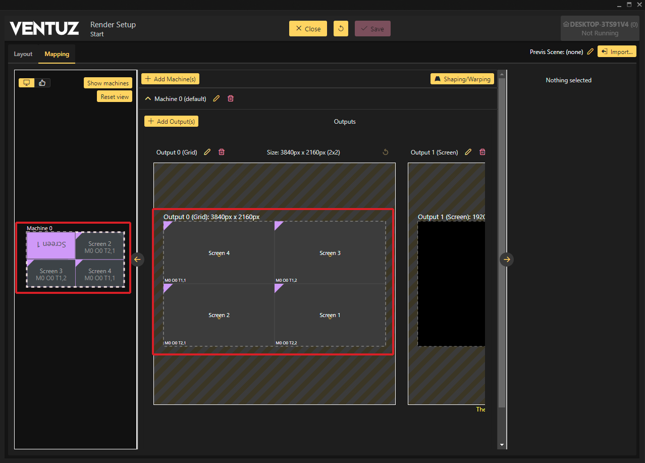

Inside of an Output a Screen that has been setup above can be assigned to display on. This way, the slices of the composition taken by creating and adjusting the Screens can be assigned to a physical output of the Ventuz environment.

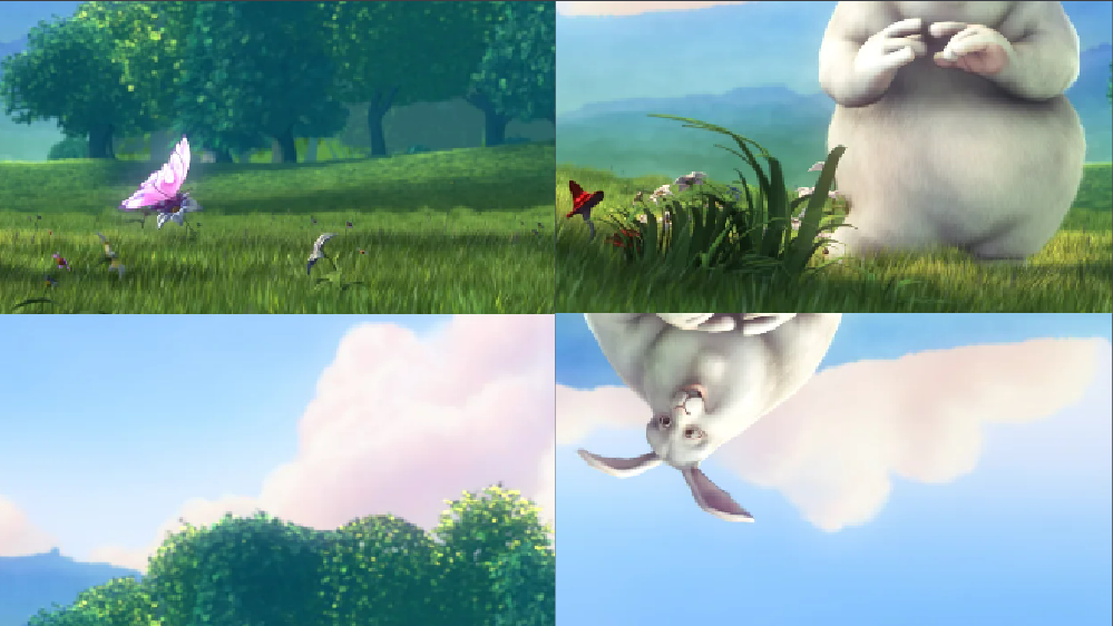

Inside of each of the outputs, Screens can be adjusted to rotate, scale, and position a Screen to display on an output. This Cut can then be positioned with precise pixel-level accuracy on a physical Output to display a portion of a Composition on a custom size or shape LED wall for example.

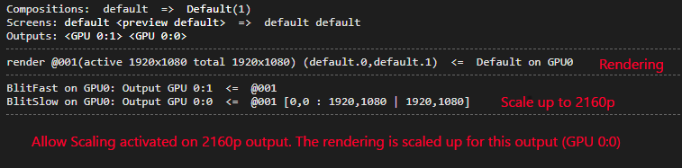

Now the Allow Scaling function is enabled for the 2160p output. The rendering in 1920x1080 is scaled up for the GPU out.

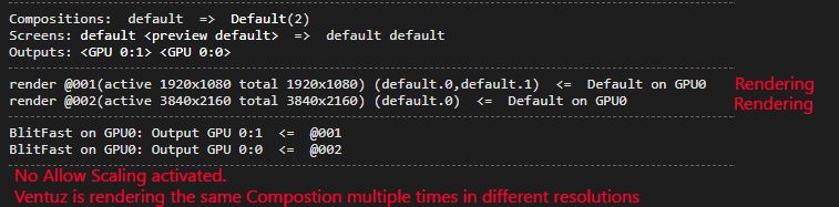

In this case, there is no scaling enabled. Therefore Ventuz is rendering the same content twice in different resolutions.

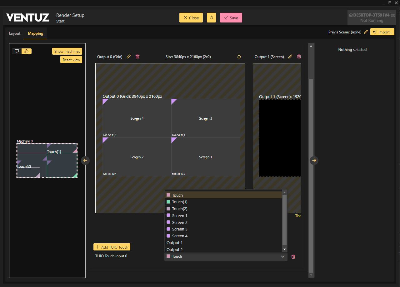

TUIO

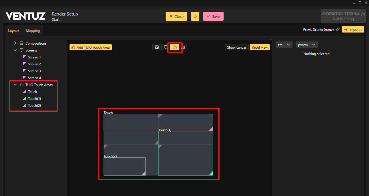

Map TUIO exactly as needed to across multiple displays letting Ventuz do the work to accurately track input information. Touch areas can be assigned manually by using the touch areas:
Or by directly mapping TUIO touch inputs to a output in the Mapping Mode
Here you can choose between the whole output or single Screens.

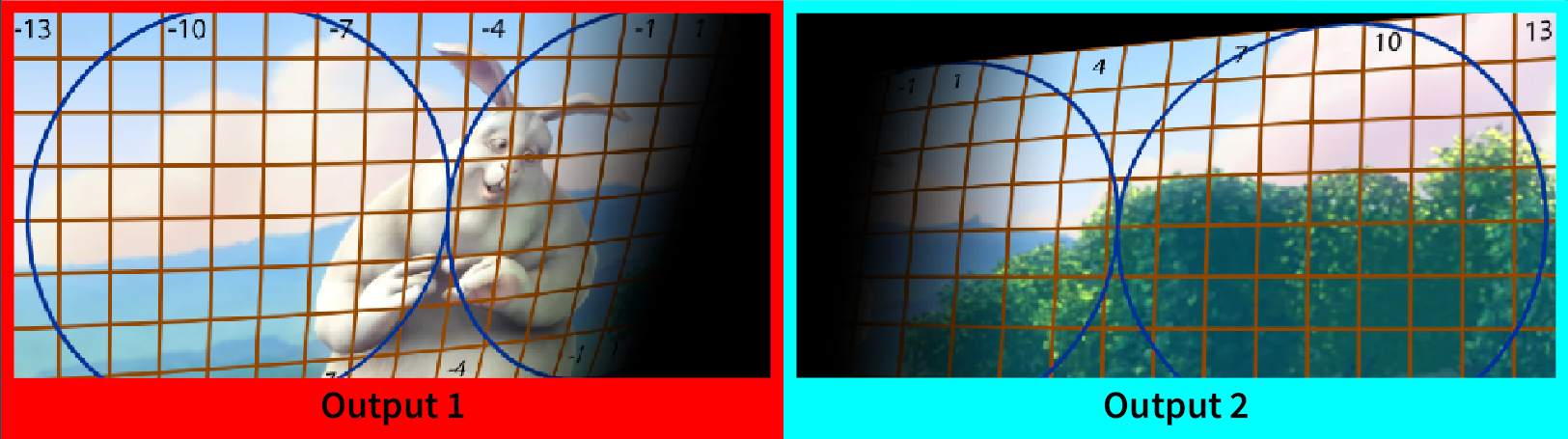

Shaping
Warping
Similar to Version 6, the Warping Engine allows granular control of every pixel for every output.
Inside of the Shaping Editor, each screen can be aligned individually to create edge blends, convergences or to assist in mapping an output to an object.
Blending
Blending is done automatically if there are any overlapping Screens. Adjusting the automatic blending can be done in the Blending section of the Shaping Editor
