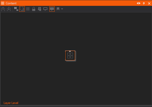

We will start up with a one single node located in the Content Editor on the Layer Level in your scene:

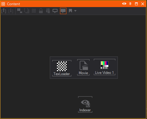

Double click  the small gray triangle in the Content Node. You should now see a blank Content Editor and an empty Hierarchy Editor. Firstly you will need to create four Nodes:
  • A Texture Loader to load Images and Textures
  • A Movie Clip Node to load movies
  • A Live Video Node to display Live Video inputs
  • A Visual Indexer Node to interpret incoming URI's
The result should look similiar to this:

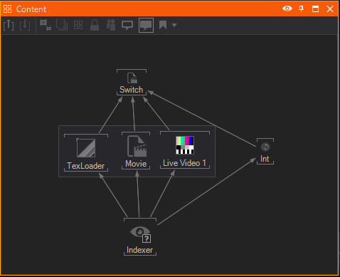

The Visual Indexer node has two Input Properties. Firstly the Uri, which defines the path of the file one wants to inspect and secondly a TreatTextureAsImage boolean which prevents the node from handling texture files differently from image files. Since the Texture Loader can also handle image files, we check this property and hence ignore the Texture outputs of this node.
Now you can bind the File property of the TexLoader node to the ImagesUri output of the Visuals Indexer. Drag  the File property onto the Visuals Indexer node and choose the ImagesUri output in the dropdown list.You can now bind the File property of the Movie Loader node to the MoviesUri output of the Visuals Indexer node. Repeat this for the Live Video node and also bind the Ordinal Property.
Now each of the three nodes load the right type of file. That is due to the Visuals Indexer, which inspects the file specified in its Uri input and passes it to that output corresponding to the file type.
Because we want to design our container in the way that we can input an uri and get the corresponding Texture on the output of the container we need to find a way to switch the Texture Properties based on the incoming uri. To do so we use a Value Switch and connect all the Texture ouputs to the Value Switch. To switch the Case property based on the !XXXInvalidUri output of the VisualIndexer we can simply use an Int Expression, create three BOOLEAN inputs via the Custom Model and connect them. The respective expression can look like the following based on the naming of your inputs.
!ImageInvalid ? 0: !MovieInvalid?1: !LiveInvalid?2:-1
Lastly all you need to do is expose the Uriproperty of the Visuals Indexer and the output of the Value Switch so that one can choose a file from outside the Content Container and get the respective Texture. To achieve this you need to click  the little square left to the property. If you want to rename it for better recognition outside the container double click  and change the properties as you like it.
