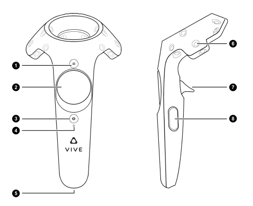

Tracked Vive Controller
The Tracked Vive Controller Node provides the tracking information and button presses of the connected ​Vive Controller. In the Device section you can change the Id to get information from one of the three supported controllers.
1 Menu button
2 Trackpad
3 System button
4 Status light
5 Micro-USB port
6 Tracking sensor
7 Trigger
8 Grip button
The Tracked Vive Controller Node is designed to be used in conjunction with our Touch System and therefore all of our Interaction Nodes can be used with it except the Touch Ripple node since it is designed for 2D Touch only.
To modify the behavior we provide a couple of options at the Node (see below). Additionally you can pass a haptic feedback with the Vibration method using the given Vibration Strength.

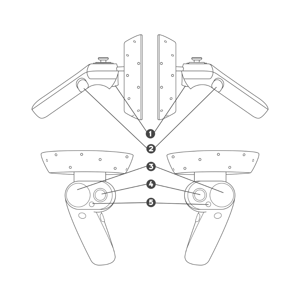

Tracked Odyssey Controller
An ​Odyssey Controller is handled by the Tracked Vive Controller Node as well. In the Device section you can change the Id to get information from one of the three supported controllers.
1 Trigger
2 Grip
3 Trackpad
4 Joystick
5 Button
The Windows Button is reserved by the Mixed Reality for Windows software.
Currently the Joystick is not supported by Ventuz due to the handling of Windows Mixed Reality Controllers by the OpenVR library.

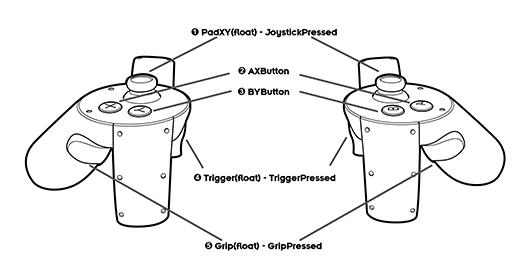

Tracked Oculus Controller
The Tracked Oculus Controller Node provides the tracking information and button presses of the connected ​Oculus Controller. In the Device section you can change the Id to get information from one of the three supported controllers.
1 Pad XY Joystick
2 A/X Button
3 B/Y Button
4 Trigger
5 Grip
The Tracked Oculus Controller Node is also designed to be used in conjunction with our Touch System and therefore all of our Interaction Nodes can be used with it except the Touch Ripple node since it is designed for 2D Touch only.
To modify the behavior we provide a couple of options at the Node (See below).

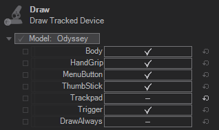

Draw Tracked Device
Even though the Tracked Device itself provides a simple mesh of the different devices, in most cases this is not enough. Therefore, you can use the Draw Tracked Device Node behind a Tracked Device to have access to more options to influence the device's appearance. The type of the drawn device can be changed with the Model property group.

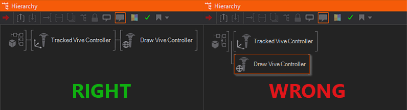

A Draw Tracked Device Node always has to be behind a Tracked Device Node!
Whenever a Draw Node is used switch off the Draw Property on the Tracked Device. Otherwise the mesh is drawn twice.

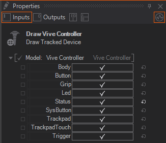

Draw Vive Controller
The Draw Vive Controller Node provides all subsets of the Vive Controller.
Therefore you can use multiple Controller Nodes with different subsets enabled/disabled to apply different Materials to the different parts of the mesh.
Draw Odyssey Controller
The Draw Odyssey Controller Node provides all subsets of the Odyssey Controller.

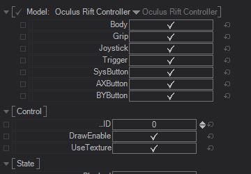

Draw Oculus Controller
The Draw Oculus Controller Node provides all subsets of the Oculus Controller.
