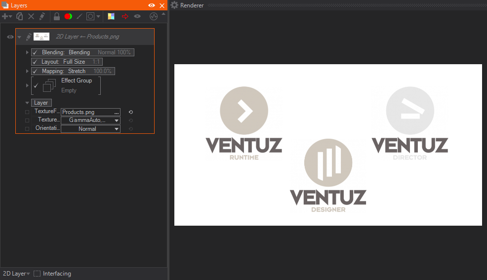

When working with movies and images the simplest way to get them on screen is to use 2D Layers. All of this work is performed in the Layer Editor. If you do not need to perform 3D transformations or use the image or movie in a 3D context (e.g. occlude them with a 3D object) this is a good way to go.
You can add an Image or Movie Layer by clicking the icon on the top left of the Layer Editor. Alternatively, you can open the Toolbox (Shift +  F6) and drag and drop an Image or Movie Layer Node into the Layer Editor.
To make things even easier, you can drag and drop image and movie files directly into the Layer Editor from Windows Explorer.
You can easily change which file to load by  double-clicking the thumbnail for the Layer in the Layer Editor.
When using a 2D layer to render images and videos you have available all the regular 2D Layer controls: Blending, Layout, Mapping, and Effects. Please refer to the 2D Workflow Page for a more detailed explaination on how 2D Layers work in Ventuz.
Opacity settings for the layer can found by clicking the small triangle to expose the Blending properties.

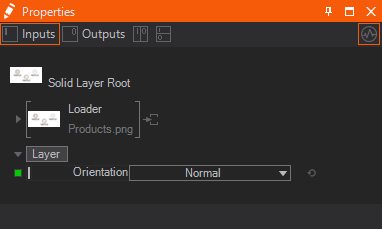

For a 2D Layer, select the layer you would like to manipulate by clicking pencil next to the layer name in the Layer Editor. Next, select the Layer Root Node in the Content Editor to manipulate the loaded image.
Layers cannot be edited when using the Design Layout. Switching to any other Layout will expose the Layer Editor, where you click the pencil icon on the left of the layer you would like to edit.

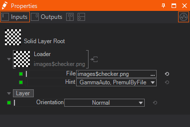

 Click the icon or  right-click the Loader Property Group to expose its properties. Here you can change the File property and change some Hint flags that tell the loader how to interpret the image.
For more information regarding the Image Loader and Texture Loader Nodes, please visit the Image Loader and Texture Loader reference pages. For information regarding the Hint flags please refer to the Texture Loader reference page.

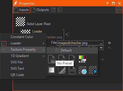

The Texture Loader Node is located in the Texture category of the Toolbox. Placing this node in the Content Editor enables you to bind its Texture output property to any rendering node. For this, the rendering node needs to change the default Image Loader Property Group to a Texture Property Property Group. This can be done with the drop down menu next to the thumbnail of the Property group:
Instead of placing the Texture Loader Node manually you can also just Extract the default Image Loader Property Group. This creates a Texture Loader Node for the selected file and hints.
If you have been working with an Image Loader Property Group and now need features only available on the Texture Loader Node you can also Extract the current Image Loader Property Group. To do so click the icon next to the Property Group.

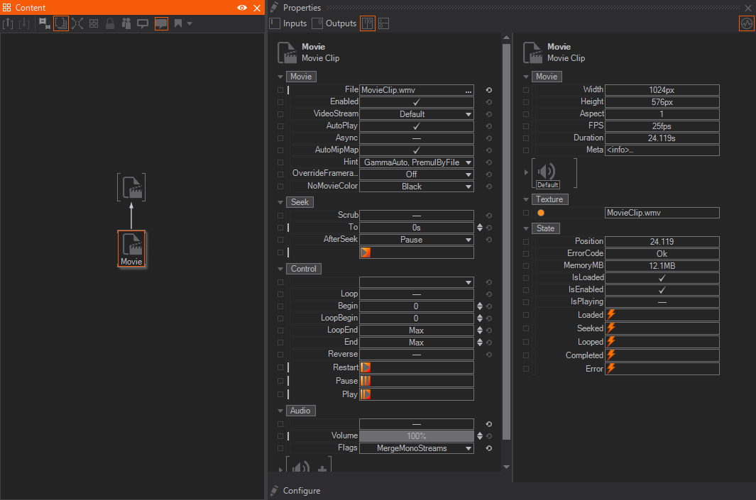

If a 2D Layer lacks the level of control you need for a movie clip, you will need to use the Movie Clip Node for loading and playback control.
You can find the Movie Clip Node in the Texture category of the Toolbox.  Drag it from there and drop it into the Content Editor. Just like the Texture Loader Node it provides a texture property that can be bound to any rendering node. Again, the rendering node needs to change its default Image Loader Property Group to a Texture Property Property Group. And again you can use the built-in Extract mechanism.
Again you gain information about the movie like its width and height as outputs and you can instruct it to load asynchronously. With its Play, Pause and Restart methods you can control the playback of the movie using events.
For more information regarding movies, please refer to the Movie Clip Loader Node page.

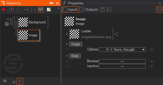

If you need to display an Image or Movie file in the 3D World with only very basic options available you will still want to use either the Image Node or Background Node. They are used inside the Hierarchy Editor, so you will need to switch to any Layout other than Design to work with them.
Essentially both these nodes work the same, just the rendering of the provided texture is different.
  • The Background Node renders the image on top of each already rendered object and will be occluded by each object rendered after it.
  • The Image Node will create a Rectangle which extends in 3D space and is rendered and occluded by other objects as usual for any 3D object.
Most times, the Background Node is best rendered at the very first position in a 3D Layer so that it does not occlude anything.
For information on the render order inside the Hierarchy Editor see its reference page or the Introduction Page to the Hierarchy and Content Editors.
Note that the Image and Background nodes can render Textures loaded by Texture Loaders or Movie Loaders just like any other 2D Layer!
The Image Node renders an image in the same aspect as the loaded image - the larger side of the rectangle will have a scaling of 1. Use an Axis Node in front to change the position, rotation and scaling of the Image. To change the transparency of the image you will need to place an Alpha Options node in front of the Image node in the Hierarchy Editor.

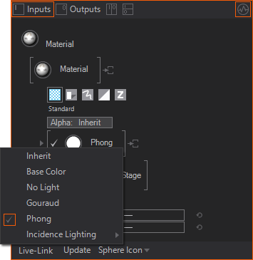

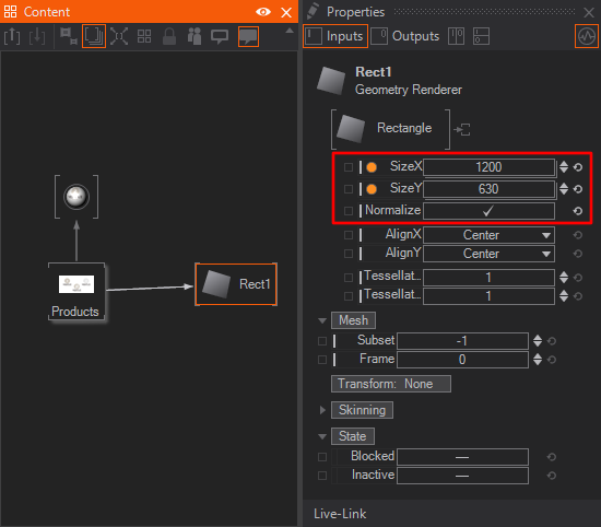

You can find the Material Node in the Color/Material section of the Toolbox and it can be added into the Hierarchy Editor. When you first place a Material Node you will not see anything rendered on screen, unlike what happens with the 2D Layers and Image and Background Nodes. This is because the Material Node does not have any geometry to render onto by default.
You can also drag and drop any Image or Movie file from the Windows Explorer into the Designer's Hierarchy or Content Editors to create a Material Node or Material Provider Node respectively.
To make the Material visible, you can place a Rectangle in the Hierarchy behind it. You may need to adjust the rectangles sizes with the SizeX and SizeY properties in order to match the aspect ratio of your loaded visual. The Normalize property scales the largest dimension of the visual down to 1 unit, and scales the other dimension accordingly to maintain the correct aspect ratio for the loaded visual. With this property enabled you can easily bind the SizeX and SizeY properties of your Rectangle to the Texture Height and Texture Width properties of the loading Texture or Movie Loader Node.
The biggest advantage of this method is not only that you do not need to manually type in the size of the visuals you load - but rather that you can still load visuals of any size without ever knowing of them when building your presentation, and it will automatically fit in the slot you designed for it.
Finally, with the Material Node in Place you can enable or disable lighting by changing the Lighting Mode property group to Phong.
