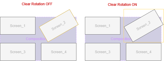

Clear Rotation
With Clear Rotation enabled you will get the size and position values of the bounding box around your Source element

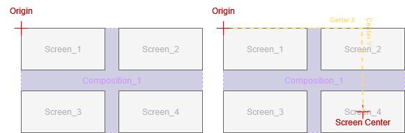

Example
A typical task that can be fulfilled with this Node is to find the position of a Screen inside a certain Composition to automatically render elements of a Scene to that screen.
So let's try to find out the exact position of Screen_4 inside Composition_1. Keep in mind, that all values provided by the Render Setup Relation Node are relative and that the origin is always TopLeft
  1. Add a Render Setup Relation Node to your Scene.
  2. Set the Mode to TargetComposition SourceScreen.
  3. Select Composition_1 and select Screen_4.
  4. At the Output of the Node you get the CenterX and CenterY values in pixel that you can now use inside your scene logic.
