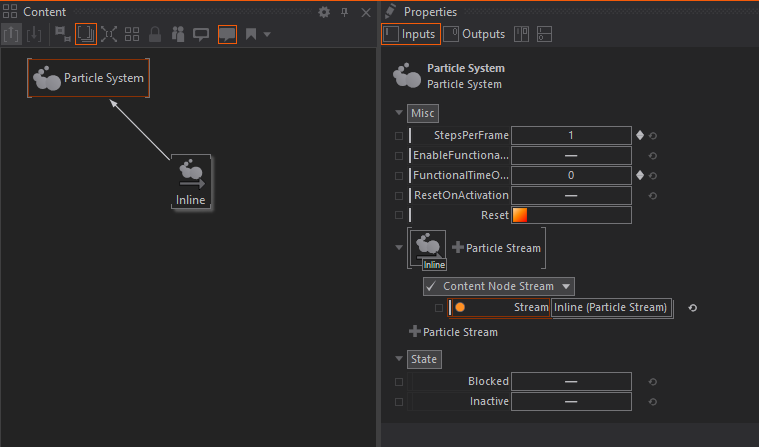

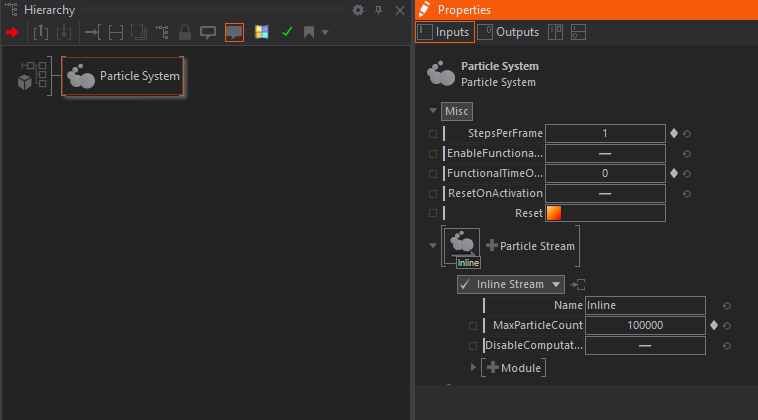

A Particle System must be placed in the scene's hierarchy by using the Particle System Node. It can consist of several Particle Streams. They can be placed either as Property Groups in the Particle System or as Content Nodes and bound to an Input of the Particle System Node.
Inline Stream Content Node Stream
Each Stream consists of several Modules that fall in these categories:
  • Emitters create particles
  • Modifiers move and modify particles
  • Renderers render particles
  • Specials modules do more specific things
A useful particle system needs at least one Emitter and one Renderer. Modules can be mixed with minimal limitations, so you can have more than one renderer or additional emitters and animations between renderers.
Each particle system can have multiple Streams of modules, allowing to create more complex systems like a Source Emitter whose Particles work as Emitters themselves.
