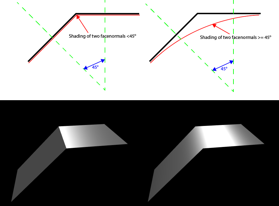

In the Process Category you can change the interpretation of the Geometry while importing. AutoNormalSmoothAngle will set the angle in degrees at which the polygons will be grouped together into one smoothing group or when a phong break will occur.

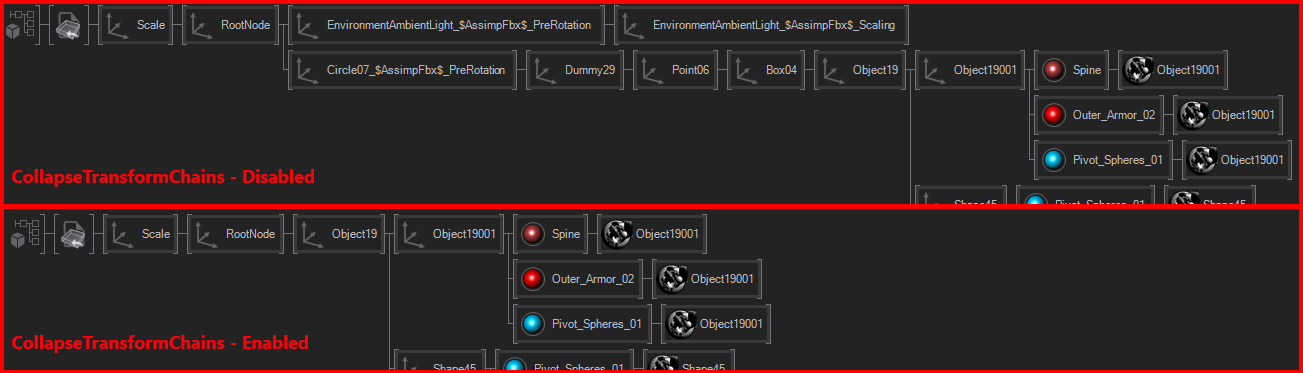

The Optimize Category offers several options that allow for performance-wise optimization. The CollapseTransformChains takes chains of axes that are not animated and only have single children and collapses them into a single node. If the imported file contains animations any on of these axis, the optimization can not be applied.
When BakeTransformations is turned on the Node bakes all Offsets of the pivots of each Subset into the resulting Mesh, so that there is no need for Axis Nodes.The CleanAnimations boolean goes trough all animations and removes all unnecessary keyframes and removes animation channels with repetitive or same keyframes, it may happen that a channel is filled with "same value" keyframes which have no function, for example always scaling 1.0 keyframes. MergeMaterials will allow the node to look at the resulting Materials and merge all that are equal to each other so that their children will be placed in the same subtree. MergeSubsets will also merge all Subsets that have the exact same parent nodes (due to baked transformations and merged materials). The following table illustrates some of these cases for better understanding.

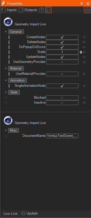

To load your object in Ventuz you simply place a Geometry Import Live Node in the Hierarchy in your Ventuz Scene. On the bottom of the properties window you can find a Menu named Live-Link. Open it and you can see a list of all currently supported software. In each of those you see the objects with a Ventuz Setup Link Tag in the open scene in Cinema 4D. Select the one you want to use and click on Update. When opening the Dropdown menu again you can change the connected Object or disconnect completely.
Every Mesh you import this way will be saved in your project directory in the Geometries Folder named with an automatically generated UID. You are able to copy and rename it to be able to reuse the geometry as if it was imported with the Standard Geometry Import Node.

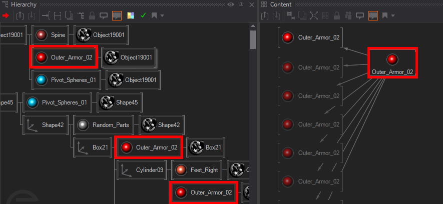

Node chains only get deleted if they a) "belong" to that importer / setup tag, b) aren't present at that place in the hierarchy coming from C4D, and c) are still linked to their original tag. So either unlinking the Axis or putting something in front of it will shield that node from deletion.
In the Output Properties, you can find the DocumentName. This is set to the last Cinema 4D Scene Name that the Geometry Live Link node was connected to.

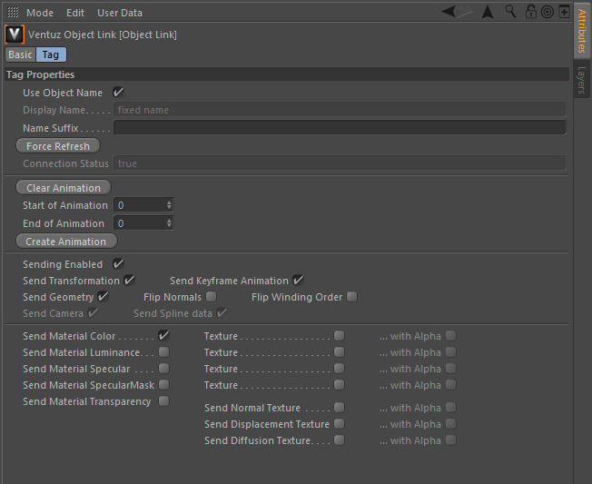

Ventuz is able to read several properties of a Geometry from Cinema4D. To define which properties should be sent, you can configure the Ventuz Object Link Tag. Click directly on the Tag in your Cinema 4D scene's hierarchy (clicking on the Object in the Hierarchy does not do - you need to click the tag itself). Now in the Attributes Window you can adjust everything regarding that tag.
All changes to the tagged geometry or its modifiers will be automatically updated and sent to Ventuz - if activated in the Tag. Whereas every change to a property of the Tag itself needs a manual update of the Geometry Import Live Node in Ventuz to take effect.
Use Object Name will define if Ventuz should use the same Name as Cinema4D for the created Node or if you want to set a different name for it. You may also create a Name Suffix to append to the Name in the Cinema4D scene. Force Refresh will update the Nodes in your Ventuz Scene while Connection Status displays if the geometry is used for a Live Link.
The animation related properties will be discussed below. Sending Enabled controls whether to send information or not. Send Geometry defines whether information about the Mesh of the object should be sent and Send Transformation will enable sending the transformation data relative to the parent object in the scene's hierarchy. Send Camera will send the Cameras Position and animation. While if you have created a 2D Text or Spline you can enable the Send Spline data.
To use the Path somewhere else in your scene you first need to save the scene. This will also serialize the Path to a Ventuz Path File in your Geometries directory.
The Material Options define which Properties of the Material to send. If none of these options is enabled, Ventuz will not create a Material Node. Note the differences in the naming of the maps in Ventuz and Cinema4D.

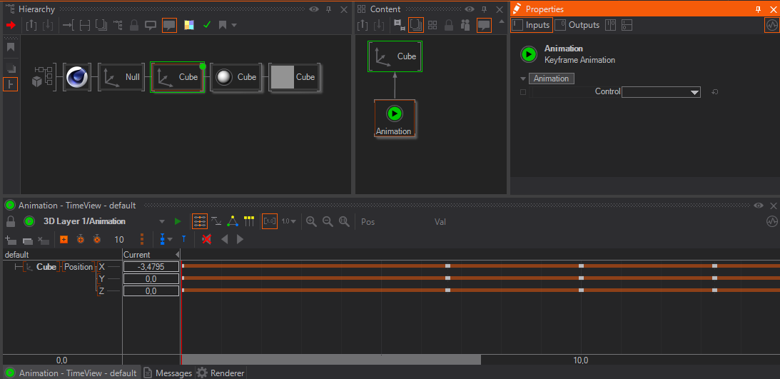

The Ventuz Live Link can handle two different types of animations. Mesh Sequences and SRT (Scale Rotate Translate) animations. The least are simple keyframe animations based on bezier curves that simply translate rotate or scale the mesh in the world while the Mesh Sequence is deforming and transforming the whole mesh and may take a lot of resources depending on the complexity / vertex count and amount of frames.
To submit a Mesh - Animation you can create it in your scene as usual in Cinema4D - add some keyframes in the scene's animation timeline and adjust some properties of your geometry or its modifiers and link them to the keyframes. To send them to Ventuz you have to first define the wanted time interval with Start/End of Animation and can then click on Create Animation. If you want to delete the Animation, click on Clear Animation. This will transfer the range for the selected Mesh Sequence.

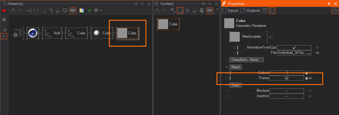

On the Ventuz side you can animate through the defined keyframes by using the Frame property of the Mesh Loader Node (not the Geometry Import Live Node). To be able to send the Animation you must make sure that you enabled the properties in the Object's Ventuz Tag.
A Standard SRT Animation will be updated as soon as you added some keyframes to the geometry, for example translated and rotated it at different keyframes and hit the Update button on the Ventuz side. This will automatically create a Keyframe Animation node inside the content editor and have a binding to the respective axis.
You can set the Control Property of the Keyframe Animation to control / Start / Stop the animation as usual.
