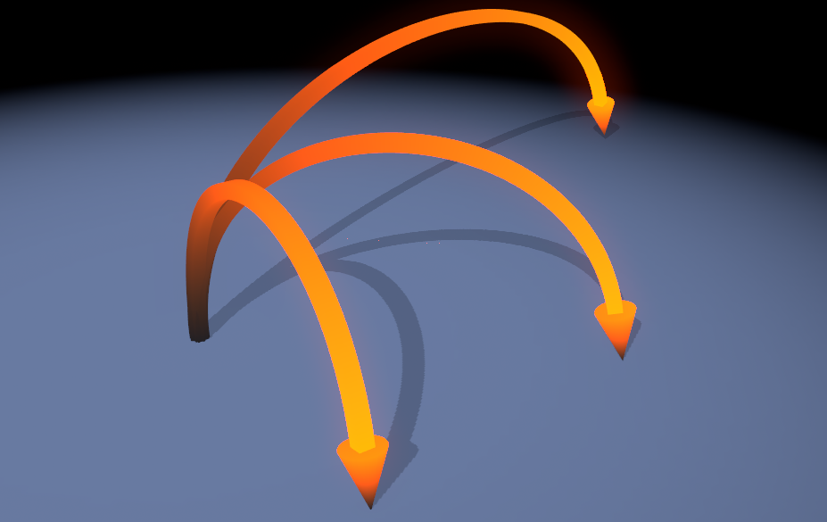

The Arrow Nodes are able to render extruded lines in the scene. There are two types of Arrows for the different kinds of definitions of the line: The Anchor Arrow renders a line from its position to the position of a given Anchor. The Path Arrow extrudes a given Path. The type of the arrow can be changed with the Source property group.

AbsoluteArcHeight and RelativeArcHeight change the curvature of the arrow by adjusting its maximum height. Absolute changes the height in world units and relative creates a height relative to the distance between start and end of an arrow. Curvature changes the course of the arrow - the lower the rounder and the higher the more peaked.

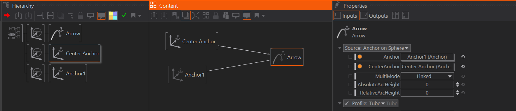

This mode is meant to draw arrows on a sphere. To draw an arrow, it needs the Arrow node, one bound Anchor and a bound Anchor as CenterAnchor. The center anchor is needed to render the arrows and mathematically to define the center point of the sphere, where the arrows are drawn on. The first arrow renders between the Arrow node and the first Anchor.
A basic setup would use the Spherical Axis and two anchors:
Most properties are identical to the Anchor Arrow mode described above. The different MultiMode FromFirst draws arrows with the Arrow node as starting point and each connected anchor as single endpoint, similar to FromCenter.
