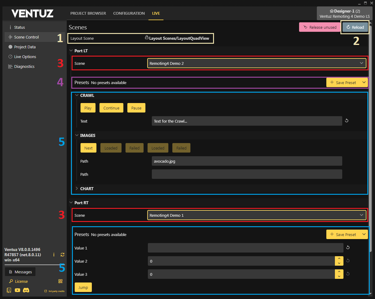

Scene Control
With the Scene Control section the currently loaded Scene(s) in the runtime can be overviewed and changed. The Scene Data can be controlled over here for each loaded scene. Also the Layout Scene is displayed.
For a good Ventuz structure and Scene Management, please see: Scene Management and Scene Tree Editor
  • 1: The Layout Scene of the loaded project is displayed on top of the page. The Layout Scene can not be changed while the runtime is running.
  • 2: With the Reload Button changes on the Scene Data can be loaded. For example: If you are editing the Scene Data in Designer or adding some properties, these changes will be visible by pressing Reload.
  • 3: Every Layout Scene holds at least one Scene Layer which can load other Scenes. If there is no Layout Scene configured, a default layout with one Scene Layer is set. In the red rectangled section you can select the Scene which should be loaded. The Scene is loaded instantly. The required Scene needs to be part of the current loaded project.
  • 4: With a preset the edited Scene Data can be saved and later used again. Simply press Save Preset. It is possible to export them or importing in .json format. For more information on presets see here: Presets.
  • 5: These boxes hold the Scene Data of the loaded scenes. All items which are part of the Scene Data can be edited here. By collapsing these boxes more items can be displayed in parallel. The changes made are affecting the bound nodes in the scene in realtime.
The Web Configuration Editor uses the ​invariant culture with periods . for floating points and commata , to seperate array items.

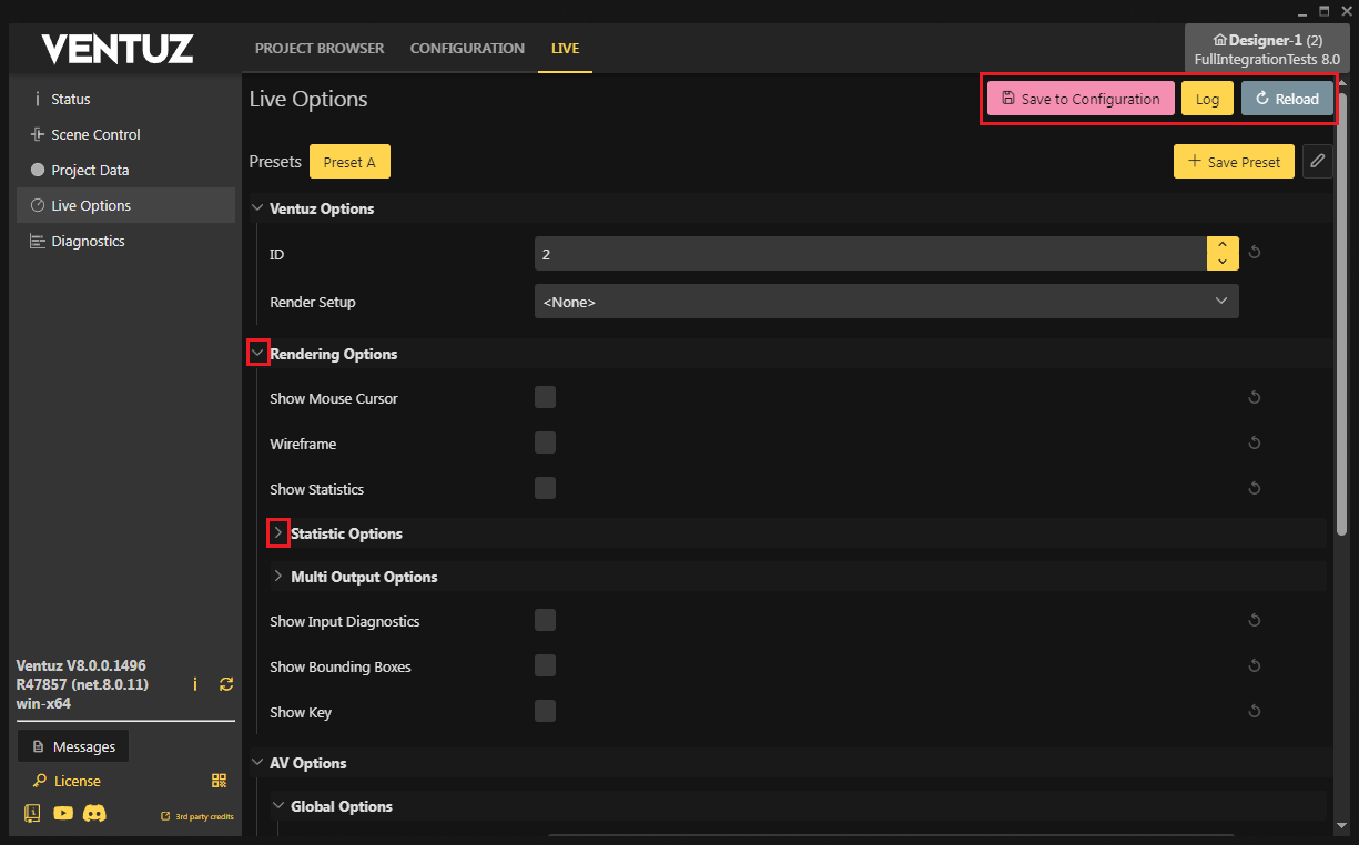

Live Options
With the Live Options section of the Configuration Editor, settings of the active Runtime can be adjusted and also saved to the Device Configuration. Therefore changes can be done in a running production environment according to the adjustments which might be necessary. Also many output device settings are changeable with the AV Options. Especially when working with SDI, with these changes fine tuning to the other video hardware is possible. With the Show Statistics toggle enabled, one can debug and monitor the performance with the Performance Statistics and Diagnostics.
Some of the Live Options are applied immediately. Settings which refer to the Device Configuration, needs to be saved by pressing the Save to Configuration button. This will write the config settings to the Device Configuration. With starting the Runtime again, these changes stay in use.
The Log button writes the set Live Options and Device Configuration to the Messages Dialog.
With Reload the Live Options are updated. If the Device Configuration or other settings have changed (e.g. with the options in Designer), Reload will load the new Live Options.
The Live Options can be (un)collapsed by pressing the - Icon or + Icon at each section for a better overview.
All settings can be saved to a Preset with the Editor. This is especially useful for all settings which are not saved to the Configuration. For example: You need to monitor and debug your rendering and output, to not need to activate the desired Statistic Options and the Show Statistic toggle, simply create a Preset with all the activated options.
Please note that Live Options can only be saved if the corresponding configuration is not set to (None). The actual values of the settings are injected into the currently loaded file and it will be saved to disk.
Ventuz Options Description
ID Overwrites the Machine ID in the Configuration. In a Machine Cluster the ID changes the Master / Client behaviour and the rendering of the correct Render Setup part.
Render Setup Changes the Render Setup for the machine. Note: To use a Render Setup in the Live Options it needs to be included in the Ventuz Presentation or part of the project, which is currently running.
Rendering Options
Wireframe Toggle to only render the wireframe of the geometries
Show Statistics Turn on the Performance Statistics and Diagnostics in the renderer
Show Mouse Cursor The mouse cursor will be visible on the rendered output
Show Input Diagnostics Toggle to show the Input Diagnostics of the incoming touch devices
Show Bounding Boxes Turn on to show the Bounding boxes of the selected Node in Designer.
Show Key Toggle to show the key output in the Preview Window, while an external keying output mode is active.
Statistic Options With these Live Options, the specific Performance Statistics are toggled. For a detailed description see the Performance Statistics page.
Multi Output Options
Enable Physical Outputs Toggle if the physical outputs will play out the rendering. With deselecting, the outputs are not active.
Lower Resolution for Previs This will lower the resolution inside a Previsualization Scene. Previs scenes can have very huge resolutions, to ensure good performance while working on a bigger scene it is advised to use this option.
Preview Without Scaling This forces the Renderer to render the current Designer Preview in its configured resolution coming from the Render Setup, it will also crop the image if the renderer window is to small. This only affects the Designer, the runtime will always use the configured output resolution!
Multi Bezel Color Use this to change the color of bezels inside the Designer Rendering Window.
Per Output Stats Defines the displayed Performance Statistics referring to the output. All: Shows all statistics on all outputs. Preview: Shows the information only in Designer Preview Window or Runtime Preview Window. Per Output: Shows the information referring to the specific output playing out.
Enable Software Watchdog Enables the Software Watchdog, alco can be set in the Video Options.
AV Options With these settings the Input and Output device streams of the Device Configuration can be adjusted and saved to the config. The settings vary depending on the configured devices and streams. Especially the Video Output setting in general and the Advanced Video Options are adjustable. Please refer to these pages for the information of the specified settings.

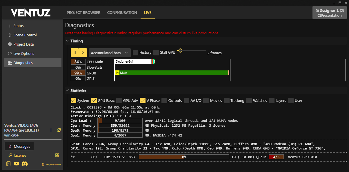

Diagnostics
The Diagnostics section mirrors the Performance Statistics of the active runtime on the selected machine. In general it shows the same information as you can see in the Performance Statistics. The big advantage is to be able to monitor a runtime remotely from a different device and without disturbing the output rendering. Also in many output scenarios, the rendering is splitted across multiple display devices.
Having the Diagnostics running requires performance and can disturb live productions!
In the Timing section the performance demand of the GPU and CPU is shown for an overview of the systems used resources. For the SlowStats bar are certain Performance Statistics which can be enabled in the Live Options and may slow down the rendering. To stay aware of this we integrated this timing bar.
With the Pause and Play button, the timing bars can be paused or keep running. When investigating for a system overload it is useful to pause the timing to be able to check in detail which engine tasks needs a lot of performance and eventually optimize the Scene.
The type of the performance bars can be changed with the dropdown menu. Please refer to Accumulated Bars vs. Detailed Timeline for more information an the impact of the selection. With the History toggle, the diagnostics of the last frames are shown as well. This is useful, if you have a performance lag, with a specific task (e.g. loading/playing back a movie). You can trigger this task and pause to see in detail which aspect is taking all your resources and may change the format of the video to solve the problem. The Stall GPU: The slider for adjusting the number of frames will change the scope of the timing bars to a different number of frames.
The Statistics section displays the Performance Statistics in the UI. The displayed selection of statistics can be made with the selection boxes at the top. They are very similar to the ones in the Live Options and are described on the page of the Performance Statistics.
