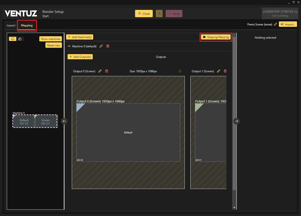

To get into the Shaping and Warping Editor open up the Render Setup Editor, open a new or existing Render Setup and go into the Mapping Mode. There you will find the Shaping & Warping button in the top right.
You can shape/warp only for the local machine when using the Web-based Configuration Editor! Not for the whole cluster.

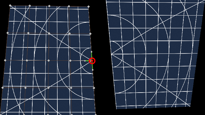

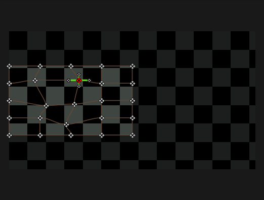

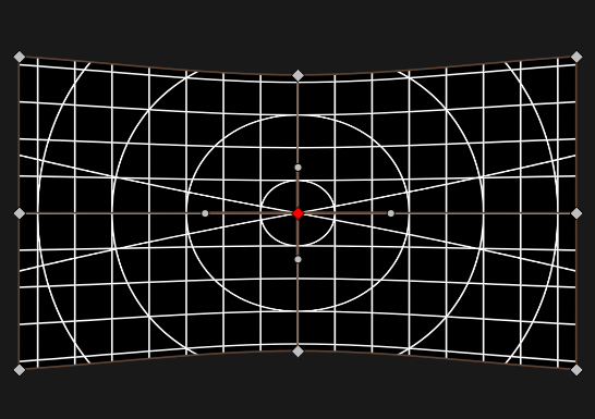

Warping is done by defining a grid. By default, a 2x2, 3x3 and 5x5 grid are automatically created, called Layers. All layers together are called a Group. It is possible to add additional layers if more control is required, or to add new rows and columns to an existing layer.
The finest layer will be used to create a mesh that does the actual distortion. The coarser layers are used to modify the finer layers. It is possible to switch freely between the layers and do coarse corrections even after fine-tuning was done without losing work done on any other layers.
When rendering a mesh, the texture is linearly interpolated, while the control grid uses Bézier splines to interpolate. So it is not good enough to just use the finest layer as base for warping, within Ventuz adaptive tesselation is applied until the error is below a certain threshold.

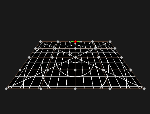

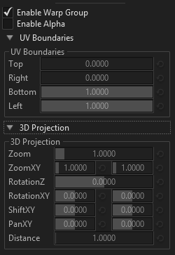

The whole warp-group can be rotated in 3d space to compensate keystoning or create projection mappings. This will create precise perspective distortion. Using the warping grids and Bézier splines, perspective distortion can only be approximated, possibly requiring very fine grids if the image is tilted a lot.
For projection mappings one can define multiple warp groups. Each group has it's own 3d rotation, UV-boundaries and multiple warp layers.
For projection mapping, the UV coordinates can be edited the same way as the control points positions. This is only possible on the finest layer. In addition, the UV-boundaries can be changed on the coarsest level.

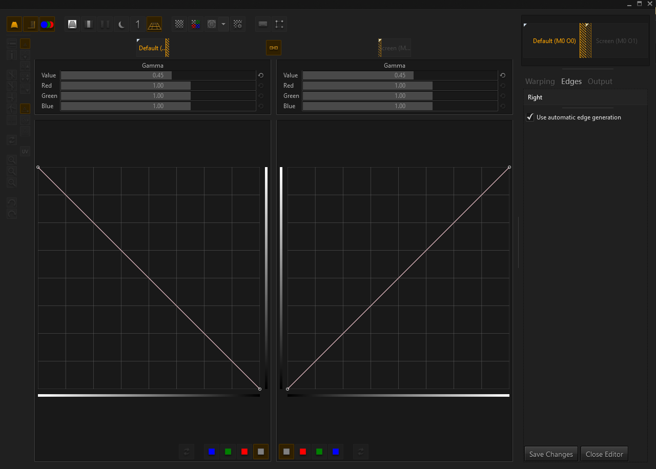

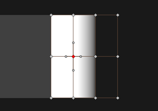

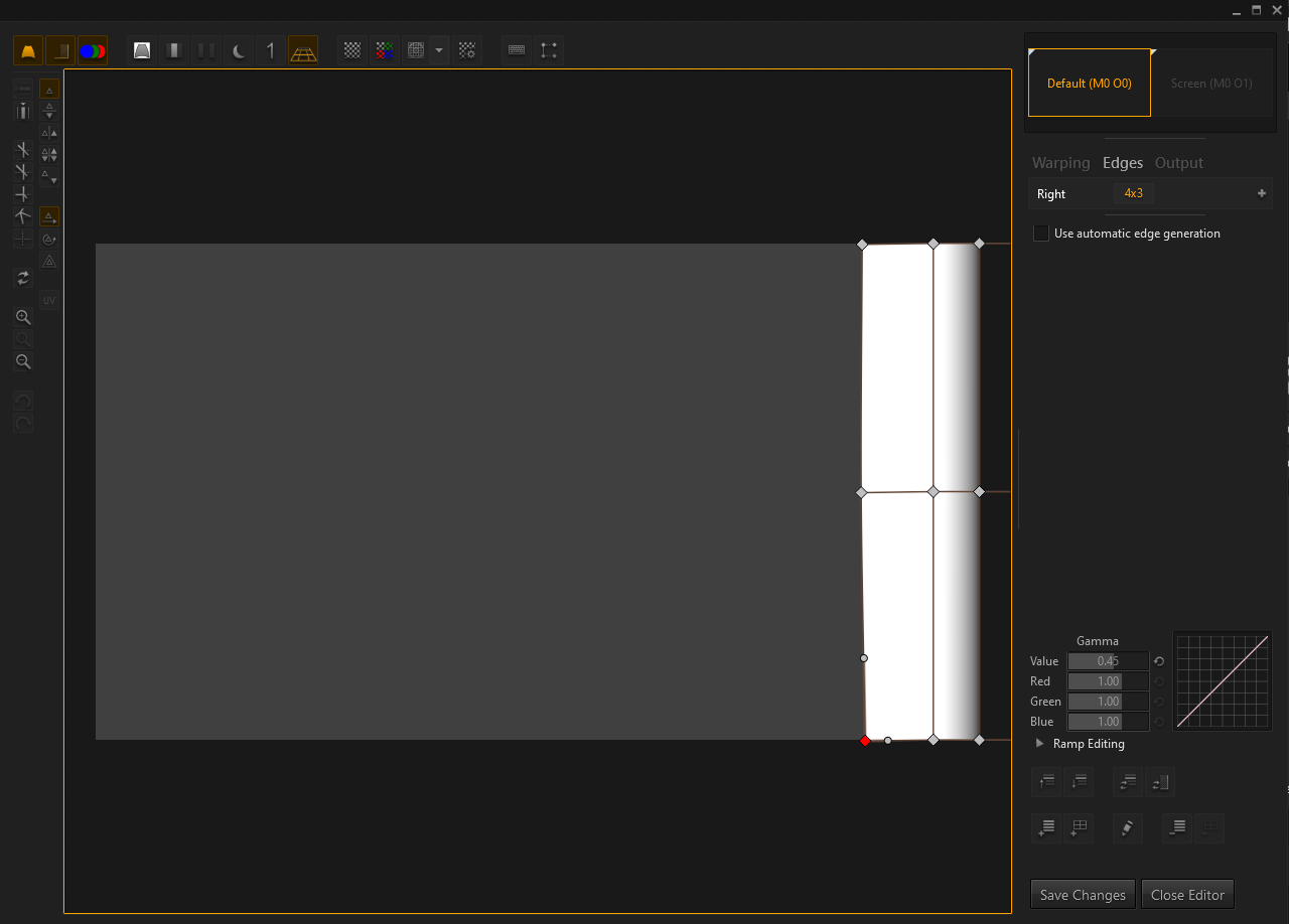

Soft-Edging is done in the same way. In a simple 3 projector setup, the middle projector will have two groups, one for the left edge and one for the right edge. These groups have only one layer by default, and for simple setups it is rarely needed to edit the control points. But when projecting on irregular screens the ability to have multiple layers with a high number of control points comes in handy.
For each edge individually, the ramp can be controlled by gamma values and a spline when more control is required. Both gamma and spline are available as a combined value and separate red, green and blue values. All gammas and splines are combined and can be used simultaneously.
The ramps are internally calculated with 16 bit precision. Projectors of course don't support such quality, and in some conditions banding is visible in the ramps. Dithering can be enabled to re-gain some of the internal precision, which usually solves any notable banding.

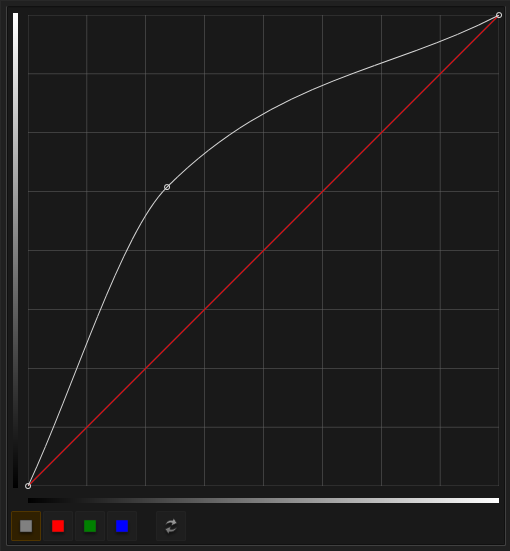

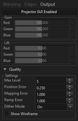

For each output, a simple Color Correction with lift and gain is available. Gain will make the image brighter or darker, without changing the black level. This is done by multiplying the RGB values with the gain. Lift will change the black level. This is done by adding to the RGB values before applying gain.

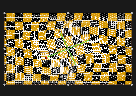

The performance of warping depends on how fine the warping mesh is tesselated. This can be checked with the Show Wireframe option. On modern GPU's this will rarely be a problem.

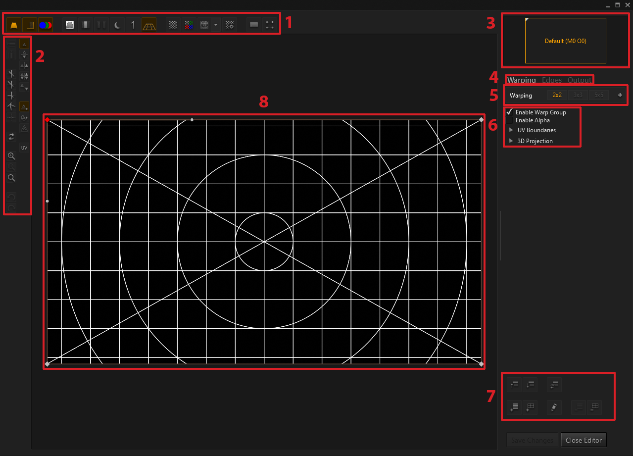

Here a general overview of the user interface:
  1. Toolbar for global tools
  2. Toolbar with control-point related tools (side-bar)
  3. Output navigation show the currently used #screens used in the Render Setup
  4. Switch between output settings, warping and soft-edging
  5. Group and layer navigation
  6. Group and layer related properties
  7. Toolbar with group and layer related tools
  8. Grid Editor
Many operations have keyboard shortcuts, so most of the work can be done without looking at the user interface on your computer monitor, but at the outputs directly.
The output navigation (3) displays a schematic view of the outputs. It will not try to faithfully represent the actual size and position of the displays but indicates the general layout, like a subway map will not represent the actual distance between stations. For instance, overlap is not shown here.
To change the current output, either click or click and drag in this area or use cursor + alt keys to change the current output.
The area marked with (4) can be used to switch between warping and soft-edging. The output section contains color correction and other per-output settings.
The group and layer navigation allows to jump between groups and layers. Here are examples of two edging groups with one layer each, and a warping group with 3 layers.
With the keyboard, pressing 'W' or 'E' will cycle through the warp or soft-edge groups. Page up and down walk through the layers of the current group. The home key goes to the coarsest layer and the end key goes to the finest layer.
If you have multiple groups, SHIFT + Page Up / Down will select groups and ALT + Page Up / Down will move the current group up or down.

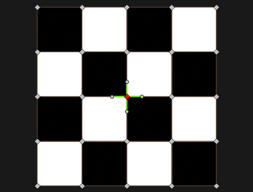

The color of the control points has the following meaning:
  • Gray: not selected
  • Orange: selected.
  • Red: current cursor position, also selected.
  • White: The mouse is hovering over the selected control point.

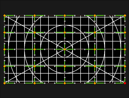

To select points, left-click on them. Pressing shift while doing so will add to the selection. When clicking beside the points, a rectangle is drawn as the mouse moves, and the points in the rectangle are selected. Again, pressing shift while doing so will add to the selection.
Pressing CTRL A will select all points, CTRL D deselects all points except the control point where the cursor is. The cursor can not be hidden and the control point at the cursor is always selected.

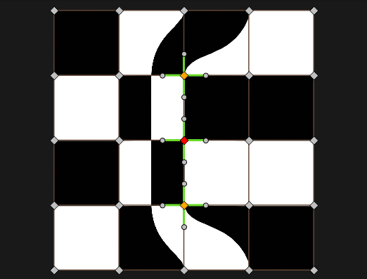

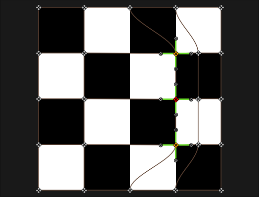

In addition to the primary control points at the cross-sections of the grid, there are control handles for finer control over the mesh. These are only visible, and can only be clicked on when the associated primary control point is selected.
When working with the keyboard, using the cursor keys will move the cursor, and the cursor is also selected. Pressing 'b' will enter box-selection mode, again use the cursor to change the box size. To move the cursor to a control handle, use cursor keys + CTRL.

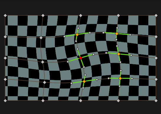

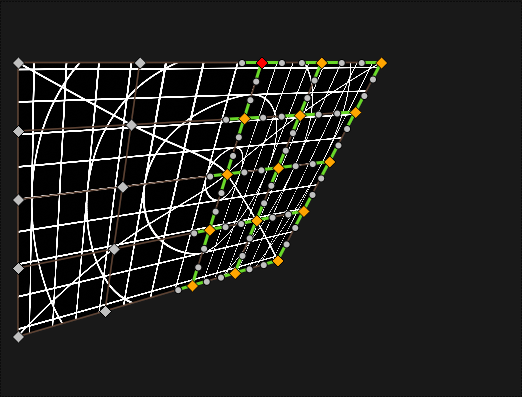

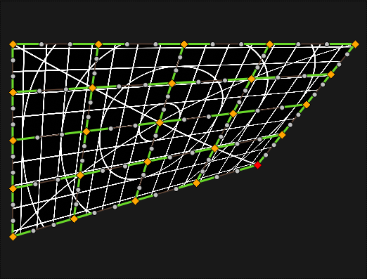

Smart Mode is good to edit a rectangular selection of vertices. It is done by first making a selection, and then pressing SHIFT and ALT while moving control points either with mouse or cursor keys.
If corner or edge control points are moved, all selected control points will move along, in a proportional manner:
Here we have selected all control points and move the lower-right corner:
Now we select the right half of control points and move the edge towards the middle:
Smart Mode is best explained with rectangular selections, but it will work with selections of any shape. The definition of what is an edge or a corner depends on the limits or bounding box of the selection. With a selection containing no corners, smart mode is of limited value.

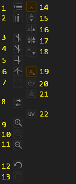

The Side-Toolbar
At the very left of the editor is a toolbar with buttons that help edit the grid.
Nr. Keyboard / Mouse Descriptions
1 Insert row (right of cursor)
2 Insert columns (below cursor)
3-7 A U K L S Handle Modes, see below
8 X Reset selected points to default position
9  wheel up Zoom in
10 R Reset zoom and pan
11  wheel down Zoom out
12 CTRL-Z Undo
13 CTRL-SHIFT-Z or CTRL-Y Redo
14 cycle with O, SHIFT O Mirror Mode off
15 cycle with O Mirror Mode Horizontal
16 cycle with O Mirror Mode Vertical
17 cycle with O Mirror Mode Horizontal + Vertical
18 cycle with O Mirror Mode Point-Symmetry
19 Normal Control Point Movement (Translation)
20 Toggle with SHIFT S Scale
21 Toggle with SHIFT R Rotation
22 Toggle with SHIFT U UV Edit Mode
- ESCAPE Reset mirror, scale, rotate and multiselect

Handle Modes
The color of the handles indicates how the handles behave and which constraints they enforce.
Name Color Shortcut Description
Linked Green A Both sides have same direction and stretching
Straight Yellow U Both sides have same direction, but can be stretched differently
Unlinked Red K Both sides are completely independent, allowing for kinks and different stretching
Linear Pink L Handles are automatically calculated for linear interpolation
Default Brown S Handles are automatically calculated for maximum smoothness
With most modes, the change of a handle is local and affects only the area of the surrounding 3x3 control points. In default mode, the change affects a 5x5 surrounding. This mode is useful for the 2x2 and 3x3 layers where this does not matter.
To change the mode, select a handle and press one of the handle mode buttons. Alternatively, use the keyboard shortcuts in the table above. In both cases, when selecting a primary control point, both horizontal and vertical handle mode are set.
In default mode, the handles are calculated automatically. When trying to move a handle in default mode, it automatically switches to linked mode to allow editing.
Insert Rows and Columns
To insert a row or column in the finest layer, Select a primary control point and press the insert row or insert column button. The new row or column will be inserted to the below or to the right of the selected point. Therefore, the option is disabled if selected point is in the rightmost column or the bottommost row.
Please note that the handle modes are changed by this action: when inserting a single row into a 5x5 grid, the distances between the rows is different and the linked handle mode can not be used anymore, it is automatically changed to straight where that is required.
The subdivide-feature explained below does not suffer from this as it inserts rows and columns everywhere, uniformly.

Subdivision
By pressing the '+' icon in the layer navigation, the finest layer can be subdivided in X, Y or both. This will insert a row and/or columns between every existing pair of rows/columns: a 5x5 point grid turns into a 9x9 point grid.
As 33x33 is the finest allowed layer, any layer with more than 17 points either horizontally or vertically can not be subdivided anymore.
Subdivision is the most precise way to add more control points, as all other methods are worse at capturing detail in the new, finer layer.
One could consider a 5x5 point grid is a 4x4 square grid, and every square gets sliced in half horizontally and vertically, resulting in an 8x8 square grid, or a 9x9 point grid.

The ramps for soft-edging execute the following functions in this order:
  1. Apply the white spline
  2. Apply the separate red/green/blue splines
  3. Apply the gamma value
  4. Apply the separate red/green/blue gamma values
This allows you to roughly adjust the gamma, and then use the spline editor to fiddle with the ramp until it is satisfactory.
Each ramp (or group) has its own set of gammas and splines.
This is the same for automatic and manual mode, even though the user interface differs.
Spline control points are inserted by clicking on the spline itself. They can be moved by clicking on them and dragging them. Moving a control point next to another control point removes it.
The buttons below switch between the splines for white, red, green and blue, and revert the spline to default.
Automatic Mode
In automatic mode, the shape of the edges can not be changed. If the warping is correct, this should not be required.
The output navigation will show the edges. By clicking on an edge, an editor window will open up and allow to edit gamma sliders and splines of both adjacent edges.
Manual Mode
Here the geometry of the edges can be edited just like a warping layer. It is possible to add more control points to the grid. Remember that the edges are also warped, which can be a bit confusing when editing edge-layers on the projection screen.
In manual mode, only one edge can be edited at a time.
Each point has an associated value, which is either 1 (white, image) or 0 (black). If more complex forms than simple edges are required, this value can be edited with a slider among the properties or by pressing the I and shift-I keys, setting the value to 0 or 1.
The spline editor for the ramps is started by pressing on the small splines next to the gamma sliders. This opens a bigger window.

The Quality section mainly controls how fine the warping mesh is to be tessellated. The defaults are set for quite high quality, when using more precise values you should check for wasteful over-tesselation with the Show Wireframe option.
Name Description
Max Level Maximum subdivision when creating the mesh from the finest layer
Position Error Acceptable difference for the vertex positions between perfect Beziér interpolation and the actual mesh, in pixels
Mapping Error Acceptable difference for the UV mapping between perfect Beziér interpolation and the actual mesh, in pixels
Ramp Error Acceptable difference for ramp colors between perfect Beziér interpolation and the actual mesh, in color values ranging from 0 to 255
Dither Mode Enable dithering to improve ramp quality. Temporal dithering will change the dither pattern every frame, that usually gives better results but may result in undesirable artifacts.
Show Wireframe Shows the wireframe of the warping mesh. Useful for checking if the level of subdivision is reasonable or insane.

Enable Warp Group / Alpha Blending
These options are especially useful when working with multiple warp groups on the same output.
Enable Warp Group is on by default. This allows to temporarily disable a warp group.
Enable Alpha This allows to use alpha blending when warp groups overlap. Since the alpha channel often contains garbage, this is disabled by default
UV Boundaries
This allows making a warp group use only a portion of the content. Numerical input is possible for entering precise values.
This is useful when using multiple warp groups.
The same effect can be achieved with the UV Editor. This is more convenient for moving the whole UV selection, while the UV Editor allows irregular warpings. Both methods can be combined.
3D projection
With these values set to default, the warping mesh is rendered straight on the screen, with no distortion.
3D projection allows a virtual camera to move around the warping mesh to get perspective correct projection.
All fields allow for precise numerical input.
Rotation will orbit the camera around the warp mesh.
Zoom will change the field of view.
Distance works like a vertigo slider: at the same time the distance is changed, the zoom is changed the other way around to preserve the size of the warp mesh. This will either exaggerate or minimize the effect of the perspective distortion.
Shift this will move the warp mesh around, while the camera stands still. Pan this will move the final image around, with no change in perspective.
Shift will move the warp mesh
Press ALT R to reset the 3D-Projection.
