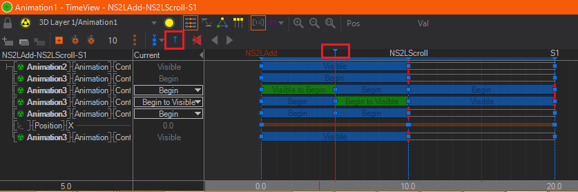

Multiple Animation nodes can be grouped into one or multiple nested Animation Groups. All templates defined in all animations within a group-tree are treated as concurrent as if they were defined by a single Animation Node. This grouping technique increases the usability since technically independent animations can be combined into one logical animation host if the actual templates shall behave concurrently. A template host that is defined by an animation group is the only host that can have multiple DataModels and is therefore restricted in some functionality.
Every Template of the entire system defines the dependent sub-hosts. This is either done automatically (system-templates) or manually via the DataModel. Only templates defined in a Template Host that is linked in the host-tree are accessible. Unlinked elements are currently useless. In order to link a template host into the system, the user has to either inject the scene into the project template host (programmatically) or add the animation to the DataModel of the parent host which can be the SceneData or the DataModel of another animation node, see Project and Scene Data.

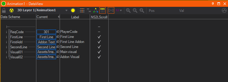

The data model can be created and accessed via the Data View of the animation editor window. As we saw above, this is also where Subtemplates are added and controlled.
To add a data item, simply drag and drop the property to be controlled as animation data into the animation data panel. It will be added in a similar fashion to a scene data or project data element, except that each data element can be associated or disassociated with any of the templates of that animation node. The data panel lists all of the data items for the templates in an animation node and a column layout allowing for every item to be checked or unchecked for each template. By checking the item, the data will be associated with that template. Thus it is possible to have quite complex data models where some data items are shared between templates and others are not.
Each element should be given a unique name, and by clicking on it, you can also edit, in the properties panel, settings such as default value, allowable minimum and maximum values, a label for operator identification, or a description. Remember that as soon as you set up a data channel, any local value you had set will be overridden by the animation data, so it is worth setting up a default value first.

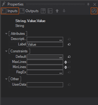

All Data Items are described by meta data that can be edited in the Property Editor after  clicking it. For example the Ventuz Director uses them to display Template and Project Data properly for the operator of the program. In Remoting you can use the Data Model's Meta Data to accomplish similar results. Below you can see how Ventuz handles these meta data.
General Properties
Besides the Ventuz specific meta data you can define your own data using the UserData property. This is not used by Ventuz anywhere and you can safely use it for information specific to your own application.
Each type of the Data Channels has a Label property that defines the user friendly display name of the channel. As opposed to the data channel names, labels can consist of special characters, e.g. spaces. In addition they are not used to identify a channel, so the data model can have duplicate labels. Similar to the label, the Description is used to present further information to the user - e.g. in the Ventuz Director this is displayed while hovering over the data item.
Format is somewhat specific to the Ventuz Director and its template based workflow - when creating a Page from a template you can decide to automatically create the page's display name and/or description from the current values of the template data. The format property defines what to use from each data item for the automatic naming. The table below shows the possible options - the dropdown of the property also displays some presets that you can choose from.

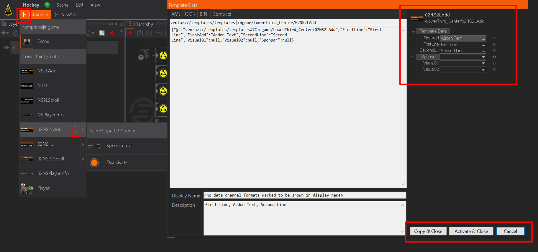

<VTD ns="ventuz://templates/ingame/Scene">
  <LowerThird_Center ns="ventuz://templates/ingame/LowerThird_Center/NS2LAdd">
