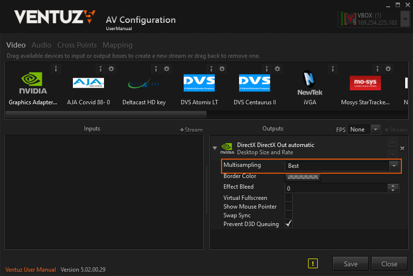

Multi-Sample Anti-Aliasing (MSAA) (Hardware Anti-Aliasing)
This is traditional anti-aliasing that is done in hardware during the rendering of the scene and the quality can be configured in the Audio Video Configuration.
Depending on the hardware the quality settings can differ in its resolution.
