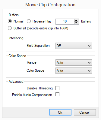

The configure button at the bottom of the property editor brings up the movie clip configuration dialog.
Here the way video frames are buffered is configured:
Audio is only available in Normal mode.
In some situations, the node may need to allocate more buffers than specified in the configuration. The amount of memory used for video and audio buffering can be monitored with the MemoryMB output property.
Only use this when playing interlaced movies to interlaced SDI outputs
This will guarantee that the fields of the movie will end up in the right fields of the SDI output. In any other scenario than interlaced playback to interlaced SDI, this will mess up the replay.
Usually, Ventuz will automatically detect color space and range. But some codecs give false information, and some clips are badly encoded. These options allow overriding the automatically detected. When using these options, be careful not to do more harm than good! These options do not apply to RGB encoded clips or images.
Color Space is one of the YUV color spaces. The difference between these is largest for saturated colors, so when in doubt use clips with color bars to check. On normal material the difference is often hard to see.

Many codecs encode YUV in a limited Color Range from 16 to 235 (Y) or 240 (UV), emulating the foot room and headroom of an analog signal. Just like the color space, this is usually detected automatically. If it should be detected wrong, a significant change in contrast and brightness will be seen, and the Color Range option can be used to override.
Disable Threading
For most codecs, each MovieClip node will create as many threads as there are cores available. It may be counterproductive if more clips are played at the same time since the threads will get in each other's way. Also, they may steal time from the Ventuz main thread, which will cause stutter.
Enable Audio Compensation
Often the audio hardware is not perfectly in sync with the video hardware. In such cases, the audio must be slowed down or speeded up to compensate the tempo of long video clips. This is called Audio Compensation and is explained in detail at the Sound Nodes.
Ignore Clip Duration
Once set the movie player won't try to determine the movie clip duration anymore (thus the node's Duration output will always be -1). Consequently, the player won't stop at a certain duration but only when the physical end of the file is reached. As a downside seeking will be less safe. The player will try to seek to a certain position; if it doesn't work, it will just remain in seeking state.

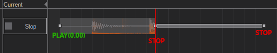

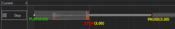

The behaviour of the Stop Keyframe requires some more explanation.
In Sample 1 we see the keyframes, the first one is Play and the two following ones are Stop keyframes. In this case the movie will start playing until the first Stop keyframe is reached and stay at that frame.
Sample 2 behaves a little different, in this case the movie starts playing, but when it hits the Stop keyframe it will seek to the position of the Pause keyframe to it's right.
It would show the same behavior at the Stop keyframe if the right one would be a Play instead of a Pause.
| Sample 1 | |
| Sample 2 | |
So we can make a general statement. The Stop keyframe first of all looks to the right to see if there is keyframe with time he needs to prepare for, if this is not the case, he looks to the left and takes over the current playback time.
