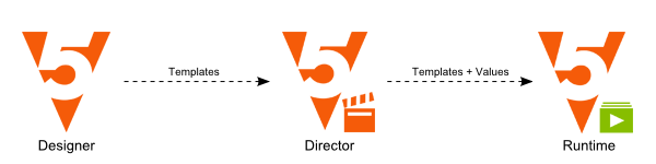

The Director is a control application that cannot create any 3D output by itself. Instead, it manages one or multiple Ventuz Presentation Runtimes and instructs them what to do. The Presentation Runtime interprets those commands and loads the required Ventuz scenes. Moreover it assets, plays animations and does the steps necessary to produce the proper 3D output. Therefore setting up the Ventuz environment and machine communication is of great importance.

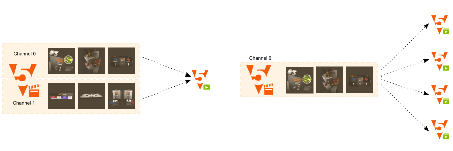

The Director’s concept is built around the idea to work with separate channels; separate feeds of content. Much like an audio application can have separate channels (tracks) for vocals, guitars and drums, which mixed together produces a single song, the Director can provide multiple channels to manage separate content within a single show. A channel allows multiple machines to connect to the same stream of templates and/or to have multiple layers of content on the same machine. For example, a single operator may drive the content of a game show on a big screen wall in one channel, while also controlling other displays for the audience with a completely different feed in another channel.
A typical Director show consists of a single channel. This is sufficient for the majority of applications and the reason why most of this documentation won't explicitly refer to multiple channels. All concepts of Director that are introduced in the following chapters extend to working with multiple channels and it is therefore left to the later chapters such as Topology or Channel Configuration to discuss the more advanced scenarios.

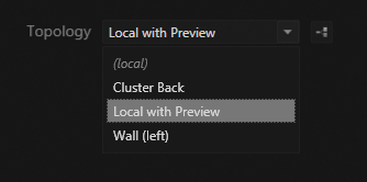

Which machines are actually attached to a channel is specified in the active Topology. A topology can be created, modified and saved via the Topology Editor which is usually done by the IT department managing the machines way before any show is run on a given setup. The Ventuz Director operator simply selects the correct topology from the empty workbench and launches his show.
In addition to the topologies stored in the local machine's configuration folder, the list of available topologies always contains a simply default topology for the local machine called (local). This configuration is ideal for new users that want to learn Director, working with remote machines is discussed in a dedicated chapter.

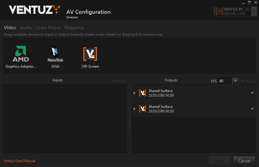

Each channel connects to two so-called pipes provided by the Ventuz Runtime: Program and Preview. Each pipe has an independent output and a template engine that controls the content shown on that pipe. Both can be configured inside the Audio/Video section of the Ventuz Machine Configuration Tool. The Program Pipe usually shows the final result the audience will see. The Preview Pipe is used to provide visual feedback to the operator while he is editing a template.
The output of a pipe can be one of three types:
  • An Off-Screen Surface (default): The Ventuz Runtime will render its output on to a texture that is shown right inside Director. The two output windows in the introduction for example were powered by two off-screen surfaces, one for the program and one for preview.
  • A Graphics Adapter: The output will not be available inside Director but appear as a separate full-screen window on the display attached to the graphics adapter.
  • An SDI output signal: If the pipe's output is configured to use an SDI board, the output will neither be available inside Director nor on-screen. Instead, it will be send to the output of the SDI board and from there to a TV screen. This is typically used in broadcasting environments.
For example, an operator sitting in a TV broadcast station might have the program pipe configured to use an SDI output which goes to the mixing desk. The preview will be an off-screen surface so the operator sees what he is editing or another SDI board if other people inside the broadcasting room are interested in that as well.
The default of having two off-screen surfaces is great for learning Director since the user has both a working program and preview window inside Director. However, a production configuration would at least assign the program pipe to either SDI or graphics adapter since otherwise, no one except the operator sees the output signal!
