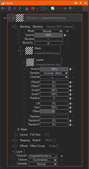

      5. lmask
        1. Mask
          1. LoaderProperty
          2. TextureProperty
          3. a1DGradient
          4. mask

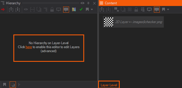

When you select a Layer (just click the Layer), all your editing will be on the Layer Level. This will be indicated inside the Hierarchy- and Content Editor. You can spot a note inside the Hierarchy Editor and a note at the bottom of the Content Editor:
Layer Level Editing makes it possible to bind content nodes to layers. That gives you the freedom to control the layer properties and exposed properties from inside the layer on a layer level. You can use any content node inside the Content Editor. That makes it possible to have Layer to Layer bindings or control different kind of layers by multiple selections and distribute values across them.
When you select a layer, the Properties Editor will show the exposed default properties. You can gain access to more layer-specific properties by clicking the pencil on the left to the selected layer and then click the Layer Root Node inside the Content Editor. The Screenshot shows, for example, the 2d-Movie Layer with the enabled Layer Editing Mode and the Movie Clip Node which connects to the Movie Layer Root Node. To have full access to all available Movie Clips related properties you would need to click the Movie Clip Node in the Content Editor. The Properties Editor will then show ALL Properties available.
You can also create Logics inside the 2D-Layer. You simply click the pencil in front of the 2D-Layer and can create any kind of logic inside the Content Editor Area then.
All 2D-Layers share the same Common Layer Properties like Blending, Layout and so on, which will be explained at the bottom of this page.

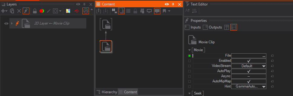

Movie Clip Layer
With the Movie Clip Layer you can easily load a movie and have it as full-screen. When using a Movie Clip Layer it will not be affected by the multisampling or antialiasing set in the Ventuz Config. When selecting the Movie Clip Layer the Layer Properties will show you some default properties like Audio, Volume the controls to Loop, Restart, Play, Pause to change the Orientation and to select the File. You can load a movie also by clicking the Layer Thumbnail, both will bring up the Windows File Browser. Additionally, you can choose to load a movie as a reference, this can be enabled by using the "Reference" checkbox in the File / Load dialog:
Also under Control you can find the Control Property which can be bound to a Keyframe Animation node to control the playback in the time-line of the Animation Editor.
To access all properties of the Movie Clip Layer node, use the Layer Edit Mode and select the Movie Clip Node inside the Content Editor Area.
In the lower part of the Properties Editor you can find a custom verb which is called Configure. You can configure Movie Clip related options like the Buffers.

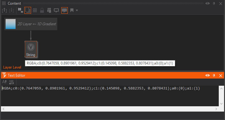

By using a Convert To Text Node you can also dynamically build your own gradient to which you can bind the Gradient Property. The markup for the Expression is as follows: RGBA;c{0}:({1}, {2}, {3});c{4}:({5}, {6}, {7});a{8}:({9});a{10}({11}) This defines a Gradient with two keys for each, color and alpha. The range of all variables is from 0 to 1 The meaning of the different variables is shown in the following table:

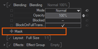

Blending

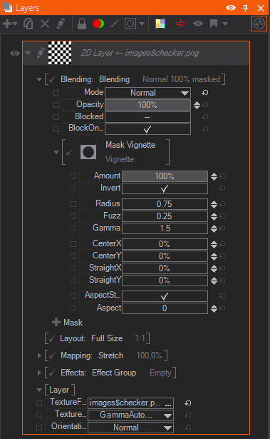

Blending operations, including modes, opacity and masking, can be switched ON or OFF for each individual layer by left-clicking close to the Blending caption. If the check mark appears, the blending operation, including opacity, mode and mask, is calculated for the current layer. If the check mark does not appear in front of the Blending options, the blending operations are not calculated.
As with all Layer Properties, in order to expand the Blending Options, click on the little arrow. A dropdown list of the supported blending modes will appear:

Layer Mask
Layer Masks allow isolating certain parts of the layer to be used for the final composite. In general, Masks use the color or alpha information to decide which image pixels will be transparent, translucent or opaque.
  • Pixels which are 100% white in the selected channel will result in opaque areas of the layer.
  • On the contrary, pixels which are 100% black in the selected mask channel will be considered as transparent and therefore these areas of the current layer won't be shown in the final composite.
  • All the gray tones between black and white in the selected mask channel will result in different levels of translucency in the areas affected.
Ventuz features three type of masks by default: Mask, Vignette and Border. You can add as many MaskStages as you want.
You add a LayerMask if you click Click  on the [+] Mask like shown on the Screenshot, and select Mask or any type of Mask Vignette / Mask Border from the dropdown menu.
Mask
Mask Property uses a texture source as the mask. When adding a mask, a new thumbnail will show the Mask appearance is added to the Layer properties. Right Click on the Mask or click the triangle in the front to bring up the properties for the selected Layer Mask.
In addition, when you hover over a Layer Mask, the two arrows on the right-hand side, pointing up and down, allow for a reordering of the masks if there are more than one. The little X close to these arrows is used to delete each mask individually.
Unfold the Mask Properties and per default the TextureLoader will be shown as well as the Mask Properties.
Loader Property
Loader Property shows a list of internally available images, by default it loads an internal checkerboard image. These images are installed by the Ventuz installer per default, so they are available for all users and projects.

1D Gradient
Opens the Ventuz Gradient Editor to create a Gradient image that will be used as a Layer mask.
Mask Properties
For any of the above loaders, you can adjust the Amount which controls the Mask Opacity, the Sampler where you can select the filtering to be Trilinear and Adress the Border behavior. Click the Sampler and the Dropdown Menu offers you following Options for the Border Behavior:
Black: The pixels outside the area covered by the mask are turned black, meaning that there is no tiling.
White: The pixels outside the area covered by the mask are turned white, meaning that the area outside the original mask image is totally opaque.
Clamp: The pixels outside the area covered by the mask will repeat endlessly the same values as the pixels in the original image borders.
Wrap: The pixels outside the area covered by the mask are repeated or tiled as they were in the original mask image.
Mirror: The pixels outside the area covered by the mask are repeated or tiled as they were in the original mask image, but inverted like a mirror effect.
With the Channel Drop Down Menu you can select which channel should be taken for masking. The Luma (L) is the default and uses the external image Luminance as a mask, it converts the image internally into a Grayscale Image. You can select an explicit channel like R,G,B or take the Alpha as the Making source. With the Invert the source image or selected channel gets inverted.
You can Offset X/Y, Scale X/Y and change the Rotation of the mask. New pixel values are interpolated using the options selected in the Sampler dropdown menu.
The Lift, Gain and Offset can be used to do a color grading for the Mask. The values are conformed with the Standards used in the cinematography. Lift can lift up the lower colors, while it clamps also the lower color area. E.g. if you lift a dark image, lower colors gets cut off, instead of starting at 0-255, it will start with 30-255. Gain boosts the colors in the whole range, while bright pixels may also clip at 255. Offset moves the colors in respect to each other color values. It behaves like a shifting.
Random will position the Image randomly on screen and the amount of this randomness can be controlled with the Random X/Y. The Image will be positioned to a different position for every Tick, therefore you can not control the speed.

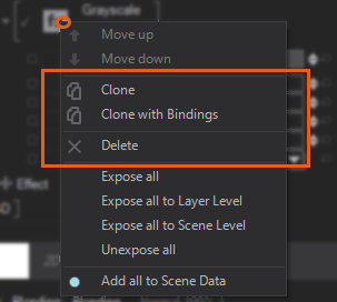

For effect stages you can clone or clone with bindings.To do so Hold Right Click Hold  on an effect stage for a second and a menu with these options will show up.
