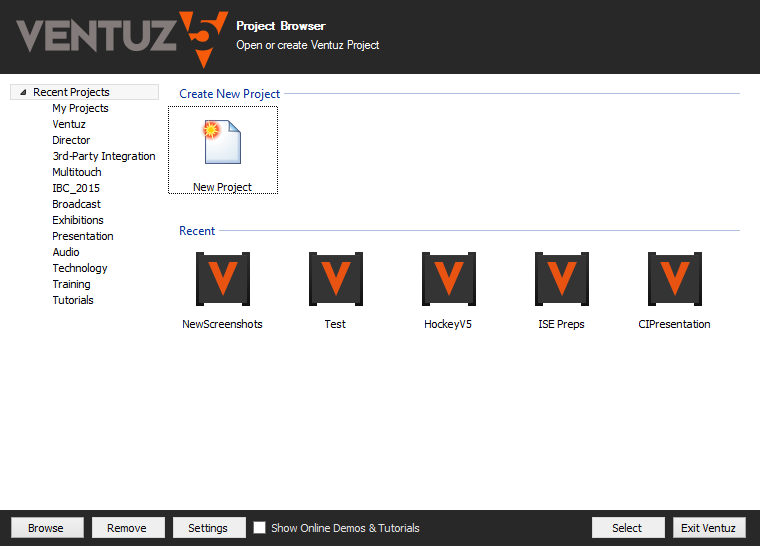

One of the most important things to understand when starting to work with Ventuz is how the generated content will be organized and why. Upon starting Ventuz, the Project Browser will appear as the very first thing:

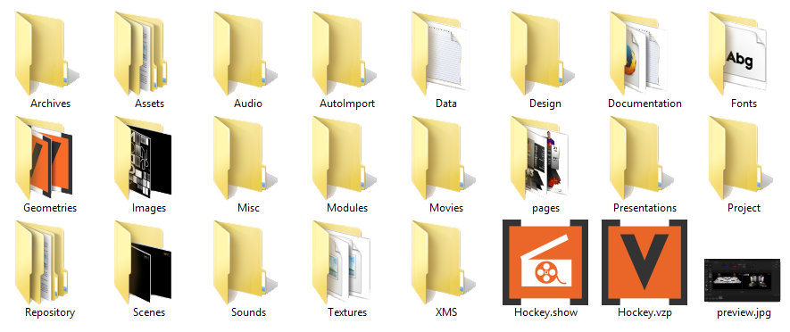

A Project is a collection of assets (such as images, audio files or geometries), scenes and a single project file with the extension .vzp. The assets are grouped into different data pools where each data pool has its own folder in the file folder structure inside the project folder itself. If an asset outside of the project is used in a scene, it will be imported into the project unless it is specifically marked as an external reference.
As an example, let us assume there is a conference with multiple speakers or topics. Each scene will be used for a single presentation but all of the presentations will probably use the same font, background and so on. Hosting the assets inside the project instead of the scene allows for reuse and thus saves both disk space and memory.
Another way to think of a project is as a working folder. Instead of searching for specific images all over the computers hard disk, they are imported into the project and thus everything relevant is in one place. A project folder can be compressed and moved to another computer without compromising integrity as scenes only reference assets within the project folder (unless specifically told not to).

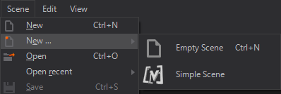

There a two ways to create a Scene.
  • The first one is to create a new blank scene by selecting New from the Scene Menu. In an empty scene everything has to be build from scratch.
  • The second way is to use the Create Scene Dialog by selecting New... from the Scene Menu or by clicking Create Scene in one of the Editors when no scene is open. The dialog will ask for the type of scene to be created. Scene types displayed in the dialog are either internal scenes (Standard) or scene-templates located in open Repositories.

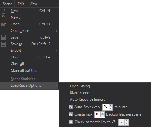

Ventuz provides a system to minimize the damage of unexpected application crashes and to keep track of scene file changes. To enable this system, open the Scene Menu and select the Load & Save category. There you find the AutoSave and the Create backup files option. The AutoSave mechanism will periodically save the current state of the open scene to the Scenes.revisions folder. The scene is saved under its current name with additional .auto extension.
The backup mechanism works as follows: every time a scene is saved (under the old name) by the user, a copy of the old scene version on disk is saved to the Scenes.revisions folder with an additional extension ####.bak. #### represents a number between 0000 and 9999. This number is increased with every new save operation. If the maximal number of backup files is reached (as configured in the Load & Save Options) the oldest backup file (with the lowest index) is deleted before a new backup is created.
To open one of the Backup files or the AutoSave file open the Open Scene dialog and choose the desired scene version in the Revision drop-down box at the bottom of the dialog. Note that if such a backup scene is saved in the Designer, it is saved under its original name in the Scene folder - this does not overwrite the backup file!
Ventuz scenes themselves are generally not very large, even with a large number of nodes. Because the backup files do not need to include the assets, but only the scene itself, it is possible to have a significant number of automatic backups without using too much hard disk space.
