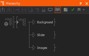

Another common theme when designing complex presentations is that there is some semantic structure to the scene. There might be a certain subtree of the scene that is responsible for presenting the user interface, another for talking to external devices, yet another for rendering a collection of images. Having all of those nodes in one visual space is not only confusing but outright unnecessary.

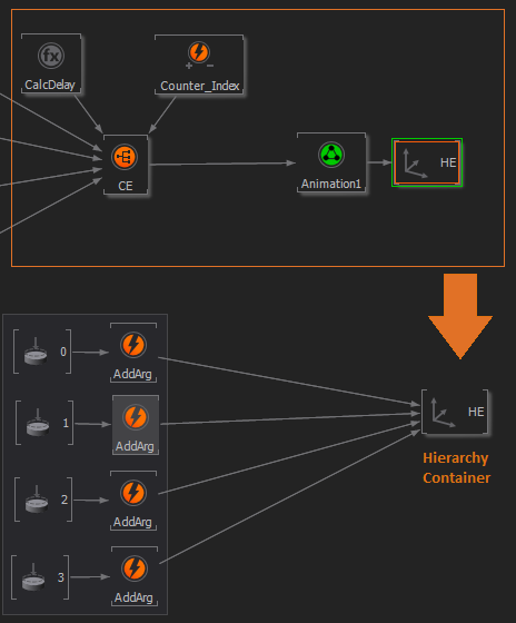

In both cases, Container Nodes improve productivity as they enable the author to combine nodes to a new customized type of node. Picking up on the UI button example above, a button may require a geometry, multiple textures, keyframe animations and much more. All of those nodes can be put into one container, thus having the container act as a single node representing the button. The individual nodes are hidden from the main hierarchy level making the scene easier to understand and instead of duplicating the subtree, only the "button node" needs to be duplicated.
A new container is created in the same way as all other nodes, by dragging the Hierarchy or Content Container to the respective part of the scene. Since this is a very generic node and a scene often contains different containers, it is advisable to give it an appropriate name right away by double clicking on the name of the node. It can even be assigned a new icon by selecting the node and then choosing Node/Icon/Open in the main menu bar. Nodes can be added to a Container by cutting them from the hierarchy, navigating into the Container and then pasting them or just create them inside the Container directly.

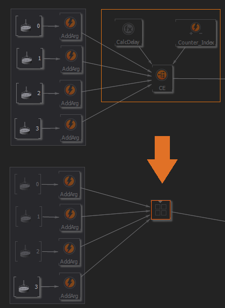

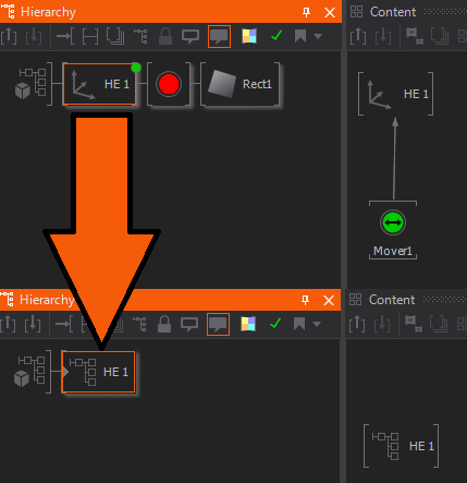

An alternative way is to select a node and then use Node/Merge To Container from the main menu bar. This will replace the selected subtree with a container and place the removed nodes inside the container.
Next to merging a selection to a Hierarchy Container it is also possible to merge content nodes to Content Container.
There are basically four different ways of merging:

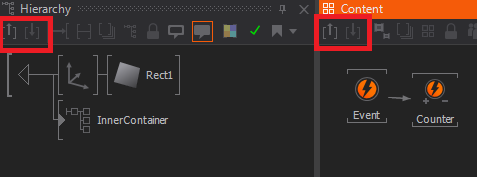

All container nodes can be easily recognized by their gray triangle on the left inside of the node icon. By double clicking on that triangle or pressing ENTER, the editor leaves the current hierarchy level and switches to the inside of the container. When inside a container, the starting point of the hierarchy is not the familiar scene root T-junction, but the container root, a white triangle. Double clicking on that icon or pressing BACK takes the Hierarchy Editor out of the current container. You can also use the Container Level Up Button or press CTRL + U and Level Down Button or CTRL + D to navigate through the container levels. Pressing inside the Hierarchy Editor will display a popup window with the Hierarchy Container structure of the complete scene. This overview can also be used for navigation; just click on the desired container. A very comfortable way to enter and leave containers is to use the click

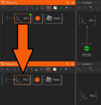

By default, a Hierarchy Container is created with one Output Node already inside of it. An Output represents a connection back up to the parent hierarchy level and allows nodes or subtrees to be placed behind the Container.
Inside the Container, the Output nodes represent all nodes behind the container on the parent level. This can be used to encapsulate some functionality inside a Container while leaving a degree of freedom to the user of the Container. As an example, consider someone constructing an animated picture frame inside a container. All the geometries, textures and so on that directly contribute to the frame are inside the Container, but the content that should be rendered inside the frame are kept out of it. This improves reusability and avoids forcing the user to step into the container every time the framed content is to be changed.

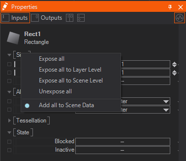

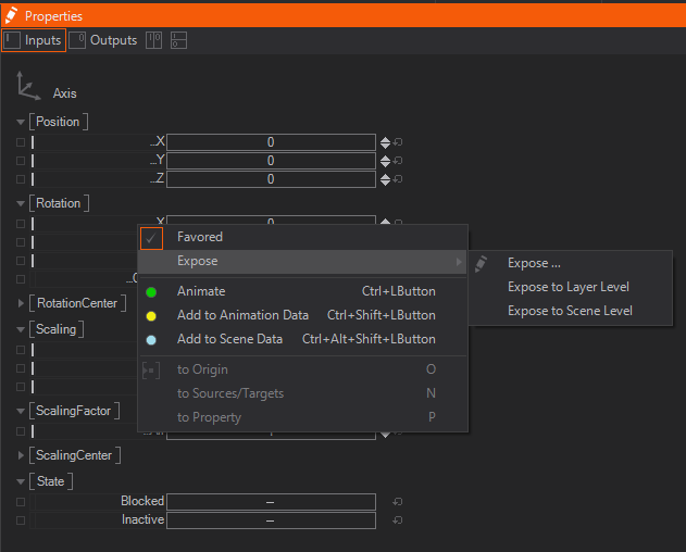

Any input or output property of a node inside a Layer or Container can be made available on the outside as a property of the Container itself by exposing it.
To expose a property, click on the name of the property in the Property Editor and choose Expose/Edit... from the appearing context menu. The name and category of the property, as it appears on the Layer or Container, can either be kept the same as on the original node or be reassigned in the dialog that opens. Press OK and the square to the left of the property name will change to green, symbolizing that this is now an exposed property. Note that exposed property names have to be unique within a container. Exposing two properties with the same name will not only confuse other Ventuz operators but can also disrupt the binding logic.
Since Ventuz 5 we introduced a new level in the Scene with Layers. To make exposing a little more handy properties can be exposed to Layer Level or Scene Level directly from the context menu. Pressing the on a category also allows exposing all properties inside that category to a certain level in the scene or to Scene Data to control them from Ventuz Director.
Exposed input and output properties of a Layer or Container can be seen either when selecting the node on its parent level or by going into the Layer or Container and deselecting everything.
To quickly expose a property without changing its name or category, click the small square to the left of the property. To quickly hide a property, click on the square. A double-click will bring up the Expose dialog.

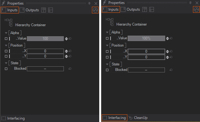

Interfaces are an extension of the Container idea to address the above, and other, problems. They define which properties a Container has to provide in order to be used in a certain part of the scene. A Container Interface keeps its properties (and therefore its bindings as well) intact even when the encapsulated nodes are removed. When the content of a container is replaced, new exposes can fulfill the interface properties.
To define an interface, a Container with exposed properties is required. When selecting the Container, an "Interface" button appears at the bottom of the Property Editor. Press it and the container is upgraded to an Interface Container, which is visualized by two lines that close the gap in the brackets that surround the node icon.
When changing a Container to an Interface Container, all exposed properties become interface properties. The difference between them is that interface properties remain defined on the interface even when the property is no longer exposed. All properties exposed after that automatically become interface properties as well.
When removing a node that exposes a property, the interface property stays intact but is visualized in a light gray color. To remove an interface property definition, either double click on the interface property and press Exclude or use the CleanUp button at the bottom of the Property Editor to remove all interface properties without an corresponding exposing node.
Interface properties can be recognized by the thicker stroke around the green "exposing square" (when the exposing node is selected) or the thicker stroke around the property (when the container itself is selected). One has to be careful not to confuse what level of exposing one is currently looking at.
An interface property that is disconnected from its exposing node keeps its last valid value.
To expose a property to an existing Interface Property, click and select the desired interface property under the Expose... menu or click on the small square to the left of the property to pop-up a choice of existing interface properties. Please note that only interface properties of the correct type will be listed!

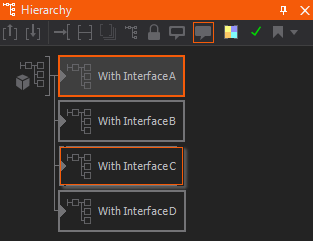

When using drag & drop with an Interface Container, all containers in the scene with an interface defined are highlighted with a dark gray border. When dragging the selected container over such an interface container, the target's border changes to red. Releasing in this state will not remove the original node but replace the targets content with that of the source node. The same behavior is achieved by using Edit/Copy and Edit/Paste Container Content from the main menu.
