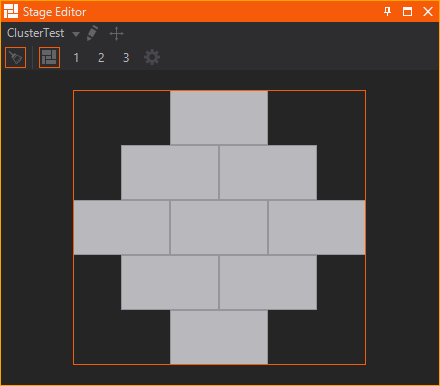

Building a Display Wall

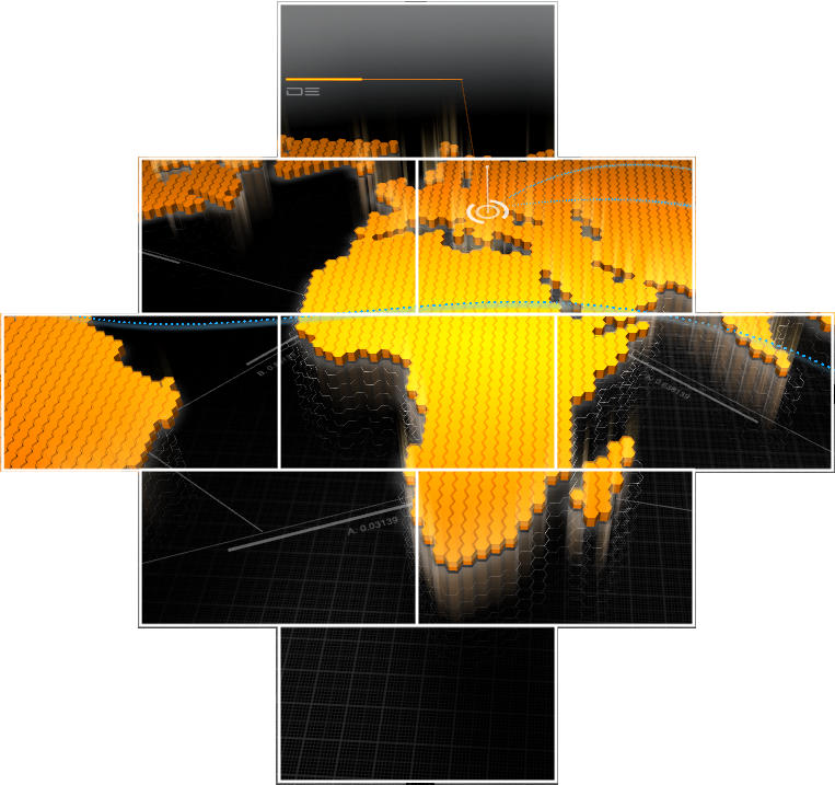

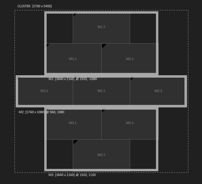

The goal of this section is to setup a cluster wall of 9 displays arranged as a rhombus. The cluster should consist of three machines with three outputs each. We will assume for this example that the displays are bezelless. Each display has a resolution of 1920 x 1080. The final wall with Ventuz content on it could look like this:
Creating a Render Setup
First of all you have to create the appropriate Render Setup configuration. Open the Ventuz Configuration Editor and select the participating machines by selecting their common group in the dropdown in the top-right corner of the Configuration Editor.
If the machines for the cluster are already available in the network, it is important that they use the same non-zero Group ID and each machine has an ID starting from 1 for the first machine, 2 for the seconds, etc. If the machines use multiple outputs, you have to configure the graphics driver to treat them as one logical output. NVIDIA calls this ​Mosaic technology, AMD calls it ​Eyefinity. Log onto those machines and use the appropriate tools of the graphics vendor (e.g. NVIDIA Control Panel or AMD Catalyst Control Center).
After the machines have been pre-configured correctly, select the group in the Machine Selector and add a new Render Setup by clicking the Plus button. Choose a sensible name and click OK. This will open the Render Setup Editor with the display configuration of the connected machine or group of machines which is currently active in the Graphics Driver. The initial Render Setup we need is a 3x3 display wall with three machines of 3x1 displays.
If you want to create a Setup without being connected to the real cluster machine, launch the Create New Setup dialog and select the Advanced tab. Displays Total must be set to 3x3; fill in the correct resolution and increase the Num. of Machines to three! Make sure that Displays per Machine is set to 3x1 (an arrangement of 1x3 would be possible but would not give the optimal result). The display position of the upper and lower machine have to be modified to get the required arrangement. Do not forget to save the final result!
The Visual and Logical Resolution per machine is limited to 16384 x 16384!
Save the new Render Setup as the the active configuration in the Ventuz Configuration Editor. Every time Ventuz starts it will automatically use this configuration for rendering! Depending on the ID of the machine the correct part of the setup will be rendered. The ID 0 will render the Cluster Preview. The Machine ID can be adjusted on-the-fly via Live Options.
Deleting displays or display fragments in the Display Editor will not change the basic physical configuration of a Render Setup. The deleted display just won't receive the Ventuz scene content and keeps the default content which is in most cases just black. It is not guaranteed that this content is initialized in memory however! E.g. a 4x1 display setup with deleted right display does NOT result in the same Render Setup configuration as a new 3x1 display setup! The initial Render Setup must always match the physical display configuration (AMD Eyefinity or NVIDIA Mosaic) of the according machine.
Note that changing and saving the active Render Setup configuration on a Machine with running Ventuz will instantly affect the render output!

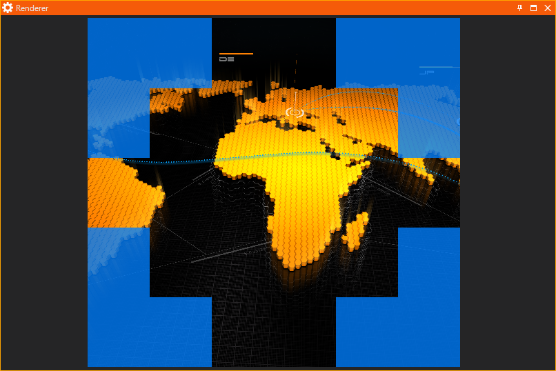

The scene from the wall will look as follows in the Renderer window of Ventuz Designer. As Ventuz can only render rectangular areas it applies a mask in the preview modes (Cluster and Machine Preview) to mark the render content which will not be visible in the final Production Mode when running in Ventuz Runtime.
Render Setup Modes
There are three different rendering modes for Render Setup rendering available:
  • Cluster Preview: This is a simulation of the whole Cluster with arbitrary number of machines and displays. Areas which will not be visible on the physical wall can be masked with a customizable color and alpha value. These values can be set in the AV Configuration or in the Live Options if Ventuz is already running.
  • Design Preview: This preview mode is a per-machine preview. In a multi-machine setup Ventuz will only render the content of the selected machine.
  • Production Preview: This mode is not suitable for designing a scene. It is the mode which will be used by Ventuz Runtime to render the final content. As displays may be physically moved the render output is not necessarily continuous.
The last two modes are pretty handy if you want to see whether your scene is well prepared for a multi-machine rendering or not. The rendering mode can be changed in the Stage Editor by clicking on the display arrangement preview at the bottom of the Stage Editor. Click on a single highlighted machine or the border of the whole cluster to switch between Machine and Cluster Preview. To switch to Production mode use SHIFT -  click.
As the rendering mode is linked to the Machine ID it can also be changed in the ID drop-down box of the Stage Editor. To get a aspect-correct rendering make sure that Format settings in the Project Properties match the aspect of the whole Cluster. The Stage Editor provides a shortcut to adapt the Format to active Cluster configuration: just click on the cross in the toolbar on top.

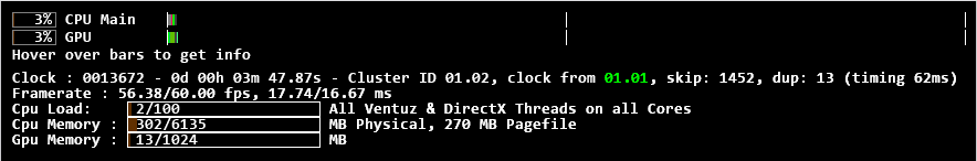

When activating the statistics in your render window, you will notice some additional information:
Cluster ID 01.02 means that this machine has the Group-ID 01 and the Machine-ID 02, the following number shows the current value of the cluster clock, and the clock from 01.01 indicates that the current clock master has Machine-ID 01. On a slave system the type of the cluster clock is colored green, on a master system it is white.
A font color change on a slave system from green to white indicates that the slave has lost its master clock and is running independently. Make sure that your slave systems show a constant green writing without any flickering between green and white.
There is one unique feature for Nvidia in synchronized cluster setups. When using a Nvidia framelock setup with enabled Swap Sync, it is possible to get the timing for the Cluster Clock from the synchronization board. Since this is not based on a network protocol, this is even more precise. In this case the digits that represent the clock master in the statistics show FL (Framelock). Read more about synchronizing a cluster below.

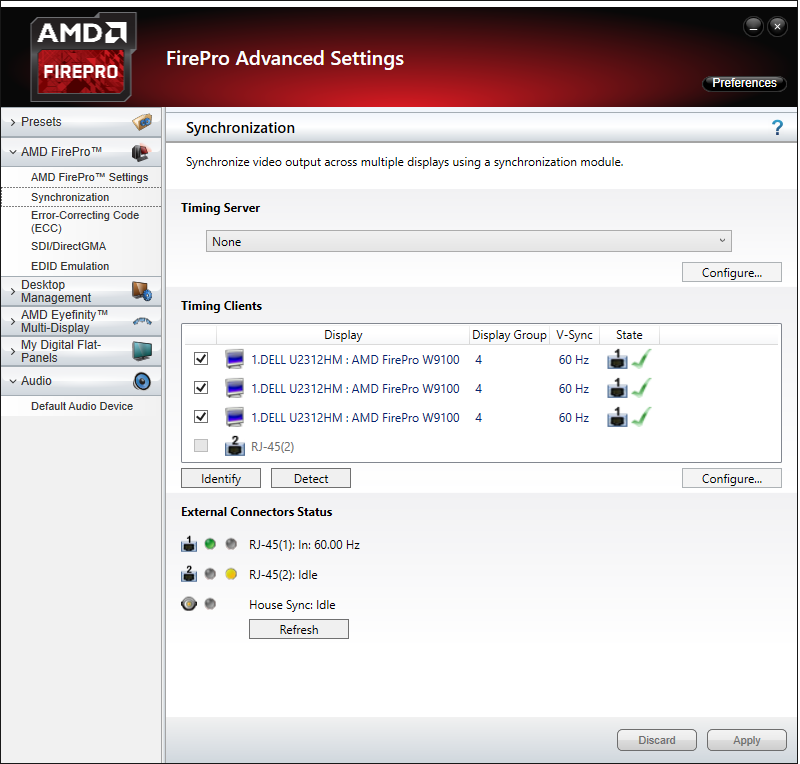

To synchronise your cluster outputs, install a synchronization board to every machine in your cluster, following the manufacturers instructions.
Go on with connecting the boards. Every sync board has one BNC connector for an external timing source and two RJ-45 connectors to connect the sync boards among each other. Be aware that the RJ-45 are only for connection between the sync boards. Do not connect them to a usual Ethernet as this can cause damage to the boards. So have a look at the image below. The connection between the sync board is independent from the Ethernet connection.
To synchronize the cluster, one machine acts as the timing server, the others as clients. For Framelock applications, the timing server uses an internal signal as timing source. For Genlock applications, connect an external timing source, e.g. the house sync, to the timing server via the BNC connector as seen in the image above.
The machine that acts as the timing server uses both of its RJ-45 as outputs to distribute the timing signal. A client uses one as input and the other one as output, so the signal can be passed to another client. It is recommended to split the clients in two equal groups and arrange each group as a daisy chain connected to one of the two timing server outputs.
Next, configure the timing master and client in the graphics card driver. See your graphics card manual for details. Below is an example screenshot for a four display machine set up as timing master. Configured in AMD Catalyst Control Center. The timing signal comes from an external sync generator.
Here an example to synchronize two machines where the left machine is the timing master. This configuration is crucial if you want to use Swap Sync in Ventuz!
For detailed information on how to set up the synchronization boards, refer to the manufacturers documentation.

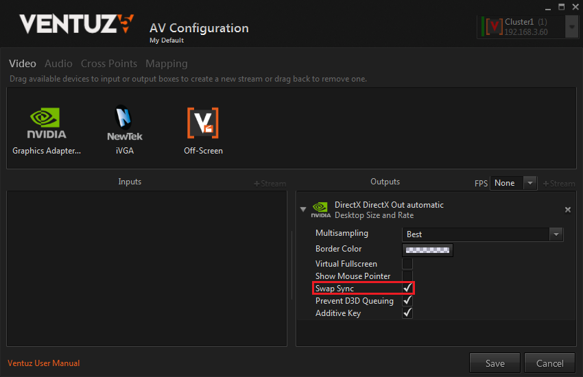

Enable Swap Sync
So far we aligned the displays refresh rates to a common time source, be it internal or external, to avoid tearing or flickering. This was done in the graphics card configuration. As described above, Swap Sync requires support by the application - Ventuz in this case. To enable swap sync, move to the DirectX Output of the AV Configuration.
Be aware that Swap Sync only makes sense and only works if the synchronization boards are configured correctly.
Note that Swap Sync only works in exclusive fullscreen mode!
