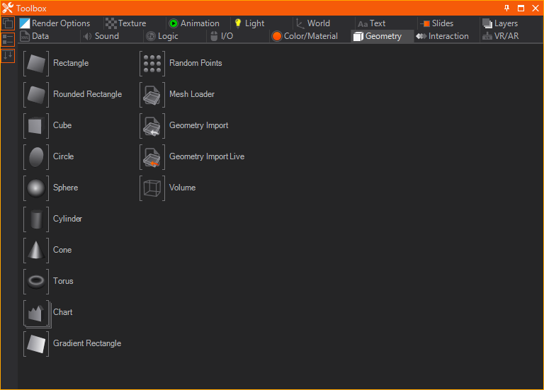

The Toolbox contains all the Nodes that ship with Ventuz. Each node is either a Layer (brackets in all corners), a Hierarchy Node (brackets to the left and right of the icon) or a Content Node (brackets at the top and bottom of the icon) and belongs to exactly one category (i.e. World, Interaction, ...). Some of the entries shown in the Toolbox represent more than one node which is visualized by lines to the lower right that represent a stack underneath the icon. click on those entries will show all nodes that belong to that set of similar nodes.
A node can be added to the scene by dragging it from the Toolbox to the appropriate editor, depending on the node type (Layer, Hierarchy or Content).
For some nodes, such as the Text node, dragging the set representative into the scene will activate a wizard that will ask for the desired provider type at the end of the drag & drop operation. The wizard will then create additional nodes which are necessary for correct operation. This is different from right-clicking the set representative and choosing the specialized node, which will only add that one node to the scene.
