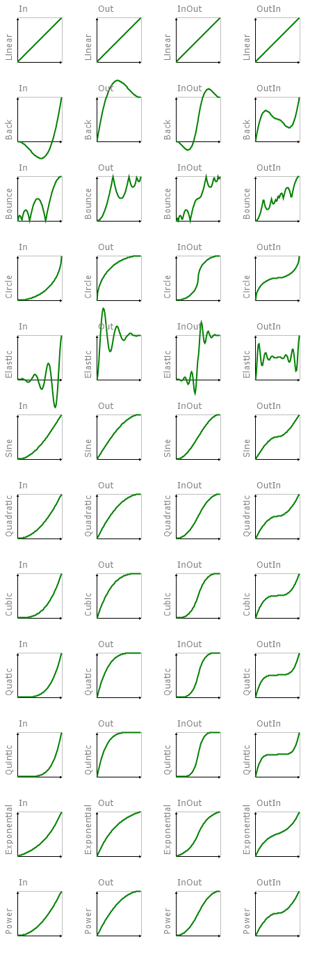

Ease
The Ease node is similar to the other interpolation nodes in that it performs an interpolation by the well known easing functions like Back, Bounce, Elastic, etc. The Function and Mode properties select the easing mode and interpolation type. Some easing functions require additional parameters. If such a function is selected the required parameters show up in the Property Editor while others are hidden.
Overview of all supported easing functions:
  • Linear: Linear interpolation. (like the Linear Node)
  • Back: Retracts the motion slightly.
  • Bounce: Creates a bouncing effect.
    • Bounces: Number of bounces. Default is 3.
    • Bounciness: Specifies how bouncy the bounce motion is. Default is 2.
  • Circle: Creates a motion that accelerates and/or decelerates using a circular function.
  • Elastic: Creates a motion that resembles a spring oscillating back and forth until it comes to rest. (like the Oscillator Node)
    • Oscillations: Number of times the target slides back and forth over the target. Default is 3.
    • Springiness: Number that specifies the stiffness of the spring. Default is 3.
  • Sine: Creates a motion that accelerates and/or decelerates using a sine formula.
  • Quadratic: Creates a motion that accelerates and/or decelerates using the formula f(t) = t^2.
  • Cubic: Creates a motion that accelerates and/or decelerates using the formula f(t) = t^3.
  • Quartic: Creates a motion that accelerates and/or decelerates using the formula f(t) = t^4.
  • Quintic: Creates a motion that accelerates and/or decelerates using the formula f(t) = t^5.
  • Exponential: Creates a motion that accelerates and/or decelerates using an exponential formula.
    • Exponent: Exponent used to determine the interpolation. Default is 2.
  • Power: Creates a motion that accelerates and/or decelerates using the formula f(t) = t^p.
    • Power: Power value p. Default is 2.
