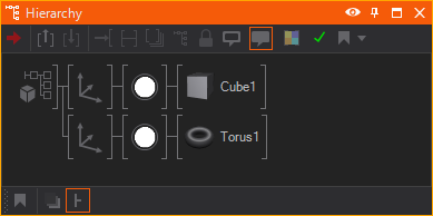

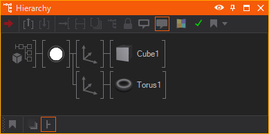

The following basic examples show two different possibilities to build scene trees in the Hierarchy Editor which result in exactly the same rendering output, but are different in terms of performance.
The first hierarchy applies a separate Color node to each geometry. But this is not beneficial because it is the same for the geometries. The better way to build such a scene is shown below.

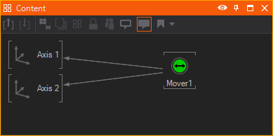

The same principle applies to Content nodes which provide values or resources to Hierarchy nodes. If an Axis node receives values from a Mover and the Axis is copied normally, the Mover will be copied as well. But if the parameters of the second Mover remain the same, it is dispensable because the second Axis could receive its values from the first mover:
In such cases do not use the regular copy [CTRL+C, CTRL+V] but the so called reference copy, as described in section Moving and Copying, to decrease the time it takes to build the hierarchy. This will save memory and speed up validation time.

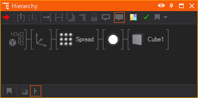

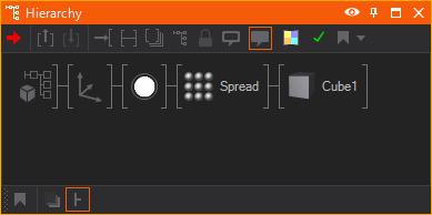

There are two very important points that have to be considered with the use of the Spread nodes. Disregard may cause critical performance penalties. The first point concerns the tree in the Hierarchy Editor. The Spread node duplicates every subtree that is linked to it. To avoid unnecessary duplication of nodes, the subtree should be reduced as far as possible. The following screen-shots show a bad and a correct use of the Spread node.
In the first version not only the Cube is duplicated but also the Color node. This is unnecessary because the Spread node does not affect the Color node. All duplicated copies remain the same. This way every copy of the Cube node creates one more unnecessary node which only consumes memory and reduces the scene performance. The correct use of the Spread is shown below. Only the Cube is duplicated because the Color is applied to any copy of the Cube anyway.
