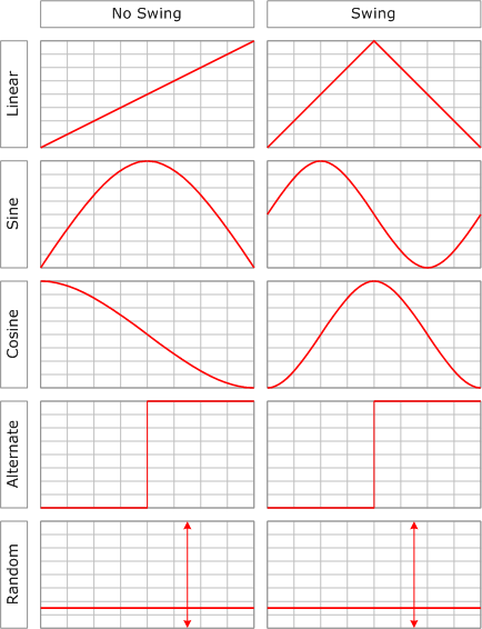

Function defines the mathematical function used by the Mover to calculate the values in one period. The duration of a single period is defined by the Duration property. The Sine and Cosine functions result in smooth ease-in and ease-out animations. The Linear function produces constant animations, whereas the Alternator mode switches between Min and Max values. The Random function produces random values within the specified range - one new value in each period.
Enabling Swing will produce a continuous and smooth curve. In the modes Alternate and Random the Swing property has no effect.
Immediately upon completion of one period, the OnRepeat event is fired and a new period begins. If the mode Random is selected the randomness can be controlled by the Seed property. If Seed is set to 0 the random value sequence will be always a different one. If Seed is not 0 the random sequence will always be the same for all Movers with the same Duration, Min and Max values. This e.g. makes it possible to get same random sequences across multiple machines in a Ventuz Cluster.
