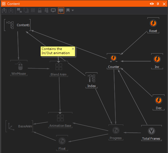

As opposed to the Hierarchy Editor, the Content Editor visualizes its content as a network of nodes rather than a hierarchy. There is no defined order in which information travels along the bindings. Instead, the validation mechanism inside Ventuz ensures that all nodes are correctly updated before rendering starts.

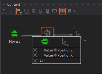

Two nodes are connected by a line if at least one property of one is bound to a property of the other. The binding relationship can be bidirectional in which case both ends of the line have an arrow head. To remove a binding, click on the line and a list of all bound properties opens. By selecting one of the entries, the respective binding will be removed. To remove all bindings of a node, select the node and press SHIFT + DEL or select Unbind from the Edit Menu.

The position of the individual nodes can be arranged by the user by clicking  and dragging nodes. Each node can be assigned a name by double-clicking on the node name or pressing F2. As with the Hierarchy Editor, parts of the network can be collapsed by clicking  on a node. To reach the Context menu, press and hold  for a few seconds.
Nodes displayed in the Content Editor can be grouped into Content Families to assure the relative positioning of the nodes in such a Family and to visualize a functional relationship. Select some nodes with the rectangular selection or by clicking on nodes with a pressed SHIFT. Pressing CTRL + SHIFT + F will create a Content Family for the nodes and visualize this with a gray rectangle around them in the Content Editor.
