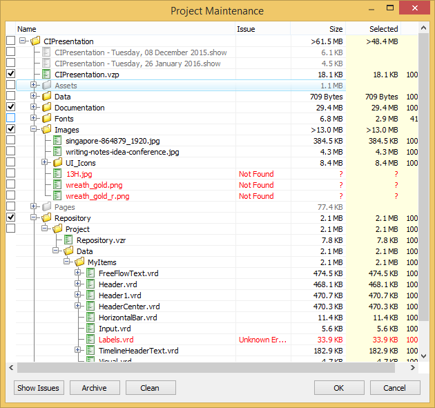

The Project Maintenance dialog provides possibilities to clean up and archive a complete Ventuz Project with all related files and folders. Furthermore it can be used to inspect the consistency of a Project. Currently there are two possibilities to start the Project Maintenance dialog: via Context menu of the Project Browser and the Maintenance and Export entry in the ProjectsName menu.
The dialog shows nearly all files and folders within the active Ventuz Project folder structure. There are some filters applied to the file scanning process so that some types of folders and files are not displayed and thus excluded from the maintenance functionality. For instance the Project folders Archives, Presentations, AutoImport and XMS and different kind of version control related files and folders (e.g. Subversion or Visual Source Safe) are excluded. The Project files and folders are displayed in a tree structure with additional status entries per item. Every item has a check box on the left side to allow the user a modification of the selection status. The Issue column contains errors and information. The Size column displays the size of a file or complete folder on disk. Selected displays the size depending on the item selection and % is the ratio of both values in percent.
If the dialog is launched for the first time for a new Ventuz Project, it comes up with a default selection. The Scenes, Repository, Documentation folders and all Project (vzp) files are pre-selected. If the user modifies the selection and closes the dialog by clicking the OK button, the active selection is saved to the export.xml file which is located beside the according Project file. This export.xml file is also excluded from the maintenance and is neither cleaned up nor archived.

If Show Issues is pressed, the Project item tree is expanded to show all existing issues within the Project structure. Errors are displayed in red; warnings and information are displayed in blue. Possible minor issues are:

To find out which scene or repository item references a resource click  on this resource and a list of referencing items will be displayed. Note that scenes can also be referenced by other scenes and repository items! If an items is displayed with gray text, it is either not referenced by any scenes or repositories or it is explicitly excluded by the user.
Note that URIs which specify an absolute file path and URIs of bound file properties within a scene can not be tracked yet. This can cause Project resources to be marked as not referenced in the Project Maintenance dialog.
