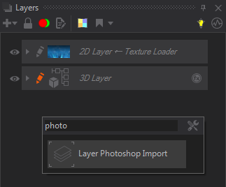

How To Use

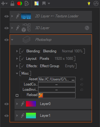

You simply need to add a new Layer of the Type Photoshop Import. It will create a Photoshop Layer Group - a special Layer Group that can read out PSD files and create Layers based on the original layers into that file. For each layer it creates a Texture Layer and copies the Opacity, Blending and Layer Mask to the new layer.
After import the created layers can be edited like any other Texture Layer, and the Photoshop Import Layer like any other Layer Group. Both the PSD Layer Group and the individual layers features thge same properties as any other layer inside Ventuz, they support effects and their layout, blending, etc can be edited like any normal Ventuz layer.
Properties
  • Asset: Here you can define the PSD File you would like to import. After import you will see all layers of the PSD converted into Ventuz Layers. When creating the Layers from the PSD File Ventuz creates Textures with the Pixel Information of each Layer. They are saved as .vzt-Files into the Textures Folder and they can be found in a Folder named ImportedPSD_[File Name]. The properties of the Photoshop layers will be converted into Ventuz Layer Properties as good as possible and can be found in each layer's properties.
  • LoadInvi: (Load Invisible) A checkbox that switches Load Invisible On or Off. When OFF, it will skip any invisible layer while loading the PSD. Only the Visibility Property of a Photoshop layer takes effect on this option - a layer is not invisible when its opacity is zero or when it contains fully transparent pixels only.
  • LoadCo: (Load Composition) A checkbox that turns Load Composition On or Off. When ON, an extra layer with the result of the Photoshop Composition is created inside Ventuz, this is very useful when you need the original Photoshop composition to use it as a reference.
