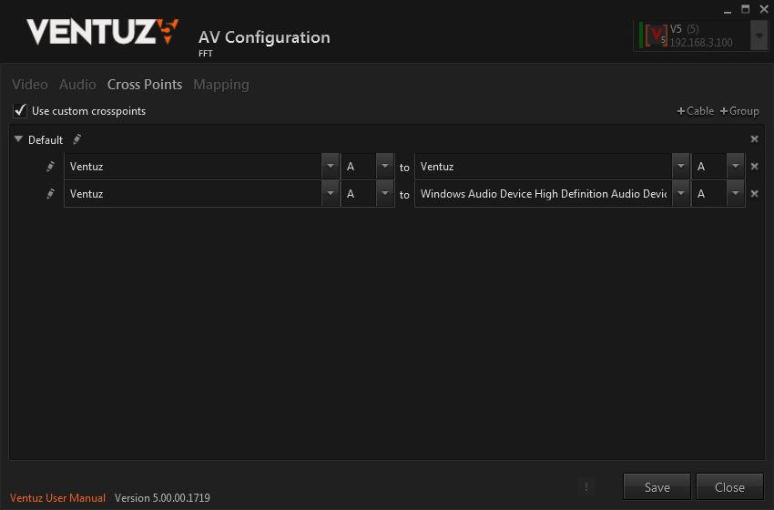

Audio Configuration
To listen to a Ventuz Audio device you have to configure them in the Ventuz Audio Video Configuration. In the Cross Point section you can add and remove virtual audio cables. I.e. you can add a cable Ventuz A --> Ventuz A to listen to the first stereo pair of the Ventuz Audio device.
The first Cable is necessary to make the FFT node listen to audio and sound played by Ventuz. The second Cable is only necessary if the audio should be forwarded to an audio hardware in the Ventuz machine.
