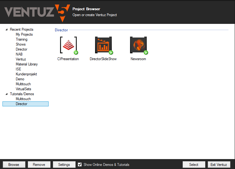

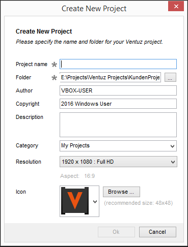

The first thing you'll see after the Ventuz Designer has finished launching is the Project Browser. A project is a collection of presentations (called scenes) that use common resources (Assets) such as images, movie clips and so on. Since you don't have one yet, choose "New Project". Once you have created and used some projects, they will be listed in the "Recent" section of the browser for quick access.
A project stores global information about the project like Project name, Folder , Project Dimension and so forth. Fill out the fields and press Ok to create the project.

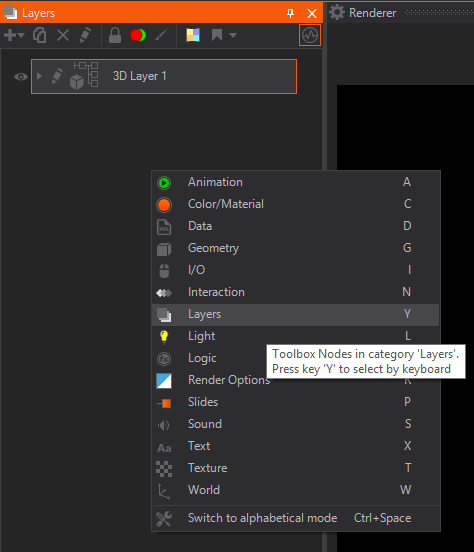

Once you're done, the project will be created, opened and you'll see the Ventuz User Interface which consists of multiple dockable windows. Ventuz automatically has created a new empty scene and since there is nothing in there yet, the render output is black. Let's change that. Hit SPACEto open the Toolbox which hosts all the Nodes that are available in Ventuz or open the Toolbox Window with SHIFT+F6 or just use the Add Layer button in the Layer Editor to add some layer Nodes.
Ventuz also provides different Workspaces that allow you to view and hide certain editors for certain approaches.
Nodes are the building blocks for constructing a Ventuz scene. Each node has a name, an icon and some function it fulfills. There is, for example, a node to create a 2D Image Layer. Click on the Layer tab inside the Toolbox and locate the icon next to the label saying "Image Layer".  Left-click on the icon and hold the mouse button. Continue to hold the button and move the mouse cursor straight up to the Layers Editor on top of it. Release the mouse button and you should see a checker image in the render output. You have added your very first node to a scene. To change the image you can just on the image thumbnail that opens a Fileopen Dialog.

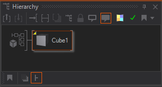

Add a 3D Layer to your scene and press the Edit button. Also switch the Workspace to 'Logic. Again press SPACE to open the Toolbox go to the Geometry categorie and add a Cube node to the Hierarchy Editor
Layer, Hierarchy and Content
The area you dropped the node in is called the Layer Editor, you can consider it to be a layer-based compositing environment inside Ventuz. Every layer now allows you to change the position and size of a Layer inside the Layout section and can be composited with certain Blendings and Effects.
If you are working with 3D Layer and you press the Edit button in the Layer Editor you see an area that is called the Hierarchy Editor. The Hierarchy of a scene is a tree of nodes that define the 3D world. This can be geometry, Axis to position elements, material assignments, and much, much more. You may have noticed in the Toolbox that there are nodes that have brackets to the left and right of the icon and others with brackets at the top and bottom. The former ones are Hierarchy Nodes which belong to the Hierarchy, the latter are content nodes which belong to the Content of a scene. As you can see in the Content Editor (right next to the Hierarchy Editor), the cube belongs both to the Hierarchy and the Content. This is true for all Layer and Hierarchy Nodes.
