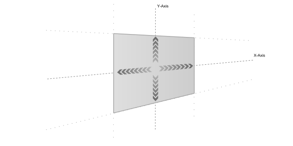

Touch Translation
Use for: Sliders, 2D positioning...
A single touch is used to translate the object in x/y direction. This is usually used with the X- and Y-axis aligned to the screen but rotated version are also possible in order to move objects back and forth in 3D space.
Be careful to have the vanishing points of both axes lie outside the area visible by the camera as mapping calculation close to those points is error prone.
A simple slider can be built by using the Limit input properties to restrict movement in one direction.

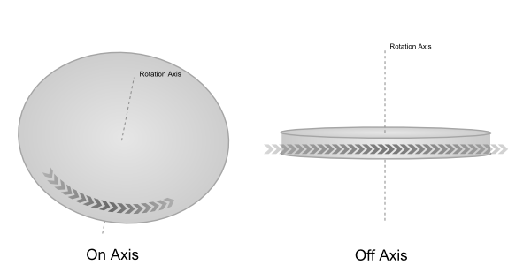

Touch Rotation
Use for: Slot machine style wheels, volume knob style elements, steering wheel, ...
The most important properties for Touch Rotation are the Rotation Axis and the Mapping mode. The on-axis mapping mode assumes that the user roughly looks along the rotation axis onto the top of the object (i.e. a steering wheel or the dial plate on an antique telephone). In this mode, the node will try to follow the touch as closely as possible in order to keep the same point on the surface under the touch position at all times. This makes it possible to do very precise rotations even up to the point where one can do a complete revolution. However, this mode can feel weird if the touch changes its distance from the rotation axis.
The off-axis mapping mode assumes that the rotation axis is at roughly a 90 degree angle to the viewing direction (i.e. a slot machine). When rotating, the object will only stick to the touch position up to a certain point. As the touch gets closer to the boundary of the object, a different mapping is used so that moving the touch further along will keep the object rotating at a constant speed. While one looses the feeling of the object sticking exactly to the finger, this mode feels much nicer when it comes to making an object spin.
Both modes work completely different and which one is more suitable depends on the specific case of usage.

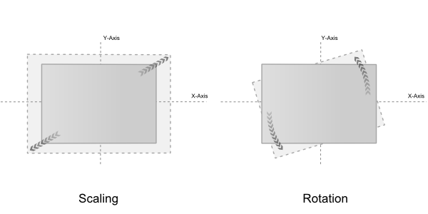

Touch Transformation
Use for: Moving picture metaphor, scaling objects, ...
The Touch Transformation node combines the most common one and two finger gestures to interact with an object. A single touch can be used to translate an object. Two touches can be used to rotate the object (by doing a circular motion), scale it (pinch/stretch), and translate it (by moving all touches in the same direction).
Due to the degree of freedom with this node, there are only few practical use cases for it. Typically, a user will use the Limit properties to restrict movement in one or the other direction. In most cases however, one should try to avoid the use of the Transformation node in favor of the dedicated Translation or Rotation node.
The enabled property ApplyTransformationCenter makes sure that rotation and scaling is applied to the center of the two touches. If it is disabled the transformation is applied to the center of the object.

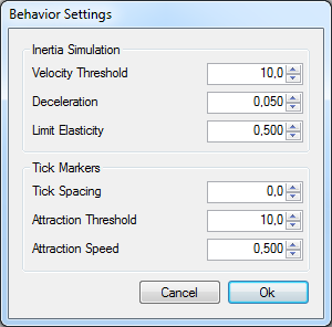

To modify the physics properties of a node, click the Edit Behavior button at the bottom of the Property Editor.

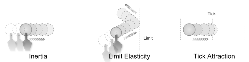

There are three forces that can be applied to the object moved by any of the transformation nodes:
  • Inertia: Kicks in when the users touch leaves an object and the object travels at a velocity higher than Velocity Threshold. The inertia simulation will try to continue the users movement and slowly decrease the objects velocity to simulate the effects of friction. The amount of friction can be adjusted by changing the Deceleration factor.
  • Limit Elasticity: The "bounciness" of an object when it hits one of the limits specified in the nodes properties. When a limit is hit, the velocity vector of the object is multiplied by this weight and then reflected from the limit.
  • Tick Attraction: Defines a uniform spacing of "snap points" called ticks. If the spacing is non-zero, a virtual tick is placed at every multiple of the spacing in the nodes mapping system. When the objects velocity falls below the Attraction Threshold, the ticks apply an attraction force to the object, slowly pulling it until it stops exactly on one of the tick positions. The rate of attraction can be adjusted using the Attraction Speed. For the Touch Transformation node, the TicksAffect property can be used to specify which type of transformation (translation, rotation, scaling) is affected by the ticks.
