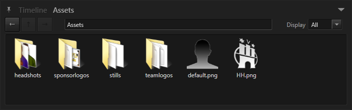

To separate end-user assets from meshes, textures and so forth that are used inside a Ventuz scene and to render the template itself, all assets are stored in the Assets sub-folder inside a Ventuz project. The contents in this folder are shown in the Assets docking window which can be found underneath the Timeline window in the default window layout.
The assets window has been designed to match the standard Windows Explorer and should thus instantly feel familiar to most users. In the image above, it shows the content of the asset folder itself.  double-clicking on any of the folder icons steps into the folder. The three navigation buttons in the top left corner allow for stepping back and forward in the navigation history as well as going up to the parent directory.
The text in the center top shows the current folder name. On the right, you can find the filter for specific file types (e.g. to only show all images). Further options are available when clicking on the docking window options button in the top right corner.
By setting the checkmark of an option, the respective control will be added to the toolbar inside the assets window. The current location and all of the configuration settings are stored as part of the Window Layout. One can also add further windows to have separate docking windows for different types of locations and/or assets. For example, a nice big thumbnail view for headshots but a compact filename list for movies in a certain folder.

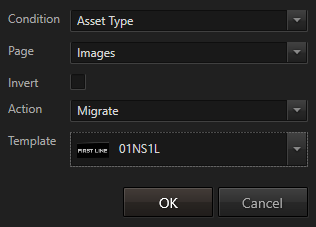

Nonetheless, you can define your own custom Templates that are used instead by creating Channel Rules.
  • Create your custom Template that can handle Assets and therefore has at least one DataItem of the type Asset named Asset.
  • Make sure the Scene hosting the Template is part of the Published Scenes in Director.
  • Create a channel rule for each Asset type that should Migrate to your custom Template.
