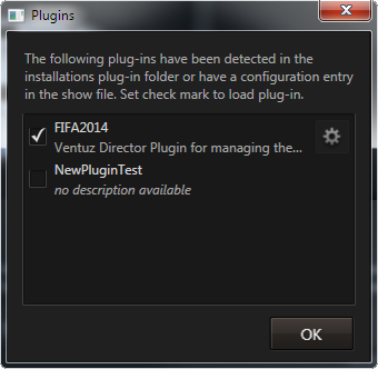

To enable a plug-in's functionality, open the show it should be used in and go to the Plug-ins Manager which can be found in the main menu under Show / Plug-Ins .... Set the check mark next to all plug-ins that should automatically be loaded whenever this show is opened.
In the image below, there have been two plug-ins installed but only the first is activated for the show. The button to the right of the name shows that this plug-in can be configured. By pressing it, the plug-in's configuration dialog opens.
The information which plug-ins should be enabled and their respective configuration settings are stored in the Director show file. To use a common set of settings for all shows based on a project, an operator can embed default settings into the Ventuz Project file via Show / Project / Show Defaults... in the main menu. Those will be used as defaults for each show that is newly created for this project.

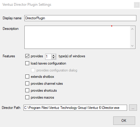

To start a new plug-in, select File/New/Project... from the Visual Studio main menu. If the extension is correctly installed, a new entry Director Plug-In will be available in the Visual C# section and in the Visual Basic section. (This text will choose C# as programming language.) Select this entry, choose a name and location for your plug-in project and press OK. Next, the Ventuz Director Plugin Settings dialog will appear.
Display name and description of a plug-in are end-user information that will be used inside Director, for example in the plug-in manager. They have no relevance for the functionality of the plug-in but make it easier for an end-user to identify and use a plug-in. The set of controls below is for specifying what capabilities the plug-in will support. For this example, create a plug-in that provides one new window type. Finally, to test a plug-in, a Director instance is required. The extension will auto-detect the latest Ventuz installation and use that application path. If for some reason the auto-detection fails or the plug-in should be developed against a specific Director version, the appropriate Director Path can be entered in the first text box.
When pressing OK, Visual Studio will create a skeleton implementation of the plug-in. In our case, it contains the following files:

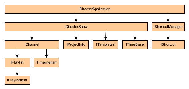

A major portion of a plug-in is of course the interaction of the plug-in with build-in Director functionality like cueing a template or performing a take. As shown in the previous code example, this is achieved via the IDirectorApplication interface that a plug-in is passed as part of the initialize method signature. IDirectorApplication represents the application as a whole and most importantly gives access to the active show in the form of IDirectorShow. The show in turn gives access to the channels in a show, a collection of IChannel instances. Each of those channels has an IPlaylist member, which contains an arbitrary amount of IPlaylistItem.
Furthermore the IDirectorApplication offers access to an instance of the IShortcutManager interface, which itself allows adding and removing of custom key combinations using the IShortcut interface.
The way the interface hierarchy is build directly reflects Director's internal software architecture and should be familiar to anyone who has used Director, although currently only a subset of functionality is exposed.

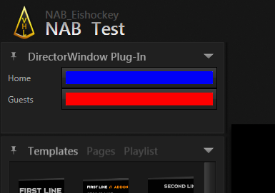

As an example for a simple, functional plug-in, let's extend the Director Window Plug-In created above and add two buttons to the window, one for cueing a specific template and one for taking the template.
Director uses Microsoft's Windows Presentation Foundation (WPF) framework to build its user interface. The advantage of using such a standard framework as opposed to a customized scripting language is that there is a great abundance of tutorials, books and other learning material readily available on the net and the resulting large number of developers that are capable of writing WPF applications. For someone only interested in developing Director Plug-Ins though, the shear amount of possibilities can be a bit daunting. However, it's quite easy to achieve first results:
To create the user interface for our plug-in, open WindowType1.xaml and replace the Grid-tags with
<StackPanel>
    <Button Content="Cue" Click="Cue"/>
    <Button Content="Take" Click="Take"/>
</StackPanel>
Those are two WPF-buttons inside a stackpanel that will align the buttons vertically inside the plug-in window. The Content property specifies what is shown inside the button (i.e. the label) and the Click property associates each button with a method in the UserControl's code behind.

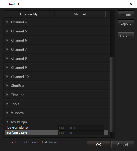

The plug-in API offers access to the IShortcutManager and IShortcut interfaces which allow creating, adding and removing of custom shortcuts. These shortcuts provide a convenient way to execute often needed plugin functionality in a fast way.

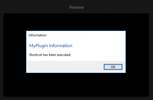

Then we add the Execute event handler for the command. For this example we only display a popup message about successful execution of the shortcut.
When the plugin instance has been passed as parameter, every plugin functionality will be available from inside the handler.
private static void ShortcutExecuted(object sender, ExecutedRoutedEventArgs e)
    e.Handled = true;
    // cast parameter back to an object of the type we have passed (Plugin)
    Plugin self = e.Parameter as Plugin;
    if ( self != null )
        // log a message and display it as a popup
        self.Application.LogInfo("Shortcut has been executed.", true);

Now the shortcut is ready to use. Once the plug-in has been enabled the Director reacts on the specified key combination and the associated command gets executed. The shortcut overview window will contain also all custom shortcuts for reference.

// add two different shortcuts using the same command, but different string values inside the tuple parameter
this.Application.ShortcutManager.AddShortcut(this._shortcutLog, ShortcutCommand, new Tuple<Plugin, string>(this, "log"), "My Plugin", "log example text", "Add an entry to the log message.");
this.Application.ShortcutManager.AddShortcut(this._shortcutTake, ShortcutCommand, new Tuple<Plugin, string>(this, "take"), "My Plugin", "perform a take", "Performs a take on the first channel.");
In the Executed event handler we only need to recreate the tuple from the parameter and perform a switch/case on the string part.
static private void ShortcutExecuted(object sender, ExecutedRoutedEventArgs e)
    e.Handled = true;
    var tuple = e.Parameter as Tuple<Plugin, string>;
    if ( tuple == null )
        return;
    var self = tuple.Item1;
    var param = tuple.Item2;
    switch (param)
        case "log":
            // log a message and dispay it as a popup
        break;
        case "take":
            // perform take on first channel, if available
            if ( self.Application.Show.Channels.Count > 0 )
                self.Application.Show.Channels[0].TakeAsync();
            break;

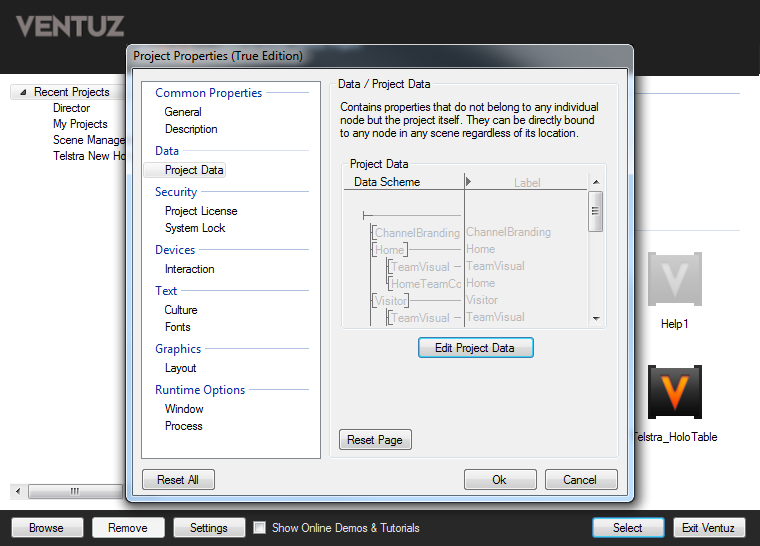

Modifying Project Data
Another common use case is developing a custom control panel that should modify project data (e.g. goals scored in a match). We'll use this to give an example on how to create WPF binding between a UI element and its respective data object. Let's assume we have a color each for the home and guests team that is part of the project data. How do we achieve something like shown in the following screenshot?
This example contains a number of standard WPF mechanisms like bindings, resources, converters, and using components from other DLLs. It is beyond the scope of this document to give the reader even a concise overview over WPF functionality and therefore this is only intended as something to follow through while using some other form to learn WPF!

The plug-in now provides two window types, the window containing the cue/take buttons and another that we will implement in the following. No code behind functionality will be needed as an alternative mechanism will be used to connect the user interface to the actual values: WPF bindings. For the following to work, we have to set the WPF control's DataContext to our plug-in which is done during initialization.
Inside ProjectDataWindow.xaml, add:
  • a Grid for layouting purposes
  • two TextBlocks (as labels)
  • two ColorPickers
The row and column definitions of the grid either specify a fixed height/wide (i.e. 75), auto (take exactly as much space as the content in that cell needs) or * (take as much space as possible). Each of the controls inside the Grid use the Grid.Row and Grid.Column Attached Properties to specify what goes into which cell of the Grid.
However, WPF does not come with a pre-build color picker, so we are going to use the exact same one as used in Director!
<UserControl x:Class="DirectorWindowExample.ProjectDataWindow"
             xmlns="http://schemas.microsoft.com/winfx/2006/xaml/presentation"
             xmlns:x="http://schemas.microsoft.com/winfx/2006/xaml"
             xmlns:mc="http://schemas.openxmlformats.org/markup-compatibility/2006"
             xmlns:d="http://schemas.microsoft.com/expression/blend/2008"
             xmlns:ventuzControls="clr-namespace:Ventuz.WPF.Controls;assembly=Ventuz.WPF"
             mc:Ignorable="d"
             d:DesignHeight="300" d:DesignWidth="300">
    <Grid>
        <Grid.RowDefinitions>
            <RowDefinition Height="Auto"/>
        </Grid.RowDefinitions>
        <Grid.ColumnDefinitions>
            <ColumnDefinition Width="75"/>
            <ColumnDefinition Width="*"/>
        </Grid.ColumnDefinitions>
        <TextBlock Grid.Row="0" Grid.Column="0" Text="Home" VerticalAlignment="Center"/>
        <ventuzControls:ColorPicker Grid.Row="0" Grid.Column="1" Height="30"/>
        <TextBlock Grid.Row="1" Grid.Column="0" Text="Guests" VerticalAlignment="Center"/>
        <ventuzControls:ColorPicker Grid.Row="1" Grid.Column="1" Height="30"/>
    </Grid>
</UserControl>
For this to work, we added a reference to the Ventuz.WPF.dll to the project by right-clicking on the References entry in the project's Solution Explorer (the DLL is part of your Director installation, just browse for it). Then we added an XML namespace so we can access the controls in the XAML.
Value Binding
Now we have two color pickers, but they do not do anything yet. We need to connect the value of the ColorPicker with the project data. First, we open Ventuz Designer and right-click on the icon for our project and choose Properties / Data / Project Data Edit / Project Data and look for where the colors are. In this case, their path is Home/HomeTeamColor and Visitor/VisitorTeamColor respectively.
We close the Ventuz Designer and continue inside Visual Studio. By double-clicking on the Ventuz.WPF reference in the Solution Explorer, the Object Browser opens up and we can see that the ColorPicker has a property named DisplayColor. To connect those two ends, we add a WPF Binding:
<ventuzControls:ColorPicker Grid.Row="0" Grid.Column="1" Height="30" DisplayColor="{Binding Application.Show.ProjectData.Data.Home.HomeTeamColor}"/>
<ventuzControls:ColorPicker Grid.Row="1" Grid.Column="1" Height="30" DisplayColor="{Binding Application.Show.ProjectData.Data.Visitor.VisitorTeamColor}"/>
For a binding to work, the DataContext of the control needs to be set properly and from there the path specified in the binding should lead to the desired property. By checking the code behind, we see that the DataContext is set to our plugin interface and from there we can again drill down to the property we want.
Converters
Unfortunately, this still does not work. When launching the debugger and opening our plug-in, the Output window will print the following lines:
System.Windows.Data Error: 1 : Cannot create default converter to perform 'two-way' conversions between types 'System.Drawing.Color' and 'System.Nullable`1[System.Windows.Media.Color]'. Consider using Converter property of Binding. BindingExpression:Path=Application.Show.ProjectData.Data.Home.HomeTeamColor; DataItem='Plugin' (HashCode=50714607); target element is 'ColorPicker' (Name=''); target property is 'DisplayColor' (type 'Nullable`1')
System.Windows.Data Error: 5 : Value produced by BindingExpression is not valid for target property.; Value='Color [A=255, R=25, G=25, B=254]' BindingExpression:Path=Application.Show.ProjectData.Data.Home.HomeTeamColor; DataItem='Plugin' (HashCode=50714607); target element is 'ColorPicker' (Name=''); target property is 'DisplayColor' (type 'Nullable`1')
In plain English, both ends don't match! We need a converter for this which luckily is also part of Ventuz.WPF.dll. We add another namespace:
xmlns:ventuzConverters="clr-namespace:Ventuz.WPF.Converters;assembly=Ventuz.WPF"
Then we add an instance of the RGBAToColorConverter as part of our UserControl's resources (usually added as the first thing right after the end of the opening UserControl tag).
<UserControl.Resources>
    <ventuzConverters:RGBAToColorConverter x:Key="colorConverter"/>
</UserControl.Resources>
And finally, we use the converter in our bindings:
<ventuzControls:ColorPicker Grid.Row="0" Grid.Column="1" Height="30" DisplayColor="{Binding Application.Show.ProjectData.Data.Home.HomeTeamColor, Converter={StaticResource colorConverter}}"/>
<ventuzControls:ColorPicker Grid.Row="1" Grid.Column="1" Height="30" DisplayColor="{Binding Application.Show.ProjectData.Data.Visitor.VisitorTeamColor, Converter={StaticResource colorConverter}}"/>
Now everything works as expected. When the plug-in window is opened, the color pickers will contain the current color set in the project data and when making any changes, they are reflected inside the presenter runtime.
Deployment
Installing a plug-in on a end-user machine is fairly straight forward. In the Ventuz installation directory, create a folder called Plugins. Copy the DLL output of the Visual Studio Director Plug-In project into that folder and restart Director. That's it!
Please note that the 'plugins' folder may only contain valid plugin Dlls - otherwise no plugin will be loaded at all!
