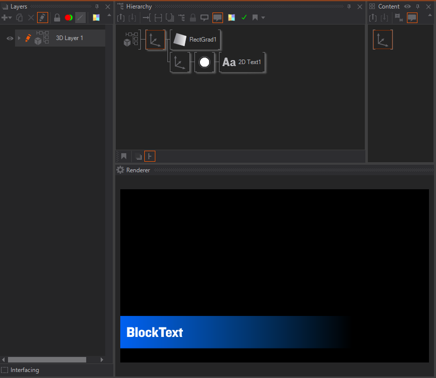

In order to create a simple name super, we create a 3D layer and click the edit button to get into .Inside the Hierarchy Editor then we just take a Gradient Rectangle with some 2D Text over it.

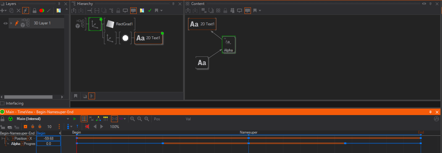

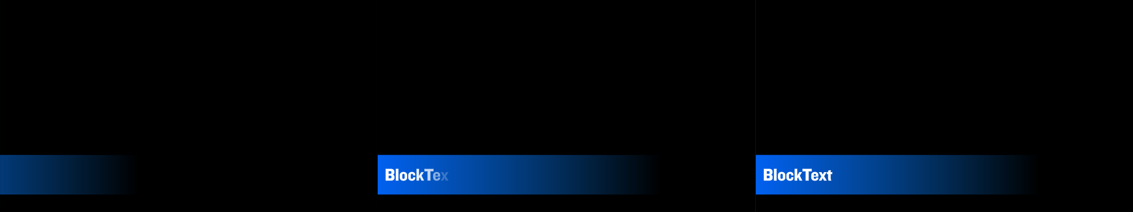

Since a Template is strongly connected to animation, as can be read here, and we would like our name super to be animated when take it on air and off air, we switch to the Animation Workspace and animate the Scale X Property of the Axis in front of the Rectangle. To let the name super scale in from the left. For the text, for example add an AlphaEffect and drag the Progress Property to the animation. Add three states and give it a nice animation as you would in any other Ventuz scene.
The Template itself is represented by a Present State. In the Logic View of the animation, click on the state that represents the name super fully on-screen and press P. The State Type switches to Presented Default and the icon turns yellow. You now have a Begin State, a Present State and an End State, with green, yellow and orange colors respectively.
In order to have a first working Template, the animation needs to be made controllable by the Director. To achieve that, change the control mode of the Animation from Autoplay to Template. The Animation is automatically added to Scene Data. To see the Scene Data Window, go to View in the Menu or simply push SHIFT + F9. Notice the icon of the Animation Node turns yellow.
We now have a simple Template which can be loaded in the Director. To give it a first try inside the Designer, go to the Main Animation, click on the yellow template button and switch through the states or simply test your template on the Scene tab. If you want to use a Keyframe-Animation node, instead of the main animation channel, you need to bind the control value of the Animation node manually to the scene data, to turn the animation into a template, controlled by the Director.

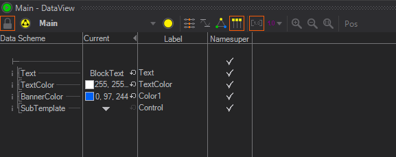

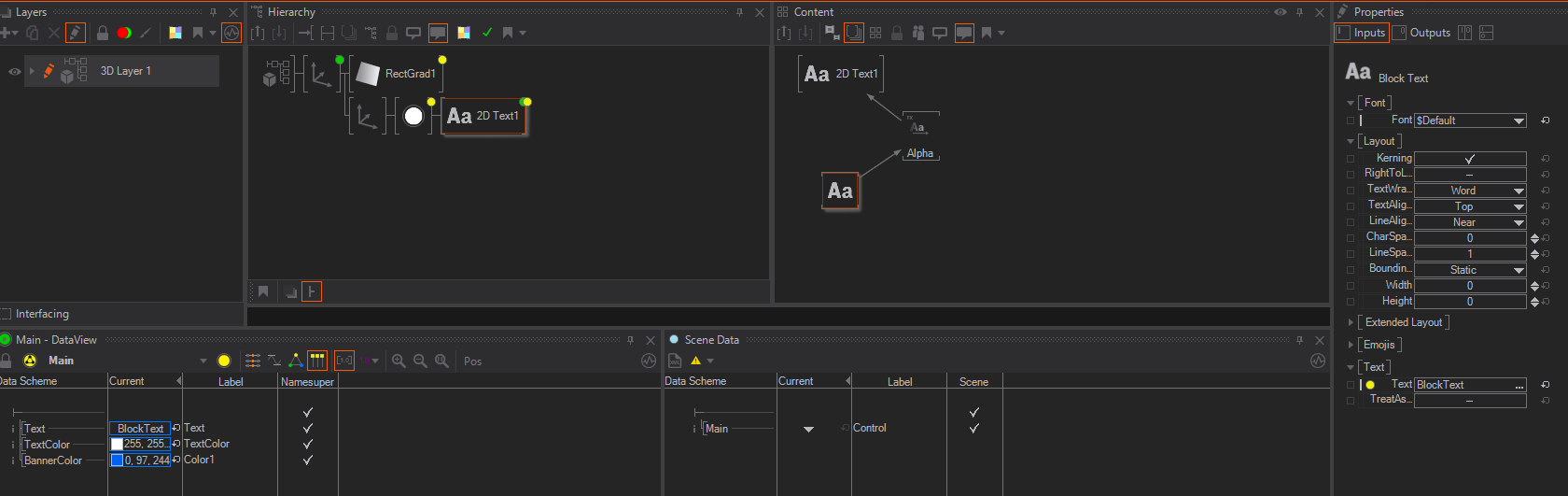

To make this Template more useful, some Data should be made accessible to the Operator who uses it in the Director. In this case it makes sense to give access to the text and the color. To make a property accessible, go to the Data View of the animation. Now go to your node,  click and hold the desired property from the Properties Editor and drag it to the Data View.  release when the label turns green. Properties connected to the Data View, and the nodes the properties belong to, get an indicator in the form of a yellow dot.
By selecting the Template Data Item in the first column of the Data View, a description, a label and constraints can be added.
Above, the Text, the Color of the Text and the Color of the Gradient Rectangle were added to the Template Data and some sensible labels were given to them. These three properties now will be visible and adjustable by an Operator when used in Director. Make sure the ticks behind the label are set. With these you can control the appearance of the data in the Director.

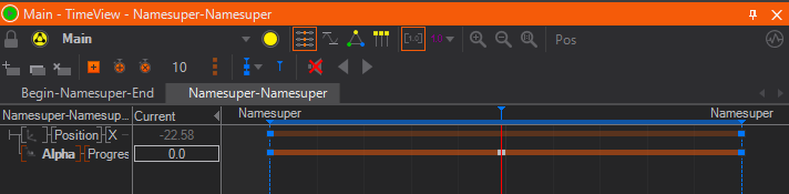

In the Time View of the Animation Editor select the Slice containing this path. (you can just  doubleclick the line connecting the states to get there). Animate the Alpha Effect to fade out and in again by adding a keyframe to the channel. Now add a Data Marker to the position where the text is faded out completely by pressing M or  click on the Data Marker Icon . A Data Marker Icon appears above the animation timeline at the point where your timeline currently is.
Go to the Scene Data View and animate to the Present State two times consecutively, you should see just the text out and in again.

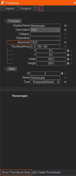

At the top of the Scene Data View, a yellow triangle can be seen.  click brings up the message that there are Thumbnails missing. Creating a Thumbnail for a Present State is a nice feature, since it will be shown in the Director and makes identifying the Template easier. To create a Thumbnail,  click on a Present State in Logic View of the animation. At the bottom of the Properties Editor two buttons for creating a Thumbnail can be found. By default the whole screen is selected for the Thumbnail, to change it  click on the Thumbnail Area Property.

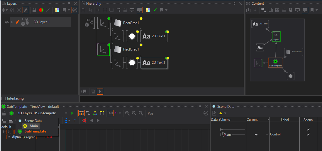

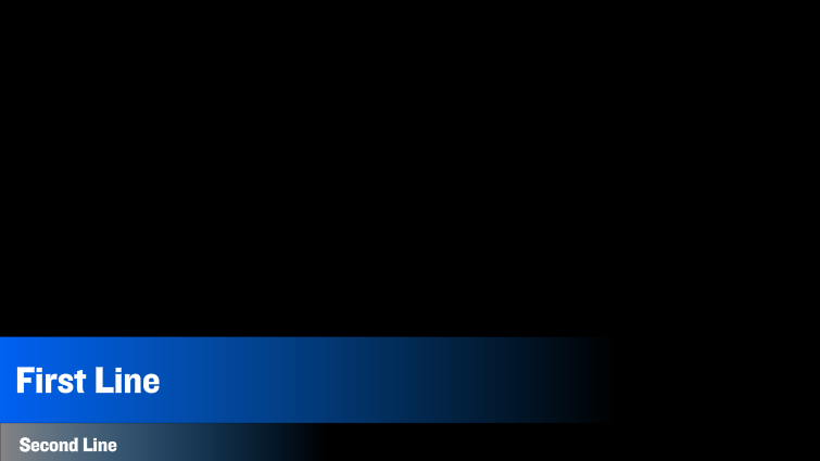

Imagine sometimes it would be useful for the name super to have an extra component that can be added when needed. In this case, for simplicities sake, a second, smaller bar just like the first one will be used to show how to add a Subtemplate. But any other element or structure can be used as a Subtemplate.
Here, for the Subtemplate, a second bar that matches the first one, is built. It just has different scaling and colors, plus it has its own Keyframe Animation Node. In this case the Animation behaves exactly like the one created above, but it is a separate and new animation node.
To make this second animation a Subtemplate of the Main Animation, do not drag the Control Property to the Scene Data. Instead drag it to the Data View of the first animation. To achieve that, select the first animation and select the Data View in the Animation Editor and press the Lock button to lock the Editor to the Main Animation. Then select the second animation in the Content Editor and  click and hold the Control Property. Drag the Control Property in the Data View. The second animation now appears as a Data Channel in the first animation.

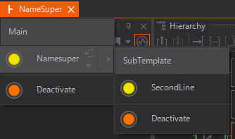

Test your Template again. Now the Second Bar appears as a Subtemplate of the first one.
Notice the dependencies between a Template and its Subtemplates.
