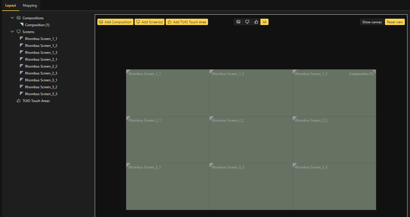

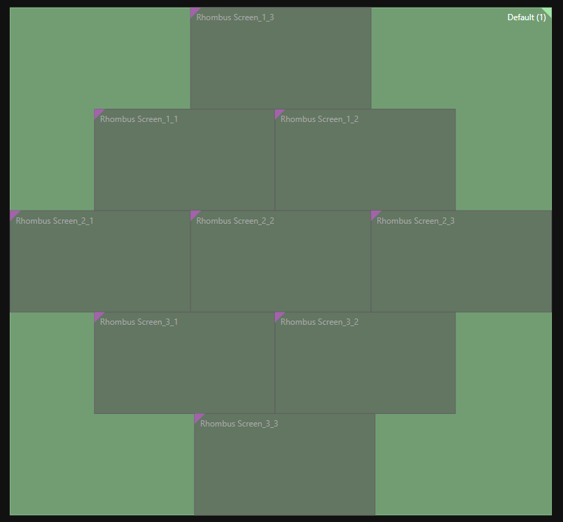

Layout
It is possible to accomplish this setup with or without any other computers connected to create a multi-machine (Cluster) Render Setup.
In the left menu, select Default Screen and then  click Delete Selected Screen(s). This screen is not needed for this setup.
 click on Add Screen(s), choose a name for the setup, in this case Rhombus Screen is used. Leave the resolution and advanced settings as default. In the Grid section of this pop-up, change the value from 1 x 1 to 3 x 3; This will create 9 screens in a grid.
 Drag each screen to achieve the desired Rhombus shape.
For more information on Layout Editing, see here

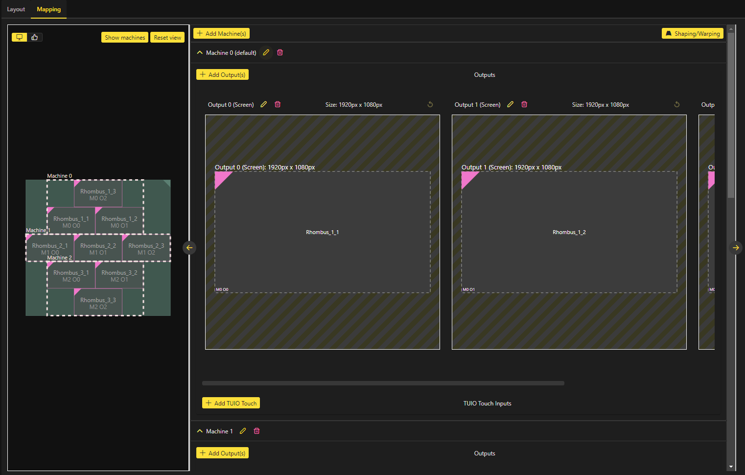

Mapping
 Click on Mapping in the top left of the Render Setup window.
Delete the first Machine.  Click on the Red Garbage Can. This will help in utilizing the built in Wizard to create and assign Screens to Outputs.
 Click on the + Add Machine(s) button.
In the pop-up, add three machines by typing in "1 x 3" in the Machines text boxes.
Change the Outputs Per Machine the "1 x 3"
In the bottom drop-down menu, select the first screen in the setup: Rhombus_1_1  Click Add.
This Wizard has now created 3 Machines. Each Machine has an ID from 0 to 2. Each Screen from the Layout Setup has been assigned to an Output on each Machine.
For more information on Mapping Editing, see here

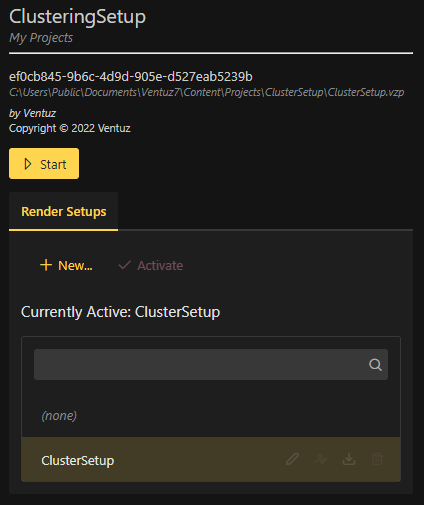

Save the new Render Setup and activate it as the active configuration for this Project in the Ventuz Configuration Editor. Every time this Project is loaded when Ventuz starts, it will automatically use this configuration for rendering. Depending on the ID of the machine, Ventuz will ensure the correct part of the Canvas will be rendered on each machine and to each output. The ID 0 will render the Cluster Preview. The Machine ID can be adjusted on-the-fly via Live Options or through the Ventuz Configuration Editor inside of the Configuration menu.
Changing and saving the active Render Setup configuration on a Machine while running Ventuz will instantly change the render output! Modifying the Render Setup will interrupt rendering in each Runtime!

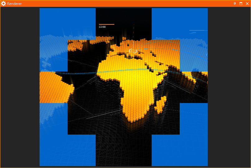

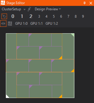

Render Setup Modes
There are different rendering modes for Render Setup rendering available from the Stage Editor:
  • Canvas Preview: This is a simulation of the whole Cluster with any number of machines and displays. Areas which will not be visible on the physical wall can be masked with a customizable color and alpha value. These values can be set in the Global Video Configuration or in the Live Options if Ventuz is already running.
  • Output Preview: This mode allows the preview of each physical output of each machine that is in, or will be in the setup. Each machine can be selected by  clicking on the numbers at the top of the Stage Editor. Each number selects displays the machine with that ID.
  • Screen Preview: This mode displays what each screen is assigned.
  • Design Preview: This preview mode is a shows the Ventuz Designer preview. Areas that aren't visible on a physical screen will be masked.
The last two modes are useful for checking whether or not a scene is well prepared for multi-machine, or cluster, rendering. The rendering mode can be changed in the Stage Editor by clicking on the display arrangement preview at the bottom of the Stage Editor. Click on a single highlighted machine or the border of the whole cluster to switch between Machine and Cluster Preview.

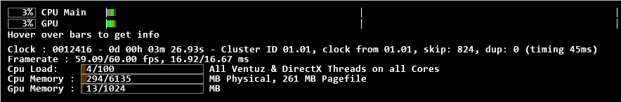

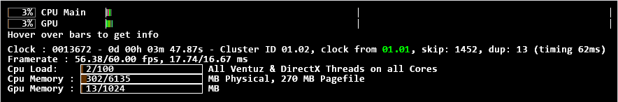

When activating the statistics in the render window, there is some additional information:
Cluster ID 01.02 means that this machine has the Group-ID 01 and the Machine-ID 02, the following number shows the current value of the cluster clock, and the clock from 01.01 indicates that the current clock master has Machine-ID 01. On a client system, the type of the cluster clock is colored green, on a master system it is white.
A font color change on a client system from green to white indicates that the client has lost its master clock and is running independently. Make sure that the client systems show constant green writing without any flickering between green and white.

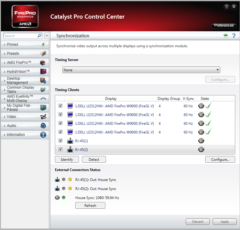

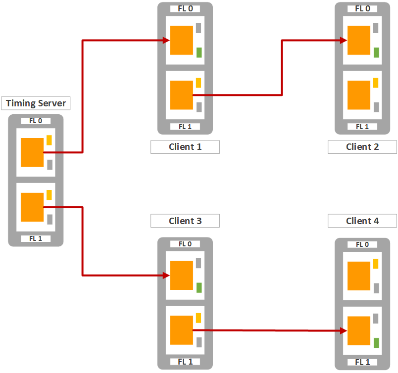

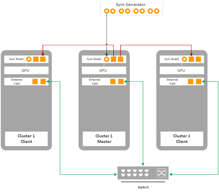

To synchronise the Cluster's outputs, install a synchronization board in every machine in the cluster, following the manufacturers instructions.
Every sync board has one BNC connector for an external timing source and two RJ-45 connectors to connect the sync boards to each other. Be aware that the RJ-45 are only for connection between the sync boards. Do not connect them to a usual Ethernet port or network switch as this can cause damage to the boards. As in the image below, the connection between the sync board is independent from the Ethernet connection.

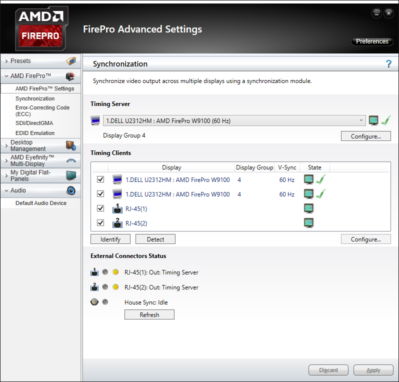

To synchronize the cluster, one machine acts as the timing server, the others as clients. For Framelock applications, the timing server uses an internal signal as timing source. For Genlock applications, connect an external timing source, e.g. the 'house sync', to the timing server via the BNC connector as seen in the image above.
The machine that acts as the timing server uses both of its RJ-45 as outputs to distribute the timing signal. A client uses one as input and the other one as output, so the signal can be passed to another client. It is recommended to split the clients in two equal groups and arrange each group as a daisy chain connected to one of the two timing server outputs.
Next, configure the timing master and client in the graphics card driver. See the graphics card manual for details. Below is an example screenshot for a four display machine set up as timing master. Configured in AMD Catalyst Control Center. The timing signal comes from an external sync generator.
Here an example to synchronize two machines where the left machine is the timing master. This configuration is crucial to use Swap Sync in Ventuz!
For detailed information on how to set up the synchronization boards, refer to the manufacturers documentation.

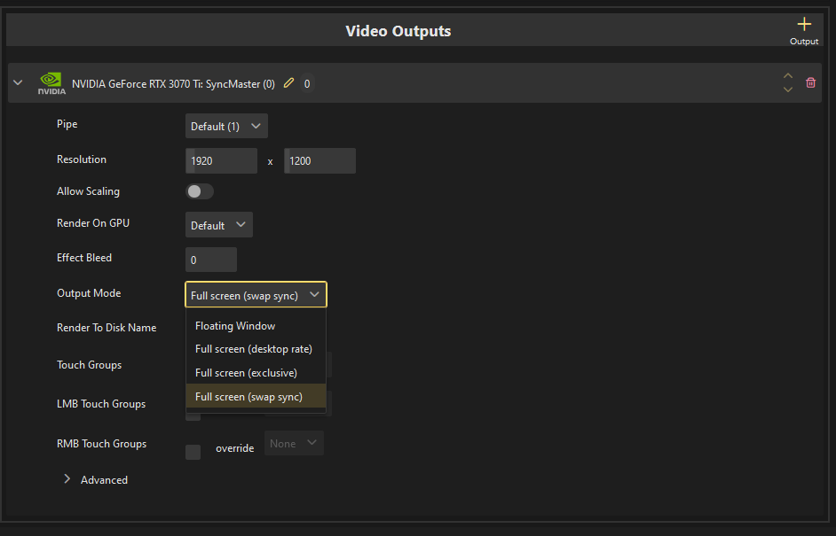

Enable Swap Sync
Now that the displays' refresh rates are set to a common time source, internal or external, tearing or flickering should be prevented. This was done in the graphics card configuration. As described above, Swap Sync requires support by the application - Ventuz in this case. To enable swap sync, move to the DirectX Output of the Device Configuration.
Be aware that Swap Sync only makes sense and only works if the synchronization boards are configured correctly.
Note that Swap Sync only works in exclusive fullscreen mode!

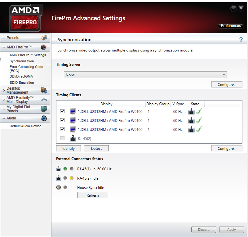

Our experiences with AMD Boards
  • AMD suggests to boot the timing master first, then the clients in the order they are connected to the master. This way the timing signal is present when the client comes to live. Shut down vice versa.
  • AMD boards loose their configuration almost every time they loose the timing signal. AMD's recomendation is to ensure the have boards configured correctly using presets in the Catalyst Control Center and load these after every startup. This can be found in in the Catalyst Control Center help.

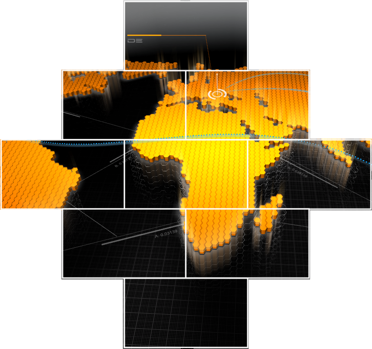

Layer Effects
Following is a list of all Effects with hints to use the Effect Bleed or if should not use them in a cluster at all.
Effect Cluster Compatibility
Grayscale
Color Grading
Color Correction
Gain
Posterize RGB
Posterize HSV
Color Difference
RGB Noise
Delay
all Masks
works in cluster without problems
Mosaic
Blur
Glare
Dropshadow
Edge Detection
Lens Distortion
Distortion
RGB Distortion
2D Displacement
Noise Distortion
works with Effect Bleed only
Feedback often fails in cluster with an Effect Bleed - depending on parameters
Crashzoom
Polar Distortion
Kaleidoscope Distortion
does not work with an Effect Bleed
  • Shaping Editor
