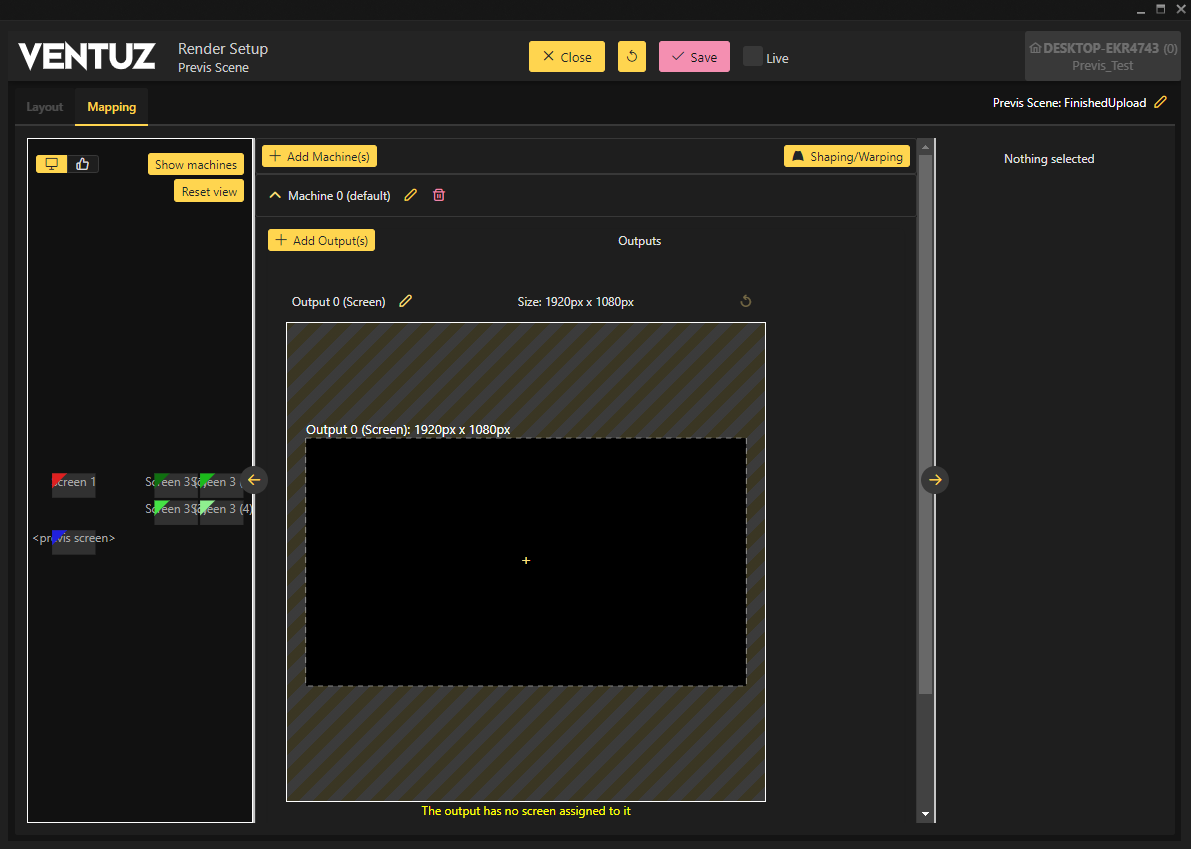

  6. Output Mappings
    1. Simple Screen
    2. Bezel Screen

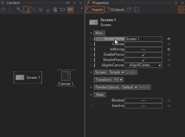

  1. Add an Axis node to the Hierarchy editor.

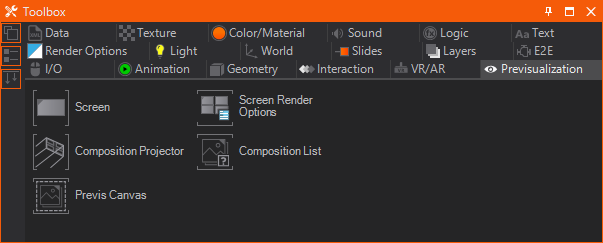

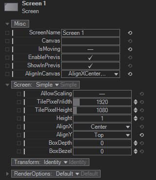

  2. Find the Screen node in the Previsualization tab inside of the Toolbox.  drag&drop the Screen node into the Hierarchy Editor behind the Axis Node. Resize the Screen to a size that's viewable.
  1. Find the the Previs Canvas node and create or  drag&drop it into the Content Editor.
  2. Bind the Canvas property from the Screen node to the Previs Canvas as shown below:

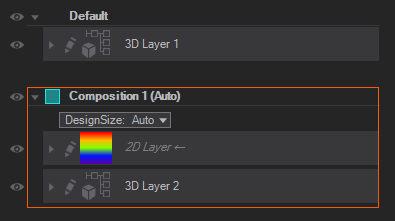

  1. Create a Composition Layer by  clicking the + in the Layer Editor and  clicking the Composition Layer to create it.
  1. Select the Composition Layer and create a standard 3D Layer. Create anything inside of the 3D Layer.
    • In this example, a simple rotating Ventuz Mesh cube - which is loaded by default if a mesh loader is used.
  1. Create a 2D Layer gradient and place it above the 3D Layer.
    • Ensure both layers are placed in the following order inside of the Composition Layer:

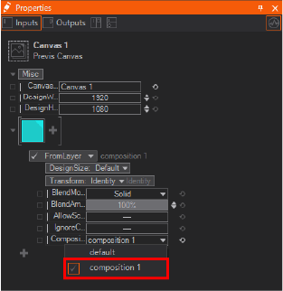

  1.  Click on pencil of the original 3D Layer that the Screen and Canvas nodes were added to in the first steps.

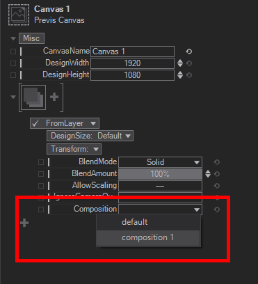

  1. Select the Previs Canvas node and  click the and select the Composition From Layer, to add the recently created composition (which is a layer) to our Canvas to be shown on screen.
The Composition for the newly assigned Composition from Layer property needs to be defined.
  1.  click and select from the Composition in the bottom drop down menu of the Canvas node.  Click the Composition Layer named Composition 1.
This will show the content of the Composition Layer created in the previous step on the previs screen.

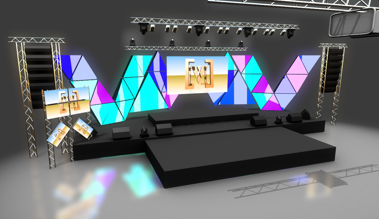

We will make use of the existing StagePrevisLayer that is a simple 3D Layer with HDR to use as the 3D Previs Scene.
Create the stage here by using imported geometries of the event space such as the stage, rigs, screens and other props. The Screen node will create a geometry to use as well. The position of the screen that is already modeled be used here. We will make use of the exposed values from the screen model. If you have coordinates handy you can use them and position a Screen node simply with an Axis. Ventuz can use the real world coordinates in meters, and rotations in degrees.

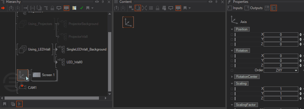

  1.  Drag&drop an Axis node into the Hierarchy Editor.
  1.  Drag&drop the Screen node next to the Axis node.
We want to match the LED Wall model in our previs layer. With the exposed X/Y/Z Position Values, they can can be used for the Screen node's Axis already.
  1. Either copy and paste the values from the LED_Wall0 Hierarchy Container or bind the values to the axis in front of the Screen. For best practice, is recommended to use the binding method; This way, when one element is moved, the other follows automatically.

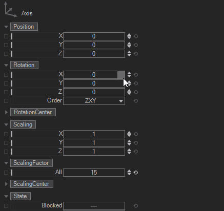

  1. Change the ScalingFactor - All property for the Axis to 2. We also need to  click the Screen node and change AlignY to Top, for the Screen Simple property:

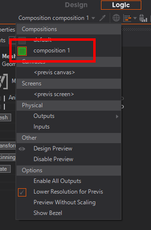

To show the Composition Layer content, use the Preview Selection Menu to select what is to be shown in the Renderer Window.
Select composition 1 from the Preview Selection Menu drop down list:
Now content of the Composition Layer is shown - the small Ventuz Cube mesh.
  1.  Click the axis in front of the Mesh Loader and set the ScalingFactor - All to 15.

Switch back to the Composition default with the Preview Selection Menu.

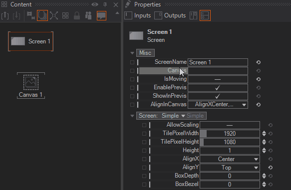

  1. Find the Screen node in the Previsualization tab inside of the Toolbox.  drag&drop the Screen node into the Hierarchy Editor.
  1. Bind the Canvas property from the Screen node to the Previs Canvas as shown below:
  1.  Click Screen - Simple drop down property and change it to Bezel:
  1. Adjust the BezelX/Y to the appropriate values needed.
    • Keep in mind that the TilePixelWidth/Height values apply to each individual screen tile. With the TileX/Y property the number of screen-tiles can be changed.

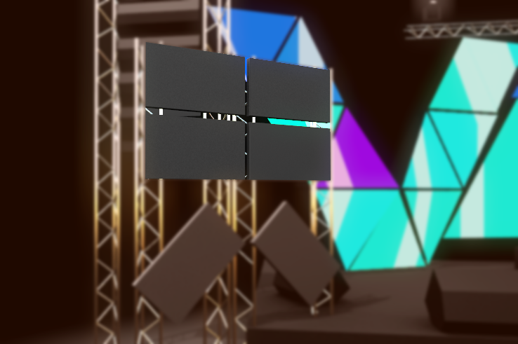

This example will use Screen Tiles and a spinning Ventuz default Cube displayed on four 16:9 1920x1080 screens of the same size with a Bezel.
To have the correct placement and Bezels of the tiles, the physical dimensions of the screens and their bezels are needed.
If you followed up the Simple Bezel example from above, many of the steps are the same but involve additional steps to correctly place the Screen used for the previsualization.
  1.  Drag&drop the Screen node next to the Axis node. Then create or  drag&drop the Previs Canvas node in the Content Editor.
  1. Bind the Canvas property from the Screen node to the Previs Canvas as shown here:
Position the Bezel Previs Screen correctly in the previs scene:
  1.  Click the Axis node in front of the Screen and type in the following values for the Position and Rotation properties:
Position
X -6.287
Y 2.253
Z -1.7
Rotation
Y -35
The coordinates are from the 3D Modeling software and taken from the whole screen group which are expressed in meters. The rotation is expressed in degrees. The values for the bezel also match the ones from the modeling software that created them.
  1.  Click the Screen node and type in the following properties:
Height 0.45 *
Align
X Center (default)
Y Center
Bezel
X 0.042
Y 0.05
The height has been calculated by:
Taking each of the two screens has a height of 0.9m,: 0.9/2 = 0.45. The Alignment has to be Center/Center since as the position and rotation is from the whole grouped geometry.

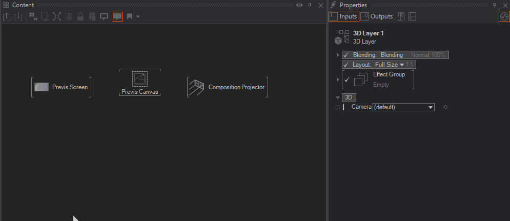

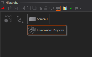

  1. Find the Screen node in the Previsualization tab inside of the Toolbox.  drag&drop the Screen node into the Hierarchy Editor connected to an Axis Node.
  1. Find the Composition Projector node in the Previsualization tab inside of the Toolbox.  drag&drop the Composition Projector node into the Hierarchy Editor connected to the Screen's Axis Node.
  1. Bind the Canvas property from the Screen node to the Previs Canvas.
  1. Select the Previs Canvas node and  click the and select the Composition From Virtual Projector.
  1. Bind the Projector property from the Canvas Node to the Composition Projector Node
  1. Select the Composition Projector node and  click the Composition dropdown.
This sets the "Source" of the Composition Projector to the selected Composition.
Now this Projector is projecting this Composition Layer to any Screen that is connected and configured to receive it.
An Axis Node can be placed in front of the Composition Projector to place its projection where it's needed in the Scene.
Because the Composition Projector is Orthogonal, it will not get larger or smaller when changing the Z-Position of the Projector. This is expected behavior because of the type of Projection in this 3D world.
It is best practice to fill a Composition Layer with a gradient 2D texture to start rather than 'black on black'; this can assist in accurately positioning elements in the previs scene.

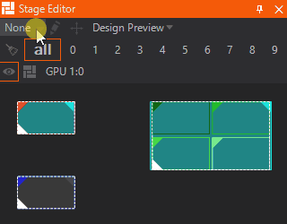

  1. From inside of Ventuz Designer, press shift +  F8 to open the Stage Editor.
    • No Render Setups exist as a new project was created at the beginning of this tutorial.
    • If a Render Setup does exist, the following steps can be followed, multiple Render Setups can exist in the same project.
2. click the dropdown menu that shows None and  click Manage render setups.
  • This will automatically open Ventuz Configuration Editor and automatically have the Project management tab open with the correct project selected.

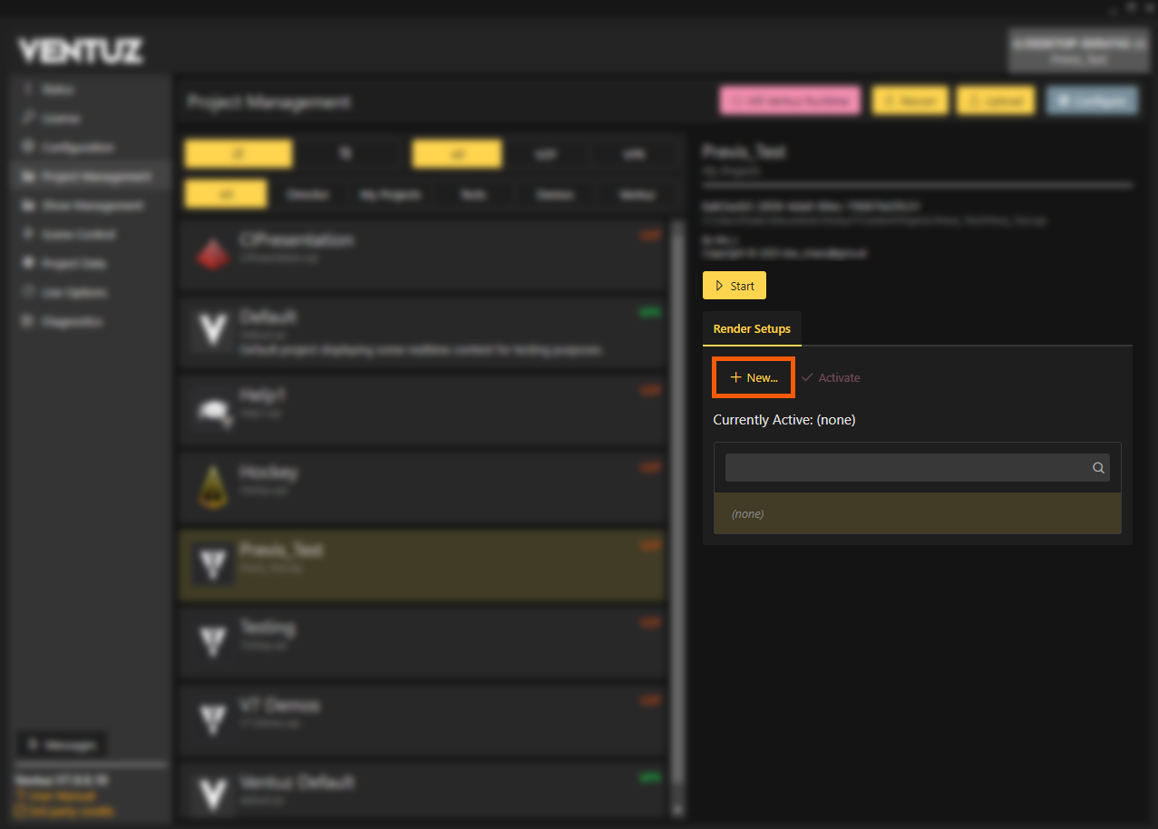

While in the Project management tab, see on the right hand side the Render Setup related part. Here you can activate and select existing render setups, or create new one.
  1.  click New to create a new render setup, give it a name relevant to this project for clarity's sake, such as Previs Scene and  click + Create to create a new Render Setup.
Render Setup Editor will automatically open with the new Render Setup file loaded and ready to be edited.

On the left panel of the Render Setup window, there are multiple screens from the created and configured previs Scene.
Screen 1 (red corner) is the Simple Screen, a single FHD screen.
Screen 3 is the Bezel Screen and is visualized by multiple tiles (4 tiles all named screen 3 - green corner) and the <previs screen> (blue corner).
In Ventuz 7, the <previs screen> can also be viewed in Ventuz Designer can be assigned or mapped to a physical output, this is why it is shown here.

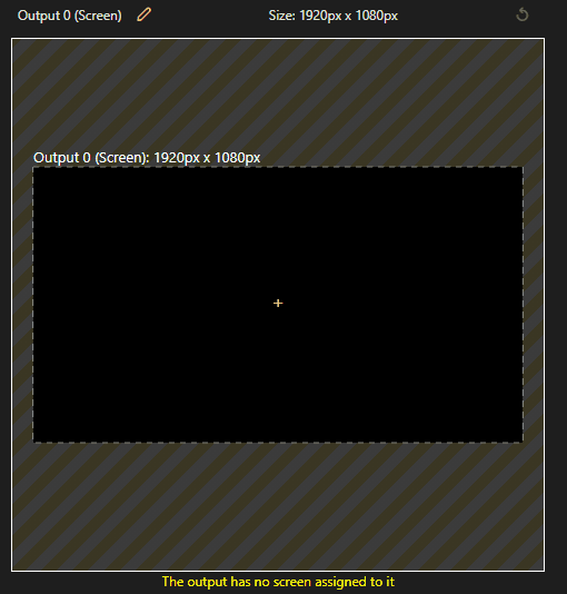

By default, no screen is mapped to any output (middle pane of the setup editor) though an output was added and exists by default: Output 0 (Screen).
To map the Screen 1 to an output:
  1.  click the yellow + in the middle of the shown output.
  1.  click on the dropdown menu to open it and  click Screen 1 to assign it to the output:
When the output has a screen assigned to it, the yellow warning below the output "The output has no screen assigned to it", will disappear.
  1.  click the Save button in the top bar of the Render Setup to save your changes.
    • Screen 1 has been assigned to the first output.

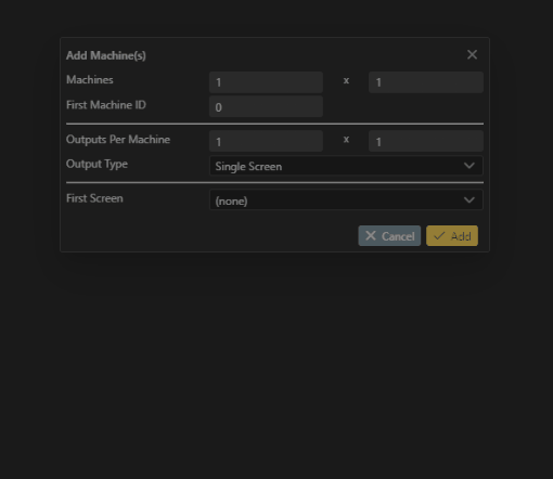

  1.  Click the + Add Machine(s) button in the top to create a new Machine;
The popup screen can be used to automatically define how the output mapping for the Bezel Screen will be setup.
  1. Leave the Machines text boxes to create one machine.
  1. Change the value for Outputs Per Machine to 2x2 Outputs.
  1. in the Output Type dropdown, select Single Screen.
  1. In the First Screen dropdown, select Screen X (1)
    • Ventuz will use the adjacent screens (2,3,4) automatically and distribute them for the other remaining 3 outputs.
Each of the new outputs inside of this new machine has the corresponding screen assigned to it.
