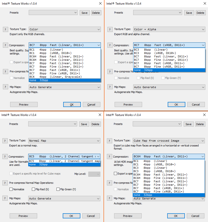

After installing the Intel Texture Works Plugin, you can create or convert your textures by choosing the Intel Texture Works DDS Type from the Save as type dropdown:
By choosing a filename and clicking the save dialog, another dialog will pop up and ask you for the Texture Type and Compression. See available types and formats;
You can go for any of the available types and compressions. The decision should be made according to the usage of the texture. A simple heightmap should not be saved with BC7 since you will mostly use a grayscale image only. In this case a BC4 linear grayscale would be the perfect match.
