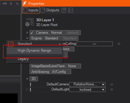

Select the 3D Layer Root node (the very first node in the Hierarchy Editor in every 3D Layer), then inside the Properties Editor you will find a dropdown menu for the Engine. Click click  on Engine:Standard to bring up the selection menu and select click  High Dynamic Range.
Whenever you switch from Standard to HDR the overall colors will have a slight variation due to the nature of the HDR Mode
As soon as you enabled the HDR Engine you can see more properties like: Exposure, Dither, FrustumCulling and another dropdown menu for the ToneMapping selection as well as another set of properties depending on the selected ToneMapping mode.

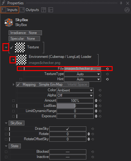

Select the SkyBox node and select the SkyTexture Property, switch from None to Texture to load a HDRi.
Unfold the Texture Property, unfold the Environment (Cubemap /LongLat) Loader and chose/load a Texture by clicking click  the File Property.

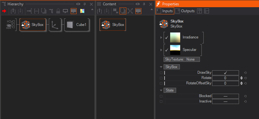

An Irradiance Texture will light your scene and is barely bigger than 128px x 128px. While the Specular Texture will be used for either reflections on geometries or when used with !IBL/Roughness maps the roughness maps will control the mip map level on the surface to give the surface a specific glossy finish, like rubber, coal, iron, mirror.
You can use the already created SkyBox or create a new one and load an Irradiance Texture into the Irradiance slot and a Specular Texture into the Specular Slot. You can find example Textures by using the interactive Help for the SkyBox or use the Link from the hint above to locate the example textures. Now create a an Axis with ScalingFactor: 10 and a Cube with BevelRadius:0.1 behind the SkyBox node.
The SkyBox node works like a LightGroup. Only the nodes/objects behind the SkyBox will be affected by the SkyBox

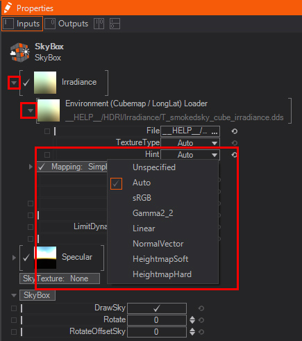

In most cases you will notice that the whole environment looks too bright and/or has an incorrect gamma. Most times the first step is to adjust the Gamma for the loaded images - irradiance-, specular- and SkyTexture. For each of these textures there is a dropdown property called Hint. To access this property you would need to unfold the Irradiance Property then the Cubemap Loader and there you will find the hint - dropdown menu which is usually set to Auto.
Gamma
Usally HDRi will have the used gamma value written in their metadata and Ventuz will try to adjust the gamma accordingly to the metadata gamma value - therefore it is set to Auto. If that is not the case or the wrong metadata is written inside the file, you can adjust the gamma manually here. In most cases you would need to switch the hint to Gamma2_2. Its important to check if you would need to do that for both or all used SkyBox textures. The hint is available for all texture loaders: Irradiance, Specular and SkyTexure The next step would be to adjust the Exposure.

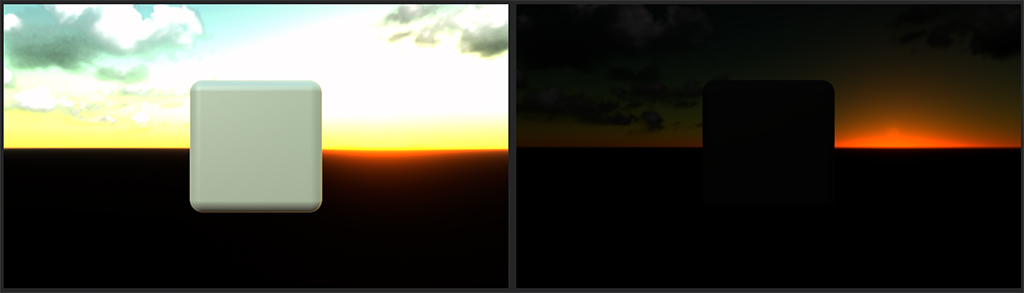

Exposure behaves the same way like with a real camera. You can find the Exposure property at the 3D Layer Root node. The higher the exposure value the more light will travel into the camera, the lower the exposure the less light will travel into the camera and therefore darken the scene/environment.
In the case of the HDRis from the Help Scenes, it would be wiser to darken the scene, it still looks over-brightened (as long as you use our default textures). You will notice that at least starting with exposure values around -2.26details such as clouds will be noticeable, as well as the cube will become more naturally lit. Adjust the 'Rotate: 70' for the SkyBox - this will rotate the whole sky and you should face the sun.
Play around with the Exposure and lower the value to around -8.5 so you can spot the Sun-Disc.
The above example shows the difference between an exposure value of -2.26(left) and -11.0(right) - This way you can realize how much dynamic light information is stored inside the HDRi. Also notice that the environment also lights and colorizes the geometry, in this case the beveled cube.

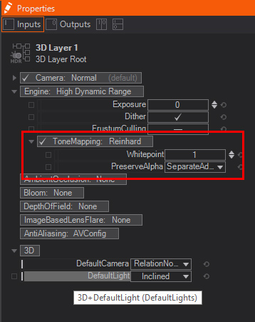

As long as you use the default set Tonemapping: Reinhard you can adjust the Whitepoint. By adjusting the whitepoint you simply tell the engine which brightness value is pure white. It will bring more clarity and detail to your image and eliminate the haze you see in many images.

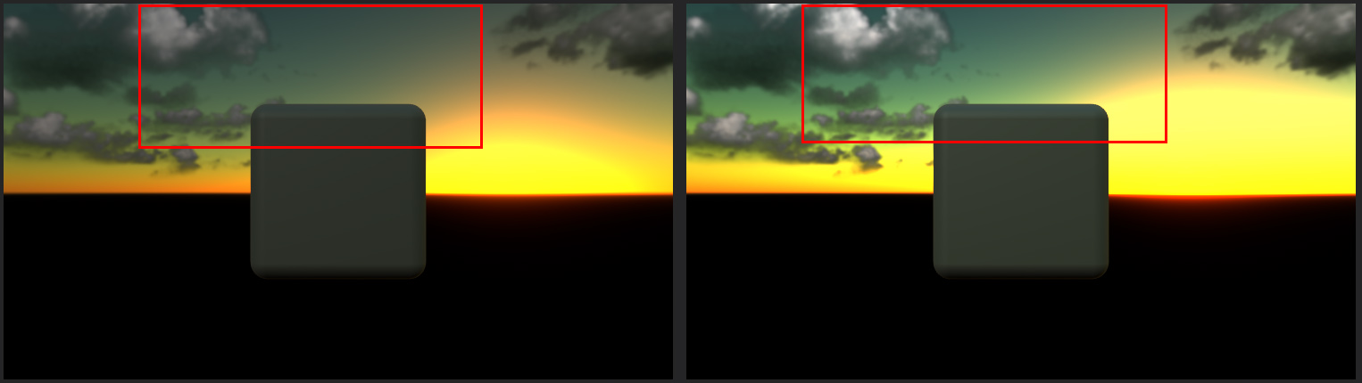

In our case with the default Sky Textures we would adjust the Whitepoint, depending on the Exposure as well, by setting it matched to the "white in the clouds". You adjust the Whitepoint first to have the image, or in our case, sky, look more natural.
Adjust the following properties to match these values: Exposure: -6.28and Whitepoint: 0.24
You can spot the differences not only while you adjusted the values. You see the differences in the clarity and that the clouds are not starting in the gray - they start with the corrected white and then have their gray scale applied.
