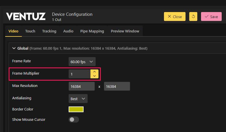

Frame Rate Multiplier
To make a cluster with mixed frame rates work correctly, the cluster clock has to be matched. More specific, it has to be set to the least common multiple. The global FPS setting is used to calculate the local timing from the cluster clock, so the FPS setting has to match the graphic cards' refresh rate. Then the frame rate multiplier is used to bring it to the least common multiple of the machines.
The frame rate multiplier increases the steps of the cluster clock to a level that the machines have in common, so each machine can use the multiplier and the machines fps setting to calculate its correct local time base.
The frame rate multiplier is set in the global video options.
Example: A cluster of two machines should be used. Machine one uses a VR headset that runs on 90Hz, as output. Machine two drives a display that can not run on 90Hz, but has to run on 60 Hz. The least common multiple of 90 and 60 is 180. So machine one has to be set to 2 x 90 Hz, Machine two has to be set to 3 x 60 Hz.
Increasing the cluster clock steps with the multiplier not only changes the value of the clock. It actually increases the internal validation steps in the render engine for it to be able to apply the correct timing. The rendering, of course, stays at the machines refresh rate, so in the above example, machine one renders 90 frames per second and machine two renders 60 frames per second.
