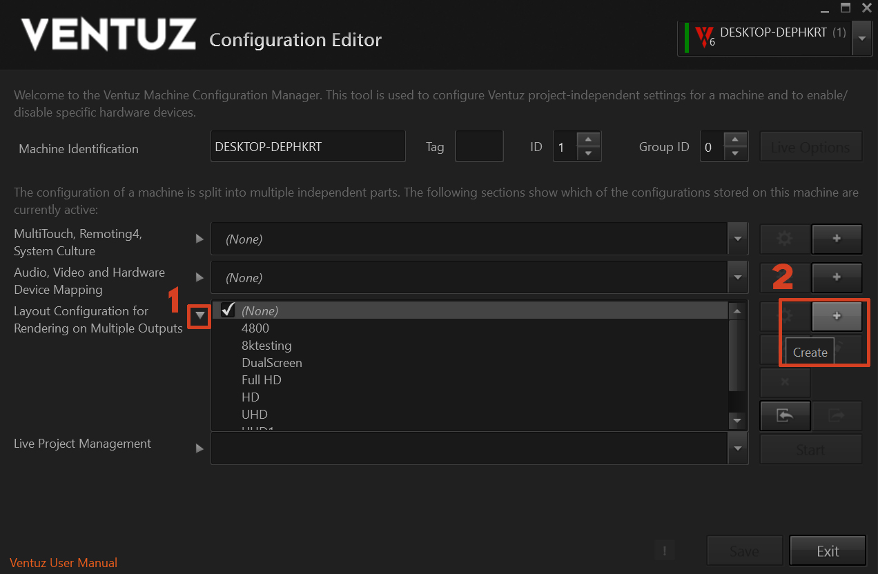

Open the Configuration Editor and create a new configuration in the "Layout Configuration for Rendering on Multiple Outputs" category by clicking the "+" on the right side. Now you can give it a name and clicking OK. The Layout Configuration Editor will automatically open.

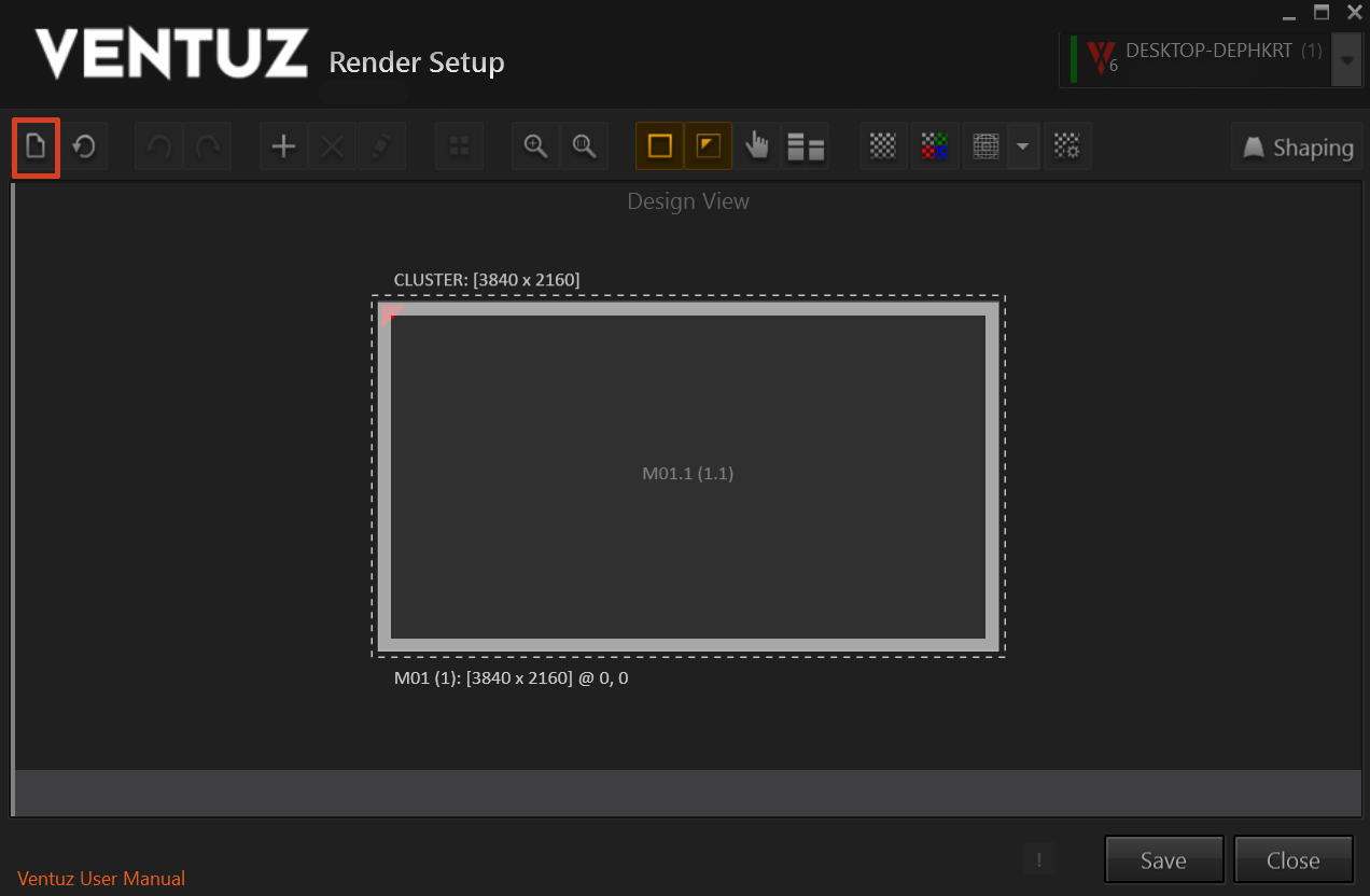

What you will see now is something similar to this. The size and resolution may vary depending on your setup.

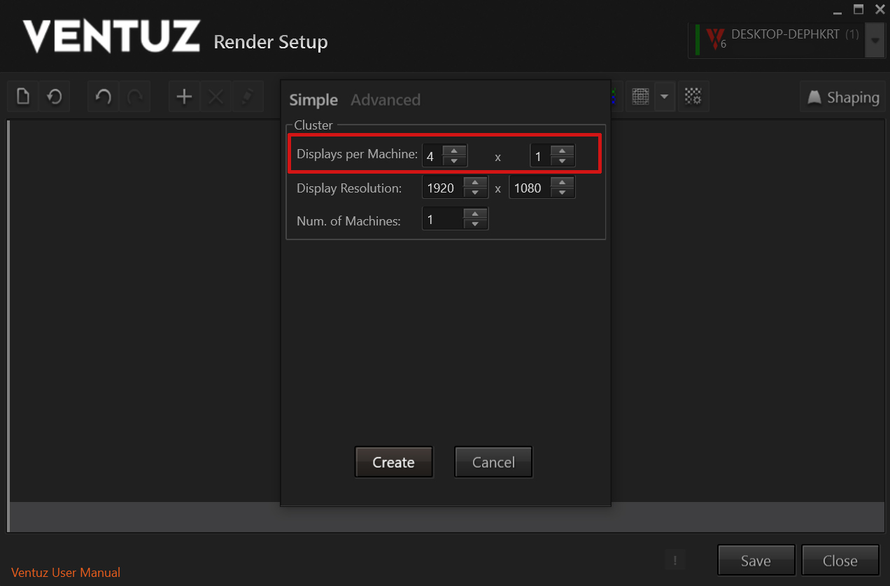

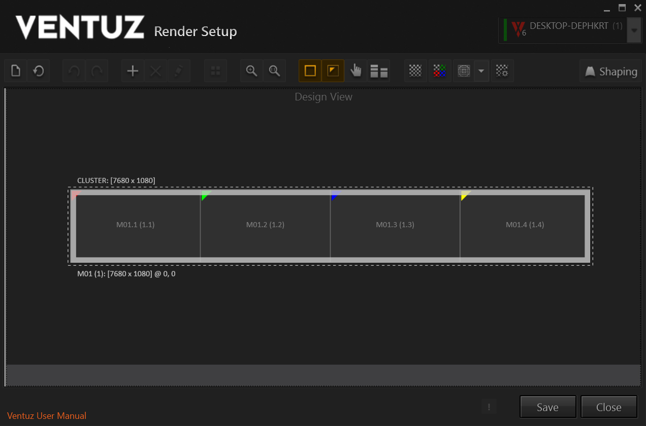

Now click on the icon marked in the top left to create a new setup. Adjust the number of displays to the correct amount for each machine and LMB click create.
For this example we only have one machine. If you need to learn how to setup a multi-machine cluster, take a look at this how to.
This dialog will always override the existing setup when saving.

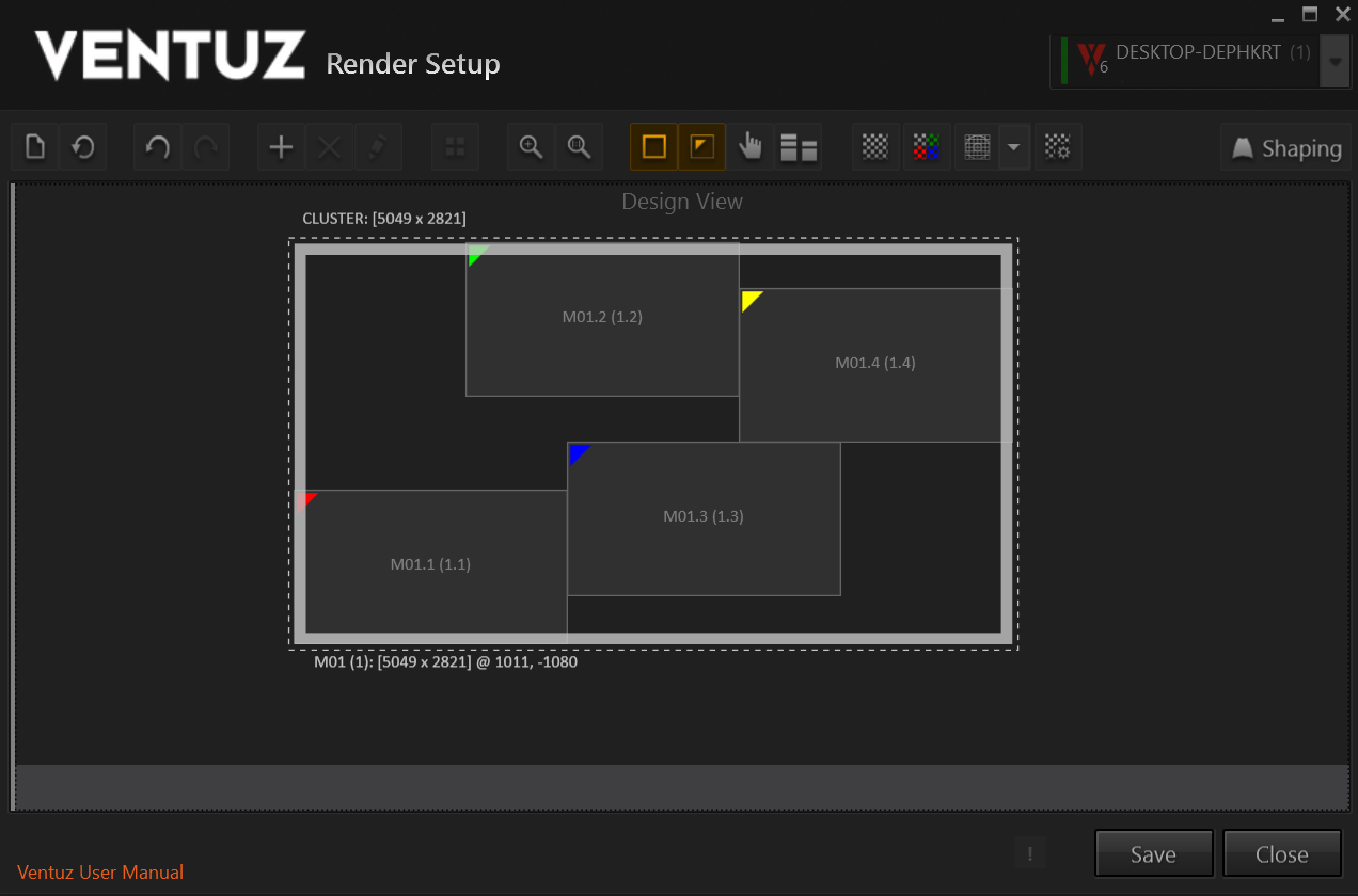

These screens can be freely moved and can be adjusted so they fit the arrangement of your displays.
Notice how there is always this thicker outer wall; this is the entire rendered area. This is important to know because Ventuz will always use the whole rectangle as its rendered area. For example, if things are moving from left to right and there is a lot of space between those screens, that the object moving respects the free/empty space.
The whole "rendered area" is always rendered by the GPU. Memory and performance are still allocated to this area even if it's empty.
