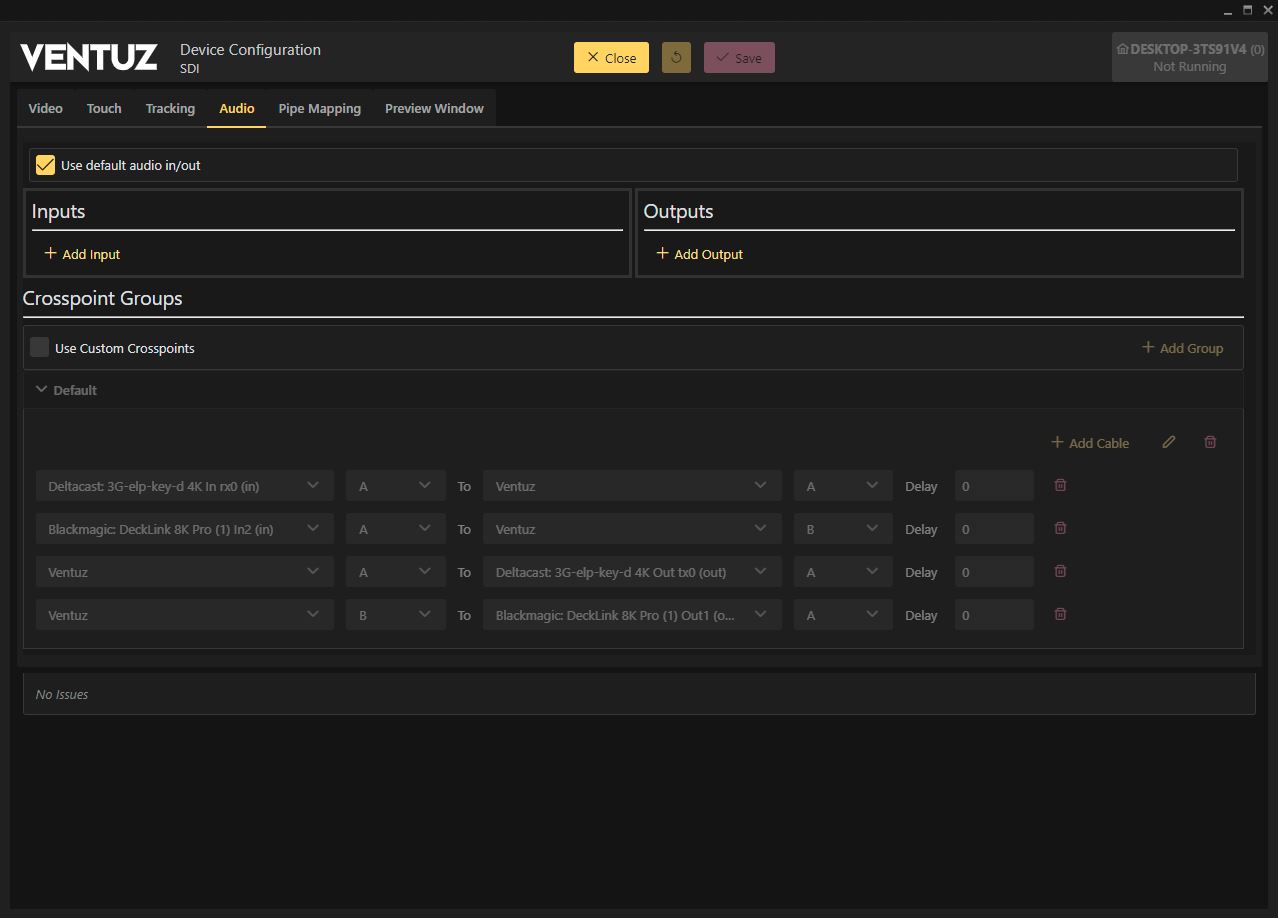

To make use of custom audio routing you need to configure your inputs and outputs in the Ventuz Configuration Editor by creating a new configuration inside the Device Configuration.
When you open the audio tab in the Device Configuration you can see that available audio inputs and outputs are not visible because Ventuz is using the default in and outputs, which are the ones configured inside your operating system. It is possible to add specific in and outputs by using the + buttons, but you will need to route them to the virtual Ventuz Ordinals. For this they will be available in the next tab for creating crosspoints.
In the Audio tab of the Device Configuration you can define which Ventuz Ordinals should be mapped to which Hardware Channels. You can also map virtual output ordinals back to input ordinals so that Ventuz listens to one of its Audio outputs. Likewise you can directly map a physical audio input to another physical hardware output so that it bypasses Ventuz. Lastly it is also possible to map any physical device or virtual ordinal multiple times - e.g. you can bypass an audio input directly to an output and also map it to a Ventuz input ordinal to visualize its sounds in your presentation.

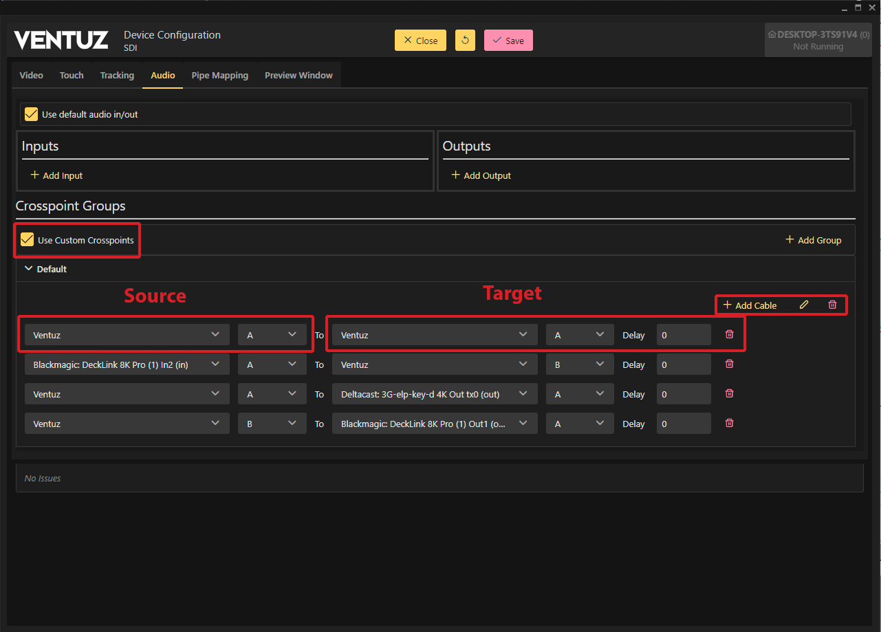

Now use the Cross Points section and enable the Use Custom Crosspoints checkbox to be able to manually adjust them.
Use the dropdown menu to select individual audio devices. For each device, on the left is the device's source and on the right is its destination. On the right hand you can assign where this source should be routed to. Click  the drop down menu, select Ventuz and for the Ordinal select A as well. At first sight, this seems to create an infinite loop but since input and output ordinals are distinct items, we only route the Ventuz output from ordinal A to the Ventuz input on ordinal A, but not vice versa.
You have created a Ventuz to Ventuz routing right now. Since Ventuz creates a virtual Ventuz Device it is possible to playback audio from within Ventuz and reuse the audio signal internally then. This is the common way to use the Audio signal to be analyzed from Ventuz itself. If you plan to use the Analyze Audio Node to build up e.g. a VU-Meter or have something react to your audio, you would need to create this Virtual Device configuration. If you use a Movieclip the sound is routed internally and can be analyzed by Ventuz. The output of the Analyze Audio Node can now be used for a Particle System as well. You can have particles react to the Audio - like changing their Size and/or Color, Position, Orientation and so on, just to give you an idea what you could do with this kind of routing of the audio. Use the delay function to sync match when needed the value is in milliseconds.

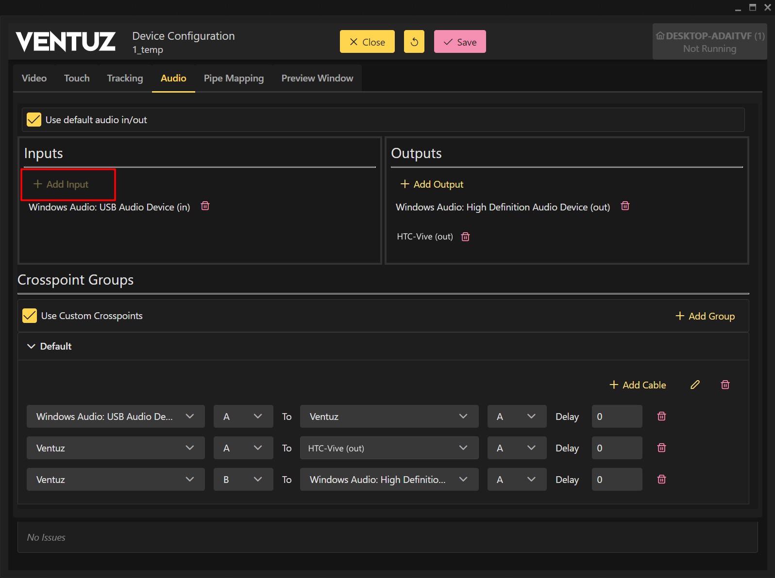

Since you can have multiple audio devices attached to your workstation or server, like audiocards, SDI boards, Head Mounted Display like the HTC-VIVE, you can route them as described above as well. This can be done in the Audio tab of the Device Configuration. The first thing is to click  the + and add inputs.
Inside the Crosspoints section enable the Use custom crosspoints flag. Without that Ventuz is using the default routes. These routes are:
Source Ordinal Target Ordinal
Soundcard Input A to Ventuz A
Ventuz A to Output HTC VIVE A

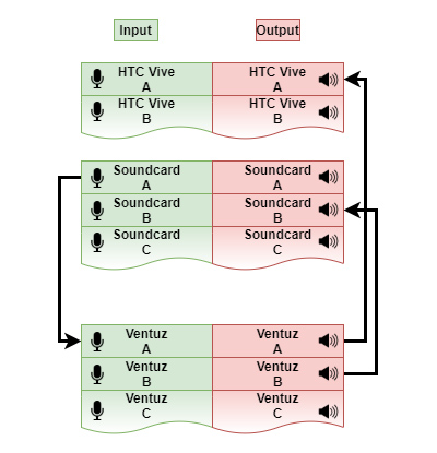

Ventuz B to Output Soundcard A
Why do we have different Ordinals like A and B in this case? Ordinals can be seen as Stereo Pairs - like channel 1&2 or R and L. You have Oridnal A-H which makes a total of 8 audio pairs available. Since Ventuz has automatically assigned all inputs and outputs, Ventuz assumed you would like to have all these sources separately. A Ventuz Artist can now decide on which physical output to playback from a Node by selecting either Ordinal A or B in the Ventuz Designer. So in this example above you could select from within the Ventuz Designer to have the Ventuz sounds to be routed EITHER from Ventuz to the Vive by using Ordinal A or from Ventuz to the Soundcard using Ordinal B. Still, the Artist does not need to care about which exact hardware this will play out to, they only care about that these are different physical outputs - thus assigning the different ordinals. To learn more about the Ordinals check the User Manual Crosspoints section.
As you can imagine you can go for a very complex routing in the Cross Points tab and make it possible to have Ventuz use specific routes wich you created with the virtual cables and selected the route by chosing the respective ordinal from within the Ventuz Designer.
