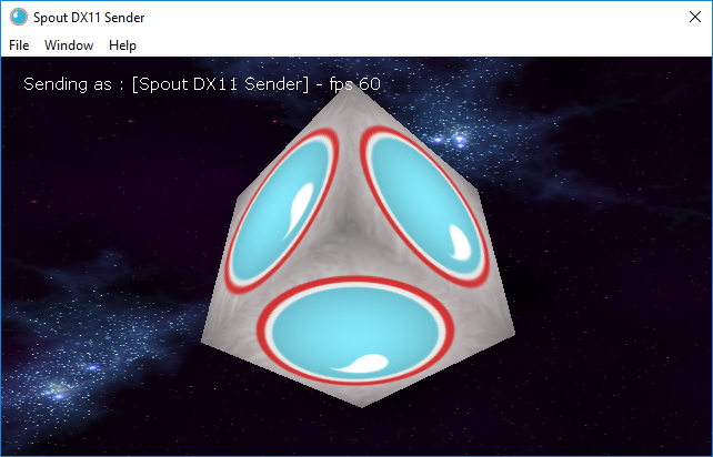

For this How to you need to make sure the correct version of Spout is installed on your system. Simply ​download and run the Spout installer on the target system. The Spout installation also includes a Senderand a Receiver demo that we can easily use to test Spout later on inside Ventuz.
Spout basically works without being installed, in this How To the installation only serves to have the Demo Sender application available for testing.

  1. Make sure you've started the Spout Demo Sender application or any other Spout Sender you want to receive the frames from.

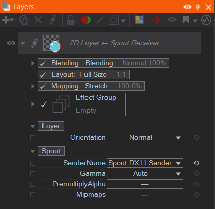

  1. If you just want to receive Spout and display it on the whole canvas, you can simply create a new 2d Layer Spout Receiver in the Layer Editor. If your Spout Sender is set up the right way you should instantly see the frames received via Spout.
Make sure you set the SenderName Property on the 2d Layer Spout Receiver

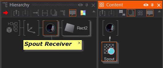

  1. Since the Spout Receiver Node is a Content Node that provides a texture, it can not only be used as a Layer but also be used as a Material Stage inside a 3D World.
