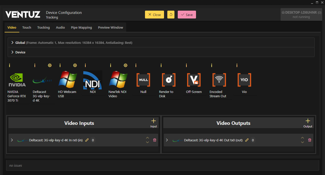

In order to configure the video device and tracking source configure the Video Input and Output in the Video section as shown and add the Tracking device in the Tracking section. For tracking you will normally need one Tracking and one Video source. Both must be placed in the Inputs pane of the Tracking or Video section and normally one Video Output device, which must be placed in the Video Outputs pane.

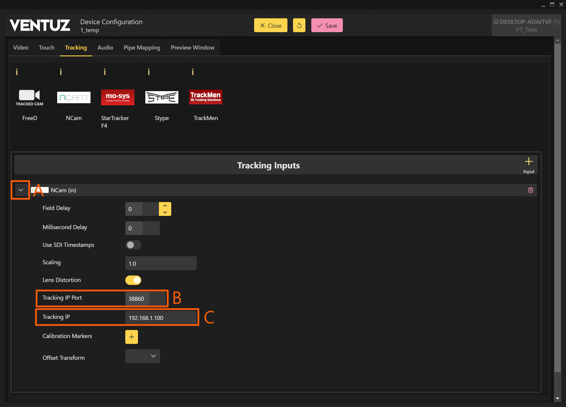

In order to set up the tracking data communication expand the settings of the Tracking device. (A in figure above).
Depending on the Tracking device different parameters will be shown
For tracking systems using Ethernet infrastructure two parameters will be available, currently the supported tracking systems that use IP Communication for the tracking data are Trackmen, NCam, Stype and FreeD:
  • Tracking IP Port: Use this text field (B in figure above) to set up the local Port used to receive the UDP tracking data stream.
  • Tracking IP: Use this text field (C in figure above) to set up the IP address of the machine network adapter used to receive the UDP tracking data stream. Follow the standard IP address formatting as appears in the example. Attention: For Trackmen, Stype and FreeD it is the IP of the local network adapter of your machine used to receive the tracking data as this is UDP. For NCam the IP of the machine that sends the tracking data is needed, as this is TCP.

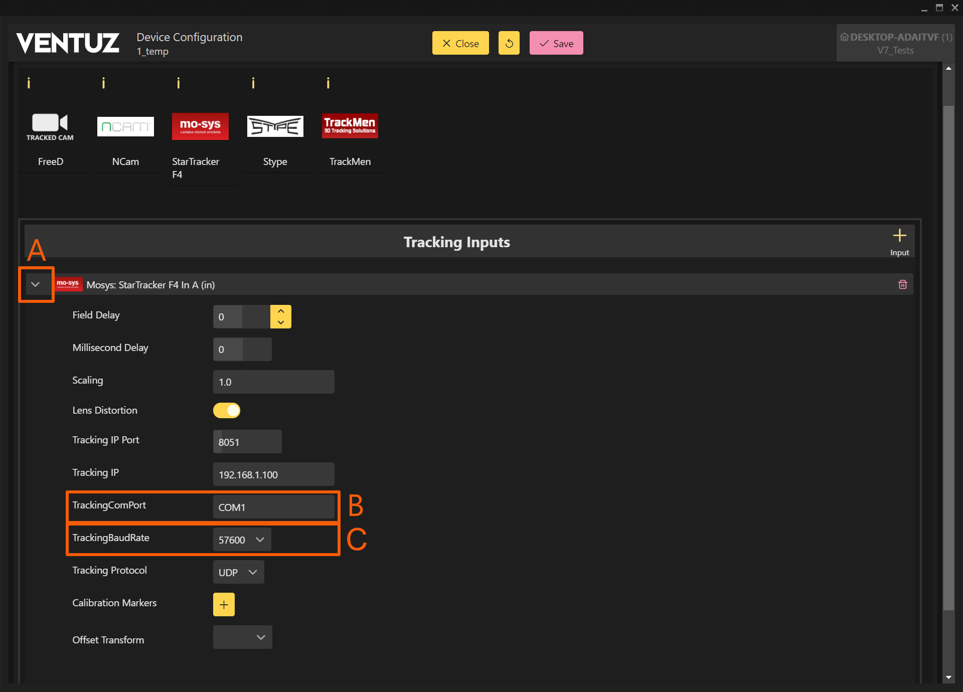

Mo-Sys - Serial interface
For tracking systems using Serial Communications infrastructure two parameters will be available, currently the only supported tracking system that uses Serial Communication for the tracking data is Mo-Sys StarTracker:
  • Comm Port: Use this text field to set up the local Comm Port used to receive the tracking data stream. Please, bear in mind that you must follow the same formatting that appears in the example - i.e. "COM1".
  • Baud rate: Use this drop down menu to set up the Baud rate of the Serial Port used to receive the tracking data stream. Currently Mo-Sys only supports the two Baud Rate options in the list, 57600 and 38400.
  • Since Mo-Sys supports both Serial as well as Ethernet interfaces with the Tracking Protocol you can adjust which one to use.

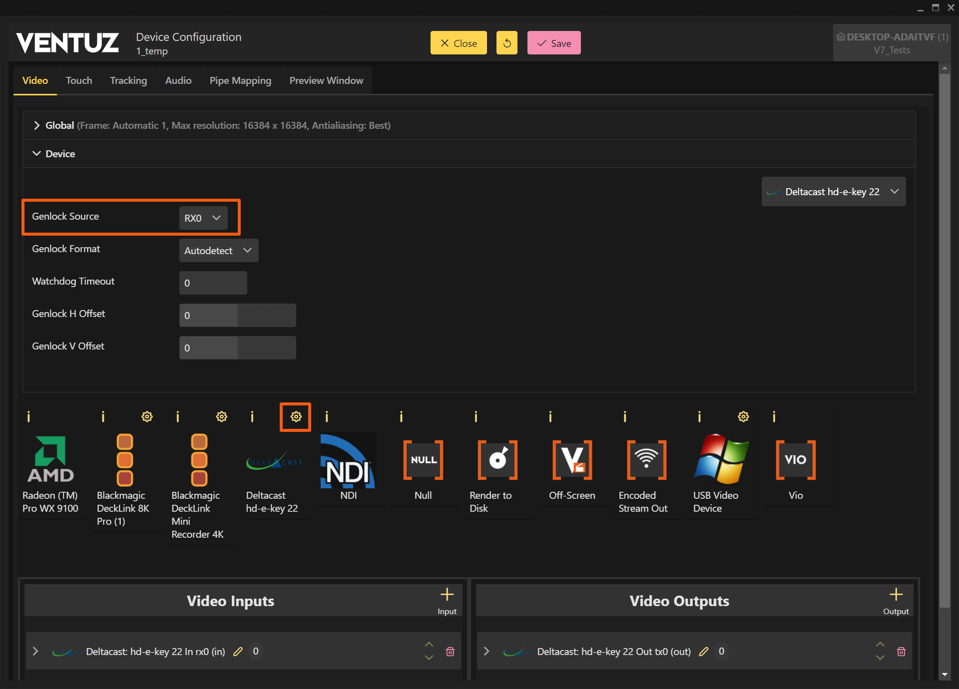

Genlock Source settings for Deltacast board

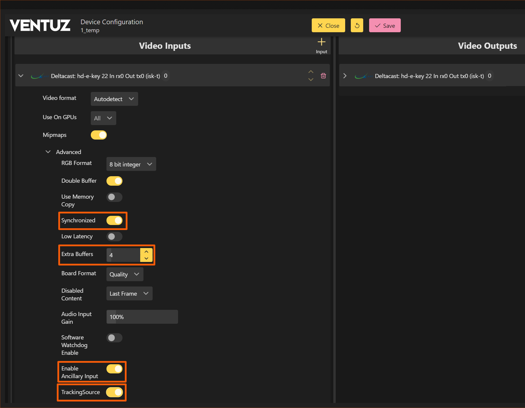

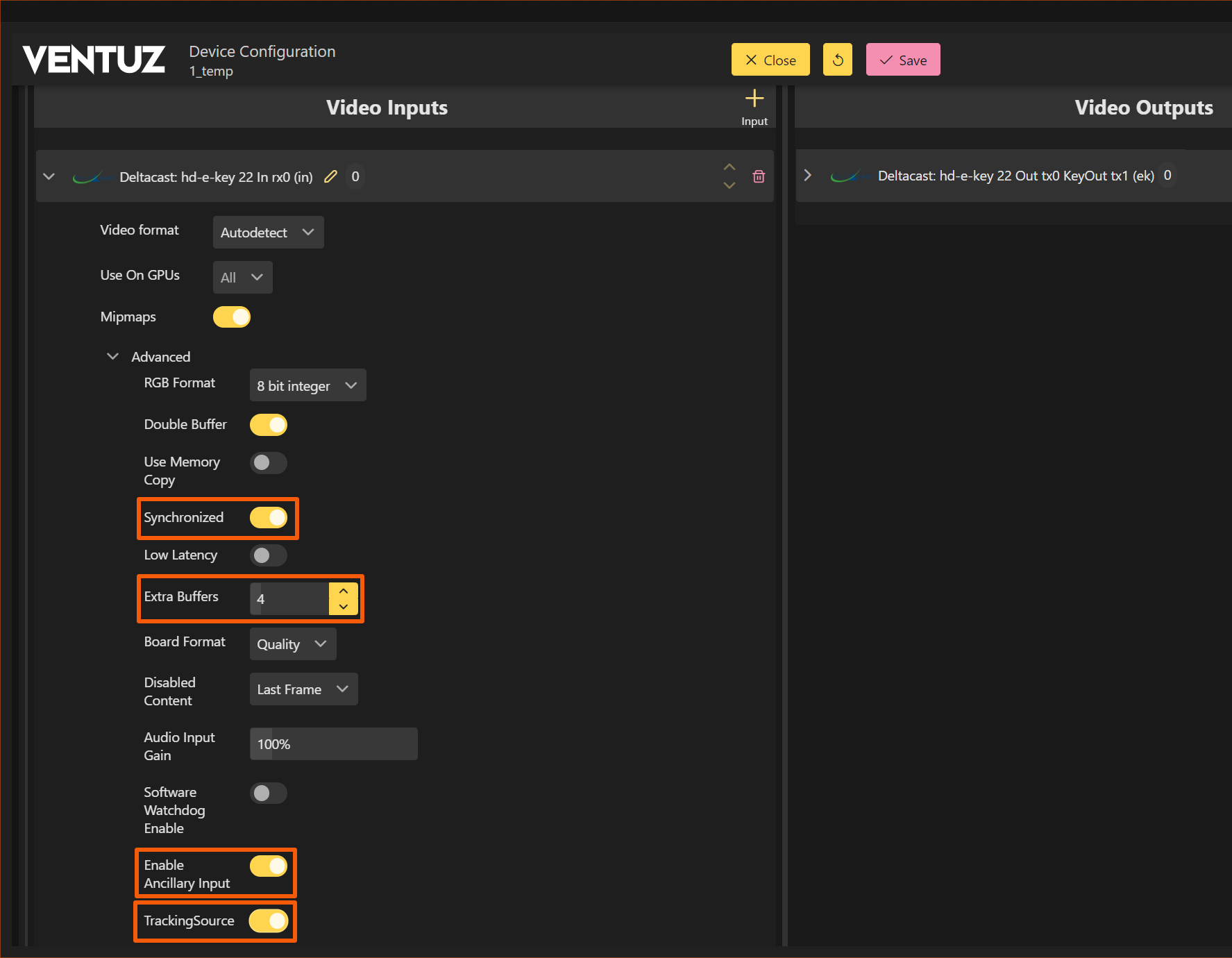

Deltacast Video input for Timecode operation with extra video input buffers:
  • Check the Deltacast settings in Ventuz from the attached screenshots.
  • Set the Enable Ancillary Input to enable the reading of timecode from the video stream (see above).
  • Set Tracking Source. This will cause the tracking data to be aligned to this input
  • Set Synchronized.
  • Create a cube in Ventuz Designer and position a corner at the origin
  • Pan the real camera left and right to check the timing.
  • Check the accuracy of the timing on the output of Ventuz – normally graphics shouldn't be locked to the video, but will be behind. This is because, by default, there is no video buffering in Ventuz and the tracking data packets arrive after the video. In this case, Ventuz just assigns the tracking data to the nearest video frame, so the graphics appear to move after the video.
  • Increment the Extra Buffers parameter to a value of 2 or 4 to create video ring buffers – these buffers can be used to delay the incoming video. By using the Ventuz Live Options, there is no need to restart the software when adjusting values. If you need to increase the value of Extra Buffers in Ventuz Configuration Editor, then a restart will be required. This delay works in the opposite direction as the Field Delay in the tracking system.
  • Once Ventuz has the appropriate video frame stored in its input buffer, it will correctly assign the right tracking data to the appropriate frame and the virtual graphics will snap into sync with the video.

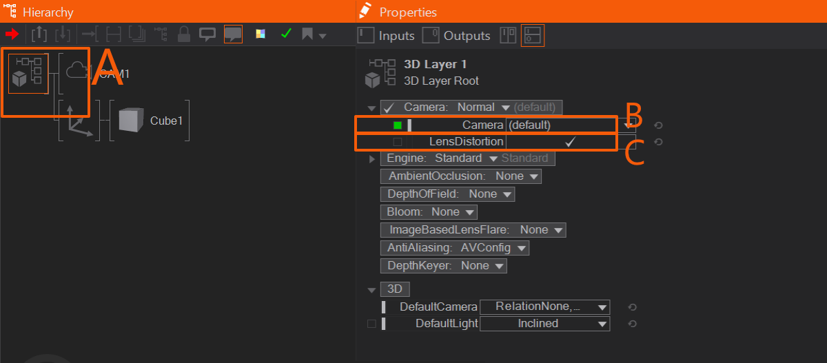

Once you have set up the tracking data sources and the correct synchronization (see above), now you are ready to use the external Camera Tracking and Lens Distortion data to drive the virtual camera into your Ventuz scene.
In order to do so, just create a 3D Layer in Ventuz Layer Editor. As you can see in figure above, if you get into the 3D scene Properties, by clicking on the 3D Scene Root (A in figure), the contextual Properties will appear in the Properties Editor to the right.
If you expose the 3D Camera Properties, you will get two fields, first one being a Camera dropdown menu (B in figure above) that displays the camera being used - the (default) camera is the start option, and Ventuz will always map this Camera to the Tracking Device. If you have only one Tracking device configured, this mapping will be correct and the (default) camera can be used. You can change this setting to another, non-tracked Ventuz camera, that your camera is not tracked anymore. When multiple tracking devices are configured, it might happen that the (default) Camera is not mapped to the first tracking device. To have full control, it is recommended to assigne the cameras manually to a Tracking Ordinal to have full control.
The other control available, Lens Distortion (C in figure above), is just a checkbox that controls if Lens Distortion data is applied or not.

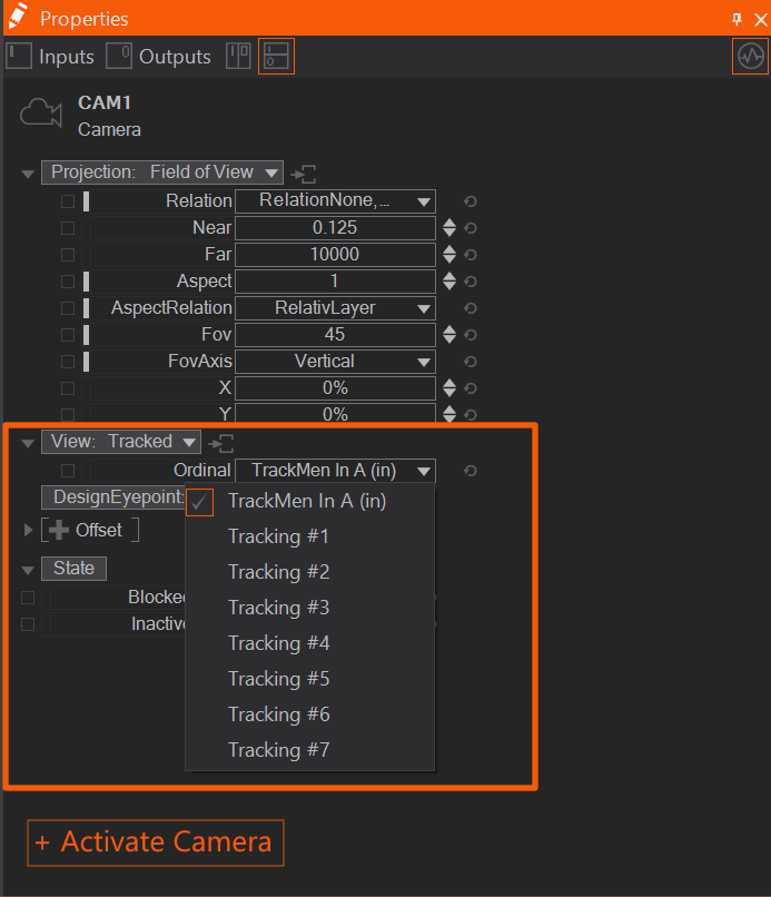

A different way of using the incoming tracking data stream is to create a Camera, change the View property to Tracked and assign the correct tracking data stream. Dont forget to Activate your camera, or change the Camera property (B in figure above) to your desired camera. This is necessary, if you use multiple camera tracking inputs.
If you have a Tracking Device configured it is always mapped to the (default) Camera of each 3D Layer. In order to not use the tracking data on a layer you need to create an extra Camera and activate it, to not use the (default) Camera.

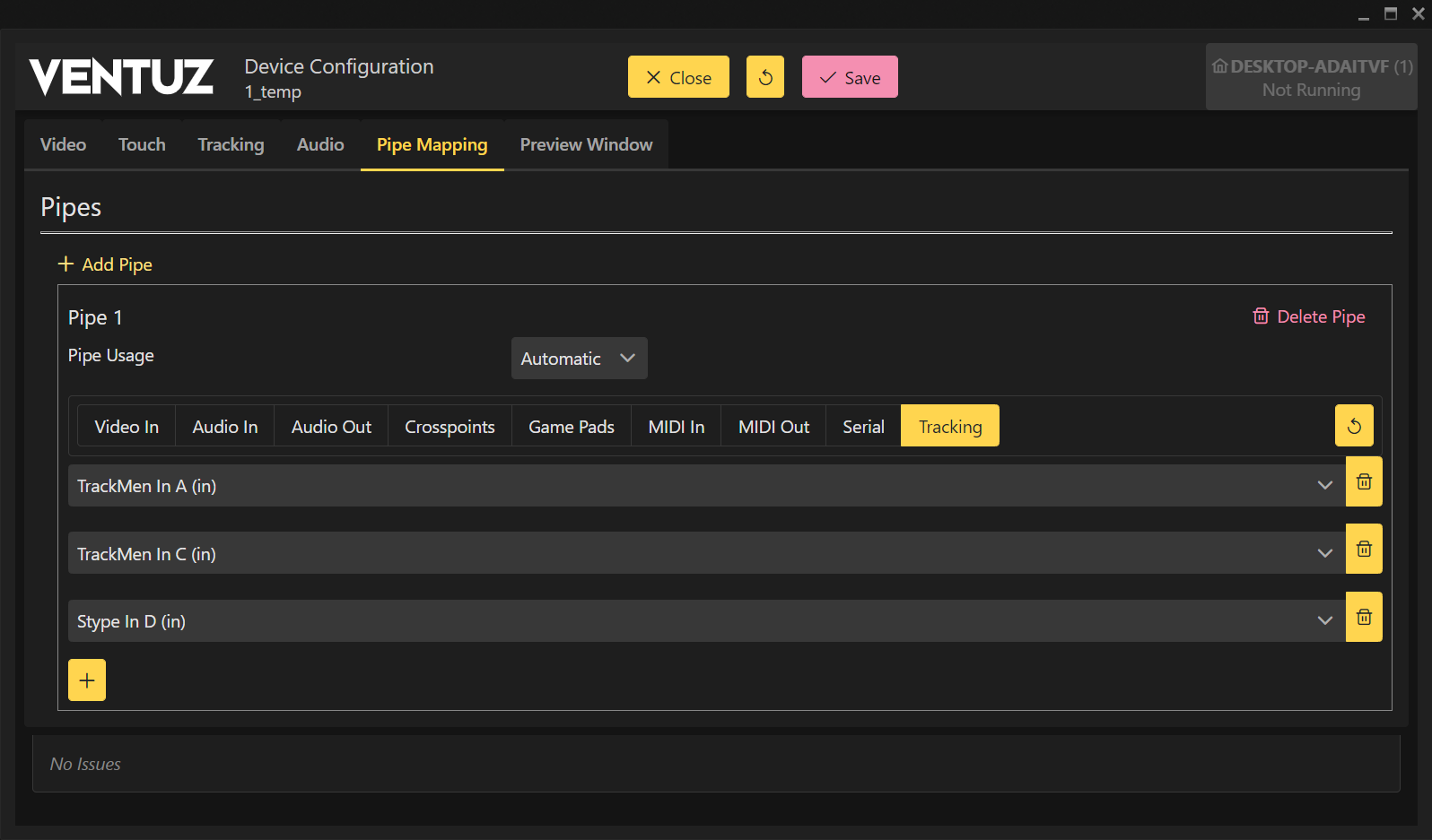

With Ventuz 7 onwoards, Ventuz supports multiple camera tracking devices simultaneously. To add another device, simply add an input in the Tracking section of the Config Editor. The tracking devices are mapped internally on the Ventuz Ordinals. This order is not the same as the order of configuration in the Tracking config.
By changing the Tracking device in the dropdown menu, a different device can be mapped to Ordinal #0. The Ordinals are top to down incrementing from 0 (0, 1, 2,...). For more information see the Pipe Mapping section in the Device Configuration.
In Ventuz Designer the tracking devices only need to be assigned to the Cameras. These can be done as shown above by selecting the View as tracked and the Ordinal of the tracking device. The cameras in the Compositions can be controlled independently by their tracking devices. With playing out to different outputs, one machine is capable of rendering multiple streams controlled by their own tracking data.

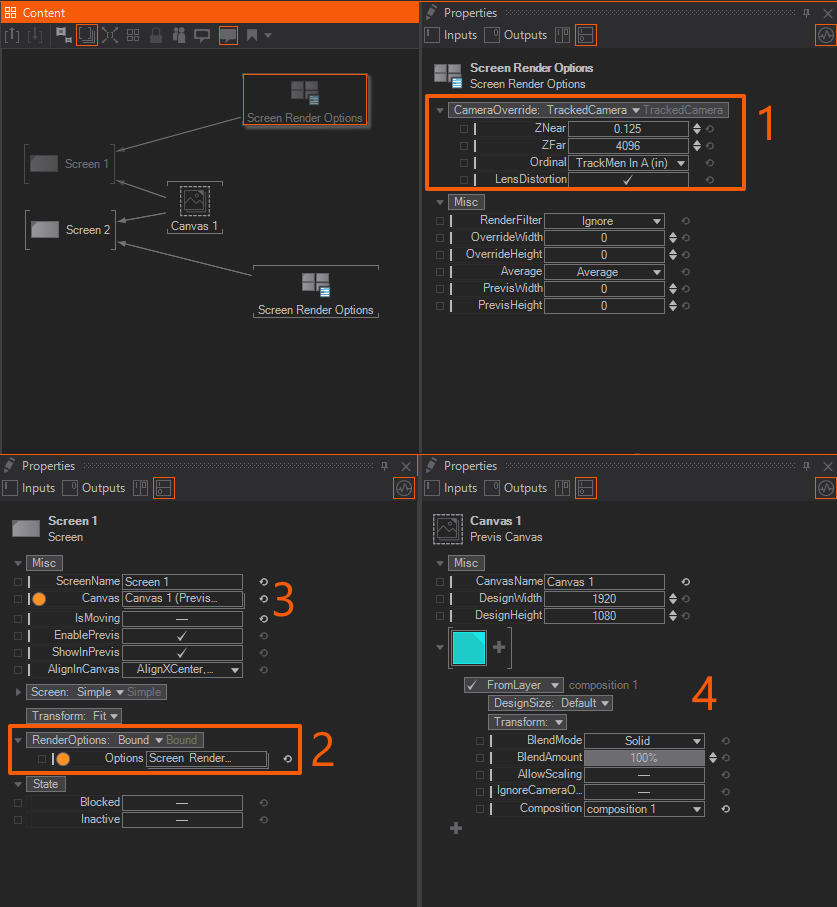

To render the same scene with different camera positions it is best to use the Screen Render Options Node together with a basic Previsualization Scene. With the Screen Render Options node Ventuz can perform a camera override to the Screen node. The existing camera will be overwritten with the camera data from the tracking device. This can be done for each Screen independently, while they are bound to the same Previs Canvas and Composition. The Composition Layer is independent of the multi rendering.
Every Screen node needs an own Screen Render Options Node, which is set to Camera Override:TrackedCamera and the desired tracking ordinal. (see no. 1) The Screen node is set to bound Render Options with the Screen Render Options node bound to the property. (see no. 2) For each Screen independently. The Screen will render now the Previs Canvas with the camera override. In order to have the right Composition(s) connected, a Previs Canvas node needs to be connected. (no. 3) In this example the canvas only consist of one Composition Layer. (no. 4)
To use this Previs Scene, import it to your Render Setup and activate it. Now, only the output mapping needs to be done.
With this simple Previs Scene, one Composition can be rendered multiple times from different camera positions. This also can be used for rendering multiple times with non-tracked cameras.
