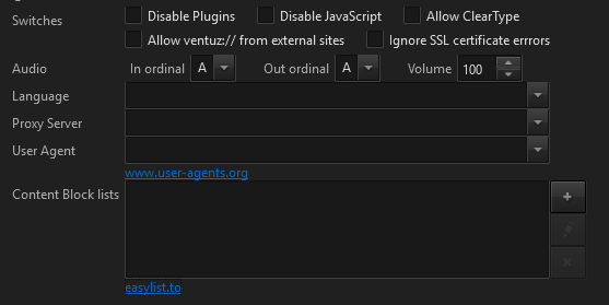

WebBrowser Settings(Ad Blocker, Audio etc.)
The Web Browser Node has some internal settings to adjust its compatibility with certain web sites and networking behavior inside the Ventuz Machine Configuration.
Disable PluginPlugins (like Adobe Flash) are disabled.
Disable Java ScriptExecution of Java Script code is disabled.
Disable SecurityDisables all security checks inside the Web Browser. Use with Caution!
Allow ClearTypeDisables/enables ​Clear Type. Monochrome scaled text with Clear Type enabled result in colorful edges.
Allow ventuz:// from external sitesAllows you to reference assets inside a Ventuz Project
Ignore SSL certification errorsExecution of Java Script code is disabled.
AudioAllows you to configure the In and Out Ventuz Ordinals and global browser Volume. Also check the crosspoint section in the Audio Video Config for further information.
LanguageThe Language of the browser. Some web sites may recognize this language and display content in that culture. If left blank, the system language (culture) is used.
Proxy ServerIf no direct internet access is available proxy servers for all protocols can be configured here.
User AgentSome web sites (like Facebook.com) expect special keys in the user-agent string. The user agent string can be manually adjusted here. See ​http://www.user-agents.org/index.shtml
Content Block List Downloads a filter lists that automatically remove unwanted content from the internet, including annoying adverts and bothersome banners
