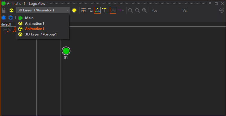

Animation Node vs Main Animation
By default, the scene has a Main Animation that can be accessed in the Animation Editor from anywhere in the scene. But in contrast to most 3D applications, Ventuz does not have to associate animations with the scene directly. Instead, the curves, keyframes and logic information of an animation also can all belong to a Keyframe Animation Node. A scene can therefore have any number of independent animations each with its own set of animated properties, timeline and keyframes. The information of an animation can be edited in the Animation Editor by changing the edited Animation with the dropdown menu. For more information on animations in general, see Animation and State Engine.
