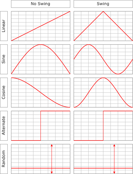

Function and Range
Function defines the mathematical function used by the Mover to calculate the values in one period. The duration of a single period is defined by the Duration property. The Sine and Cosine functions result in smooth ease-in and ease-out animations. The Linear function produces constant animations, whereas the Alternator mode switches between Min and Max values. The Random function produces random values within the specified range - one new value in each period. Infinite will run indefinitely from 0 on in a linear manner. Each period the result will increase by the given range.
Keep in mind that the Infinite function will produce results in regards to the Cluster Clock if it is used in Absolute mode. Because of the floating point number precision this will eventually result in inaccurate results on systems that are running in long term .
Enabling Swing will produce a continuous and smooth curve. With the functions Alternate, Random and Infinite the Swing property has no effect.
