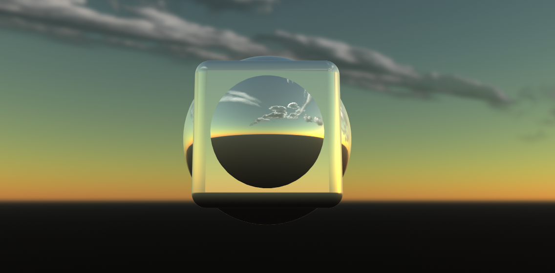

Sky Box Simulates an environment and is able to light the scene using an image.
Image-based lighting is a fantastic technique for utilizing High Dynamic Range images to create realistic and complex lighting. Apart from enabling image based lighting and reflections, the Sky Box Node also allows you to render a cubic environment.

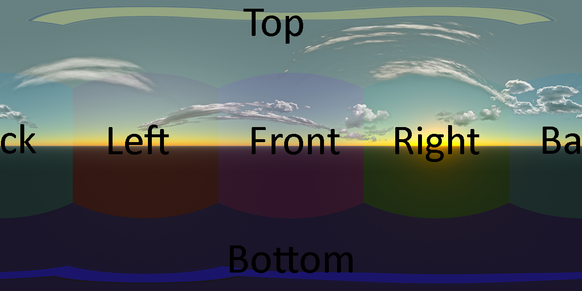

The Longitude-Latitude Cubemap saves the information of your environment based on polar coordinates. This results in a map that has a lot of information on the top and bottom of the mapped sphere and the least information on the equatorial line.

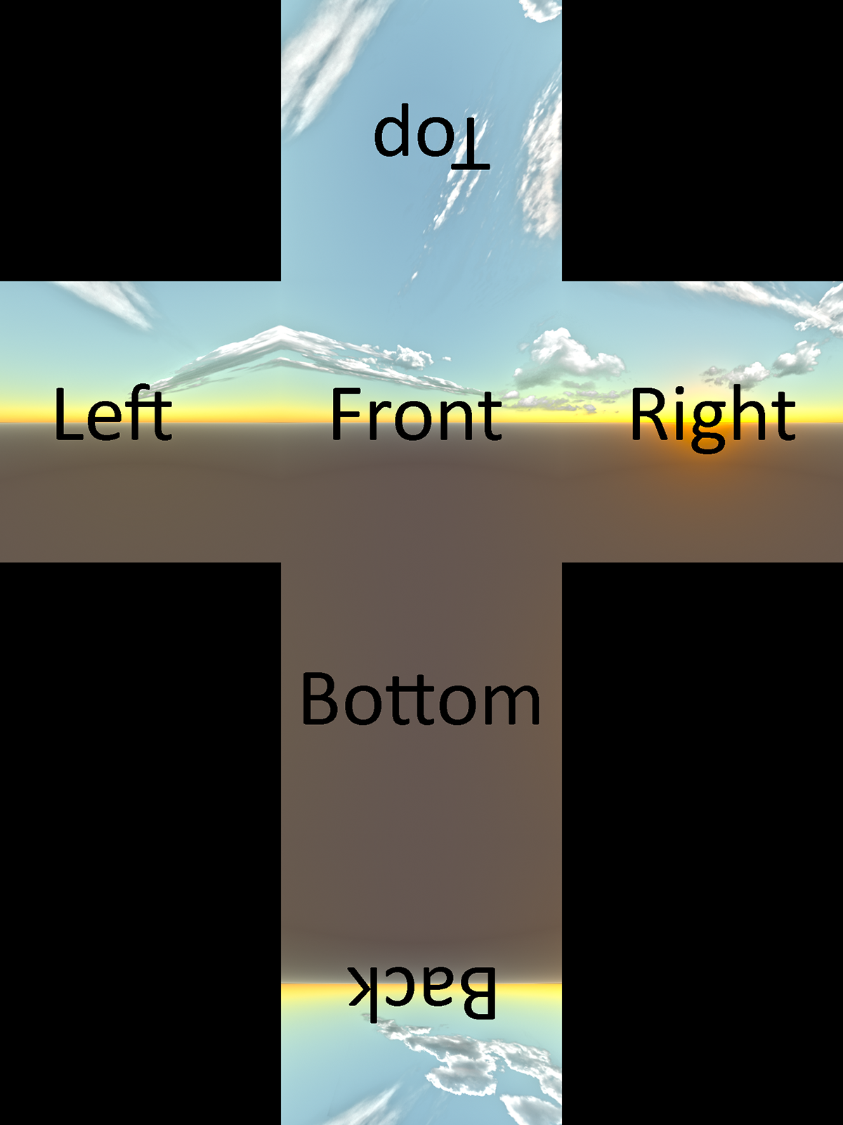

Horizontal and Vertical Crosses save the information of your environment based on an unfolded cube. This layout is the most common because it is very easy to create manually due to its seamlessness. The Vertical Cross layout is used by ATI tools.

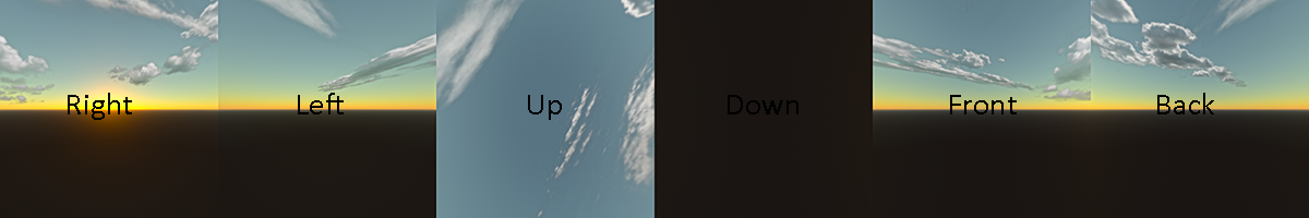

Horizontal Strips save the information of your environment into a simple strip. This layout's sections have seams and therefore do not influence each other in MipMap calculation which may lead to noticeable artifacts. Horizontal Crosses are created by nVidia tools, like the nVidia DDS Exporter Plugin for Photoshop.
