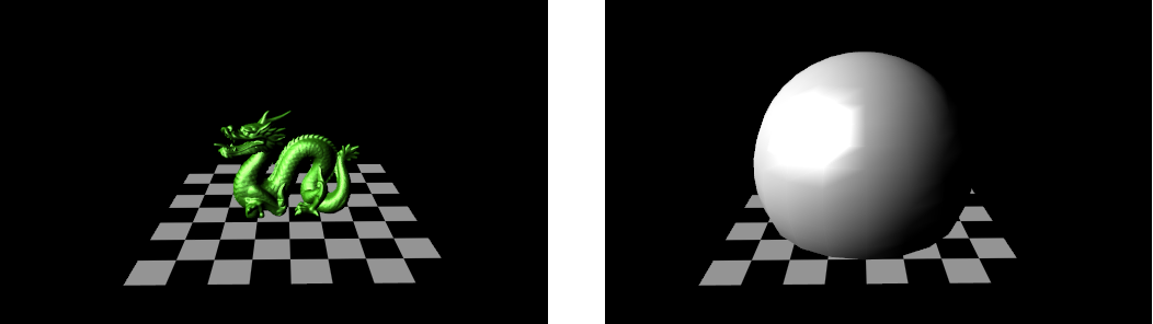

In the following example, we have a dragon model sitting on a plane that we want to be rotatable. Since the dragon is a bit small and has too many concave areas, we're going to put a sphere around it as a touch proxy.

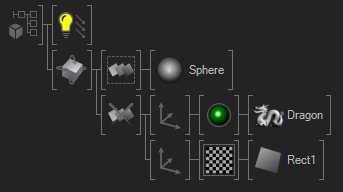

The hierarchy is quite simple: between the Orbit Rotation node and the sphere, a Touch Proxy is added. This will automatically make it invisible. Beneath the Touch Proxy is a Touch Excluder that prevents hit testing to spent any time on the actual rendering geometry. It also has the effect that the plane will actually not be reacting to touches. To temporarily unhide the proxy, activate the Visible flag on the Touch Proxy node.
