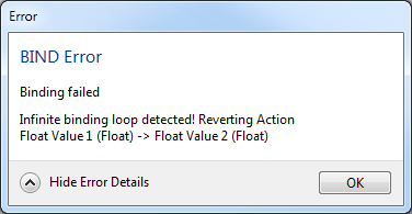

Chances are that a typical user will never need to employ this node. Either he will never run into this problem in the first place or be able to solve it by a redesign of his binding hierarchy. As long as the following error message does not pop up, simply ignore and avoid this node!
