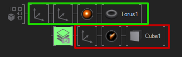

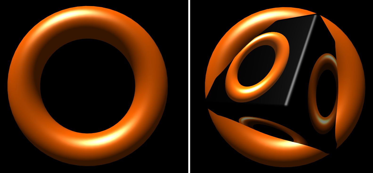

This image illustrates which parts of the hierarchy will be visible on the resulting texture (green frame). It is important to note that the subtree (red frame) of the Snapshot Framebuffer node is not visible on the texture, because the node simply copies the already existing rendering onto a new space on the GPU memory, instead of changing the current render target to that space while rendering the subtree. Below you can see the resulting texture of the above Snapshot Framebuffer node and what the resulting rendering will look like.
