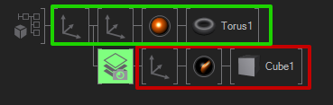

Note that the Snapshot Framebuffer node will not render its Subtree to a render target. Practically you get the rendering of the Hierarchy Tree up until the node.

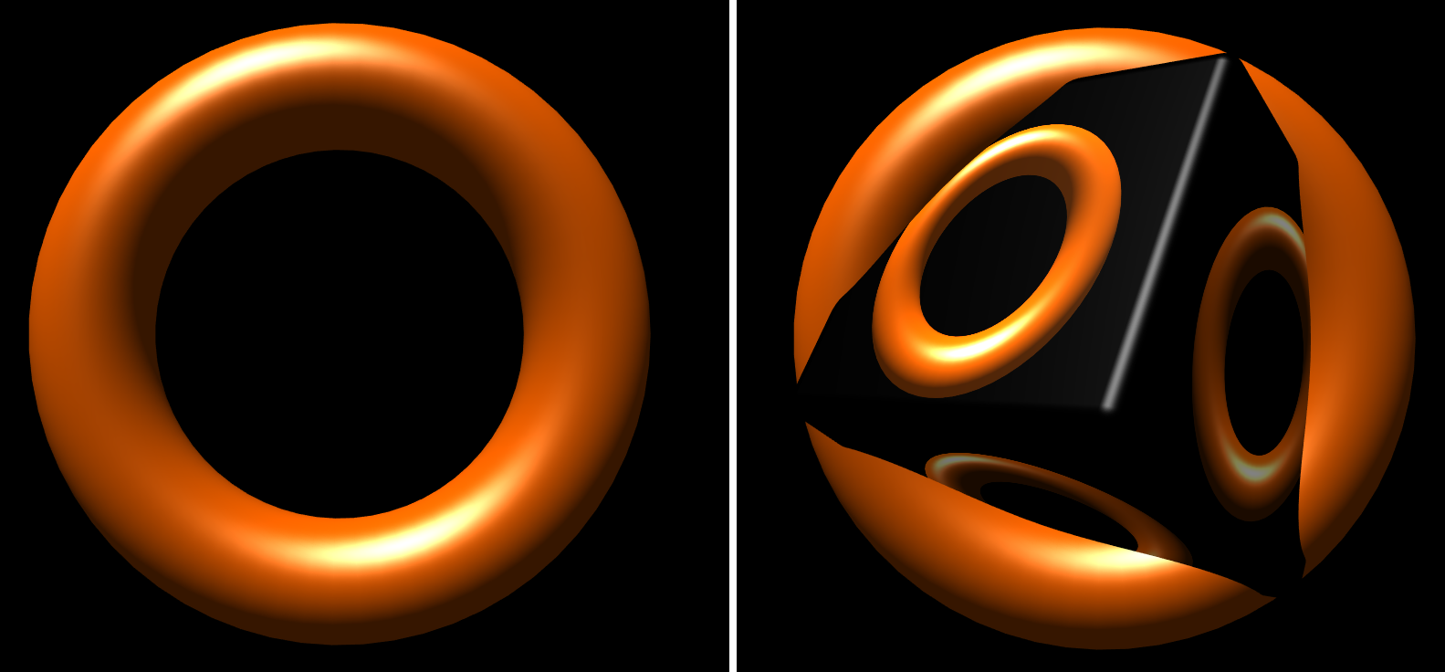

This image illustrates which parts of the hierarchy will be visible on the resulting texture (green frame). It is important to note that the subtree (red frame) of the Snapshot Framebuffer node is not visible on the texture, because the node simply copies the already existing rendering onto a new space on the GPU memory, instead of changing the current render target to that space while rendering the subtree. Below you can see the resulting texture of the above Snapshot Framebuffer node and what the resulting rendering will look like.
As opposed to the Offscreen Render Target Layer the Snapshot Framebuffer node enables you to grab the color buffer of a Layer without having to use it inside another Layer. This way you can grab the current rendering without having to drop any of the buffers - e.g. the geometry using the generated texture can depth test against the original rendering which can be very useful in applications like creating a Refraction.
